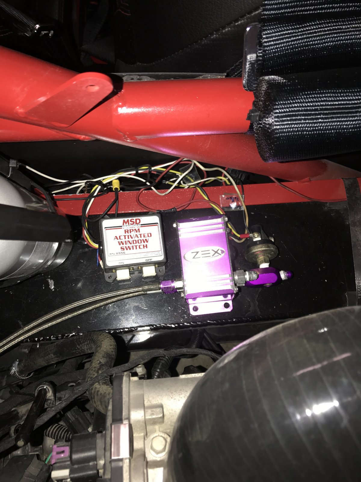

55 for now. I'm being pretty cautious with three layers of safety. Have a window switch wired into a WOT with both connected to a fuel pressure cut off switch.
So it will spray automatically when fuel pressure is above 50psi, TPS is at 100%, and engine RPMs are above 3,000. Then automatically turns off at 5,100.
Also have the AEM wideband o2 with logging.

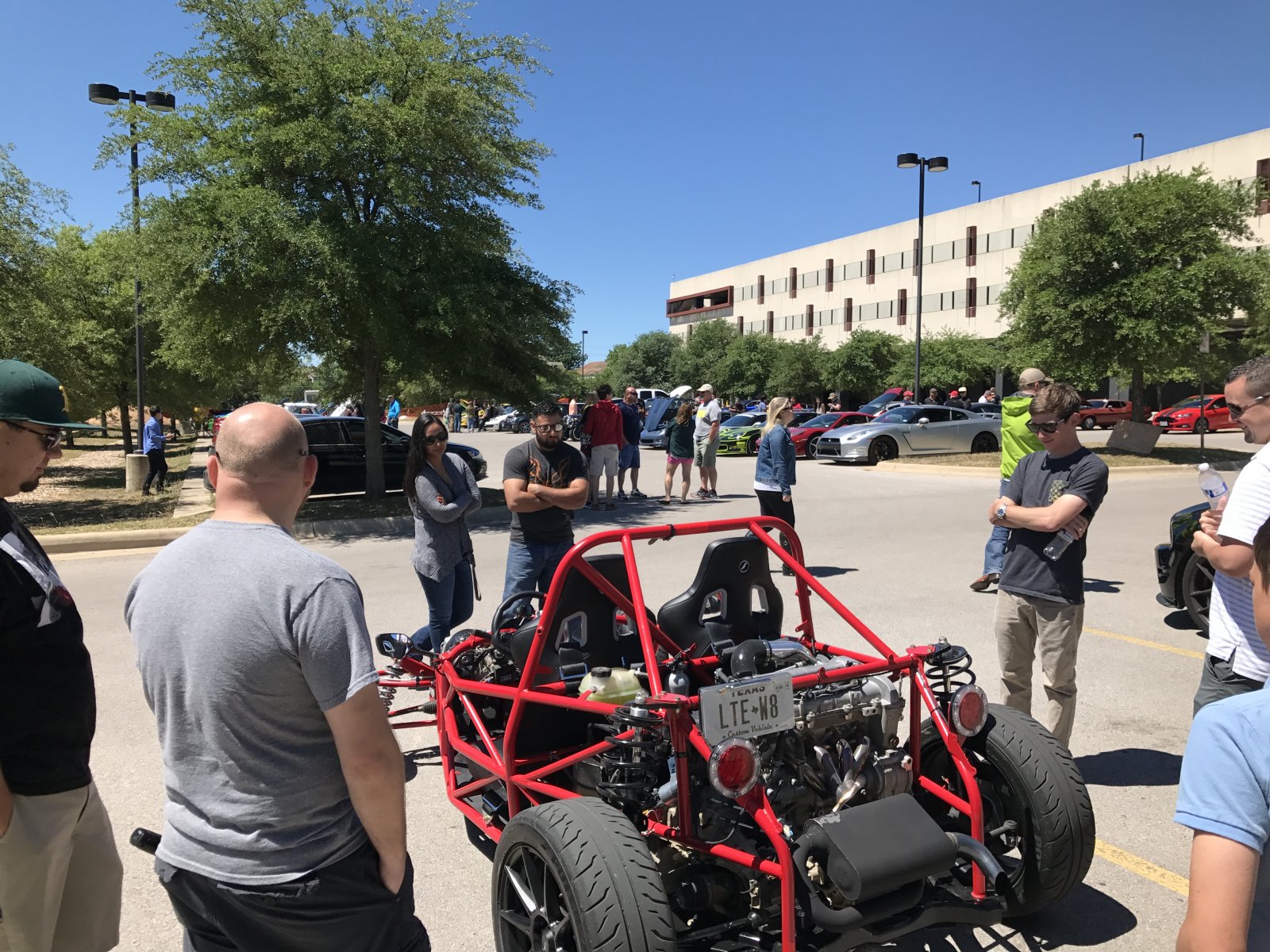

Had a ton of fun today in the Goblin. It was an absolutely gorgeous day today after last nights storms. Went out to the F1 track for a Sochi F1 race watch party. They had an AutoX course set up for anyone who wanted to burn a little rubber after watching the race. So of course I had to try.
I have never been on an AutoX course before so naturally my runs were exceedingly slow. I was told to leave it in first until I got used to it so thats why my rpms are so high.....But anyway I had a blast.
Then after that there was a small car show right by my house so I swung in on my way home. Everyone swarmed me before I could even get out of the car. Definitely going to need those business cards!

Can anyone with a manual confirm the throttle body wiring? Need a voltage input wire for my WOT switch.
edit: Purple wire on throttle body. Approx 1.5V at idle, 4.2V at full throttle.

Nitrous update: Have solenoids, WOT switch, and fuel pressure cutoff switch all wired and working correctly. However I have been totally unsuccessful in picking up a tach signal for my MSD window switch (PN 8956). MSD wants you to buy some $100 tach signal adapter for this car, but I'm just too cheap to believe that's necessary.
Cobalt forums reference the purple wire on coil #1, no luck with that one.
The crank trigger wires coming out of the front of the engine are yellow, green and purple. I don't know if your system will see the pulses that it generates though. They are located near the starter, close to the bell housing.
JSATX
Well the problem is the box is designed to be triggered by a coil, it has settings for 4,6, and 8 cylinders. A crank trigger would probably make it think the Rpms were double if not 4x
