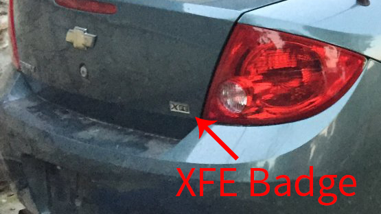

I'm sorry I'm not sure.
Your donor was an XFE trim so I'm pretty sure you have the 3.63.

Thats a good update! How do you like your gearing? Is your trans the eco 3.63 ratio or the standard 3.84?

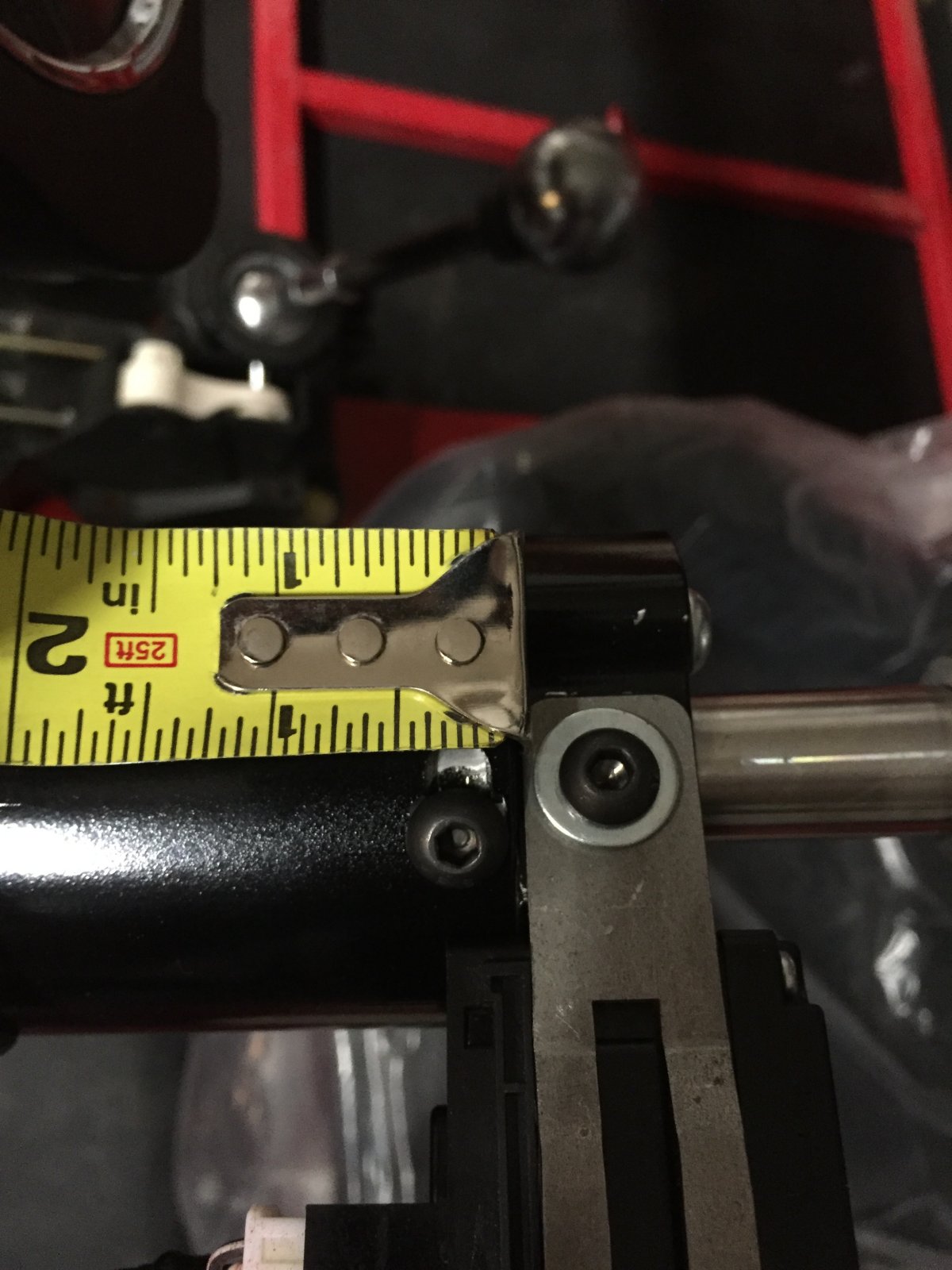

Any problem with shortening the steering column tube? Because I can't not mess with stuff, I've added an adapter and a QD to my wheel which pushes it just a little too far forward. I've studied it for a while and seems really straight forward. I'd just like to shorten the tube by 1" and redrill the three holes. But wanted to ask first in case I'm not seeing a potential problem.
Justin - how did this work with the adapter and the QD coupler? Any issues? Which adapter and wheel did you use?

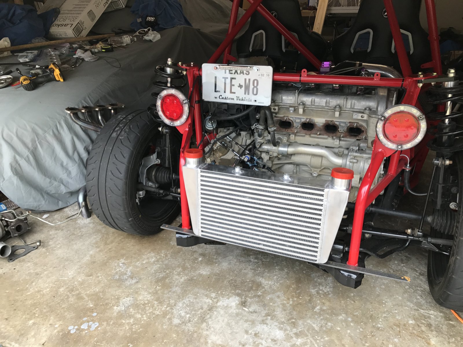

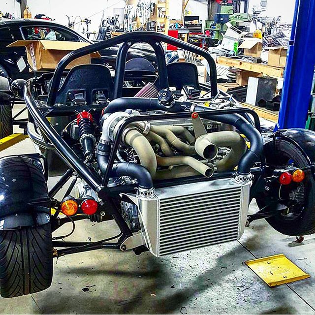

Been thinking a lot about boost lately. Haven't done much because I ran into a lot of turbo fitment problems. But I think I have a good idea how to route stuff now. I will be patterning my setup based on this atom:
Sure it's not the ideal setup with all that exhaust heat there. But since everything is so open it should be fine. I monitor IAT° anyway if they are a problem I'll add heat sheilding and some ducts from the side which should further reduce temps.
I found an intercooler that fits nicely between the rear bars. I plan to flip the ZZP manifold upside down and mount the turbo directly to it. Should hold it above the intercooler and provide a fairly direct shot into the top right Intercooler intake. Now to start mocking up the pipe....

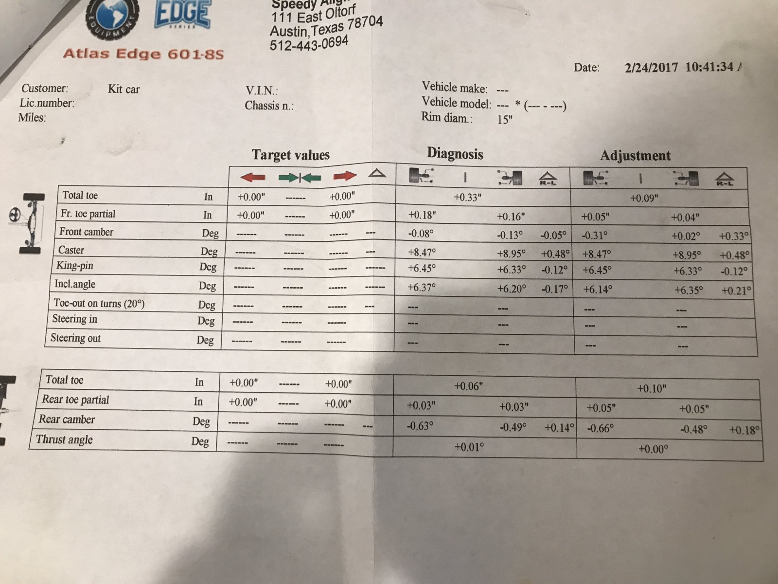

Hey Justin, Can you send me your alignment numbers. Local shops being a PITA.
Thanks!
Nuker-
I don't know if this will help or not.
What's the problem? You want 0" total toe or a tiny bit of toe in...and 0 to -3° camber. Or did Adam say -5° honestly I can't remember.
JSATX
Over 60 it gets squirmy trying to see what the problem is. I'm sure it's alignment.
Nuker
Most likely. Made such a huge difference for me. Also wheel balance plays a big part in such a light car. Thankfully very little weight was required to get mine perfectly in balance, make sure they use a road force balancer too.
