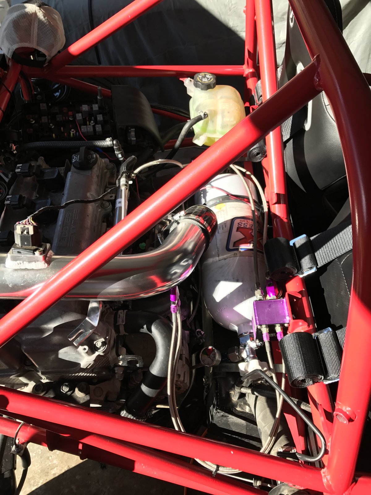

So I've been reading a lot about NOS installations. Apparently it's cool to have a stealth/sleeper setup where bottles and lines are well hidden.
Is there such a thing as a sleeper goblin? Because this isn't it.
It's a ton of fun, I don't really ever see myself exceeding the 55shot.
I've done a few launches while carefully watching the AFR. As soon as I floor it it drops to about 11.5 just with the ecu, no spray. Then when I spray it I've seen it rise to as much as about 13.5 but no higher. Might go one bigger on the fuel jet just to keep it right at 13.
Honestly it is a very nice bump but not quite the traction ruining slam that some people make it out to be. The engine doesn't even sound different, just revs much faster.

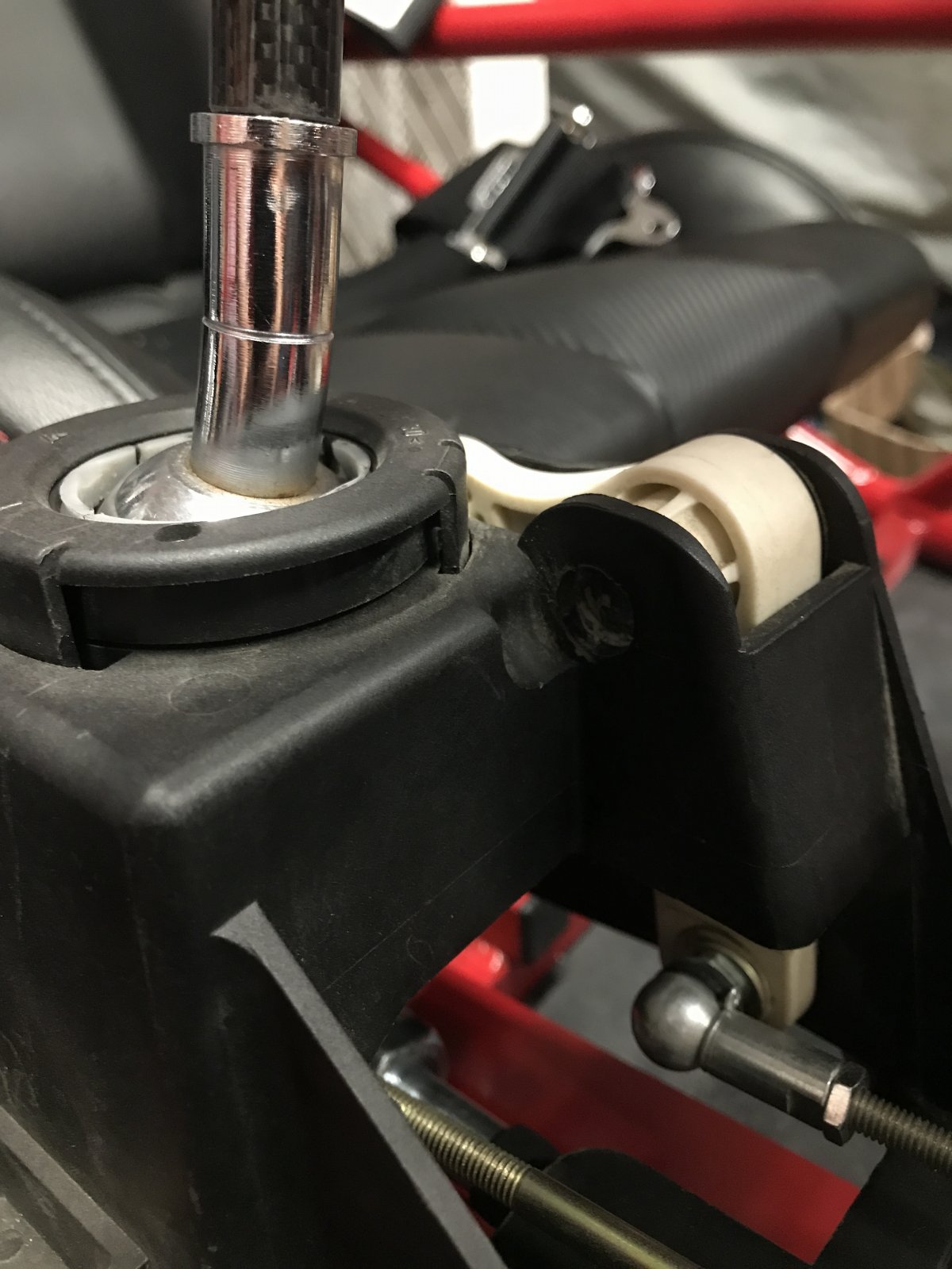

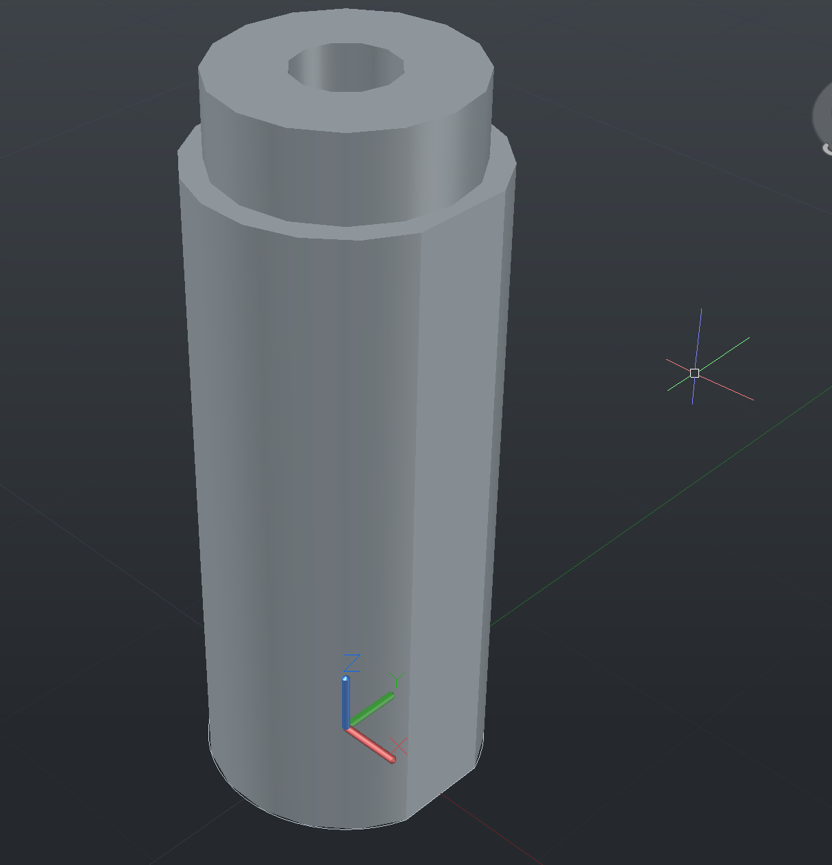

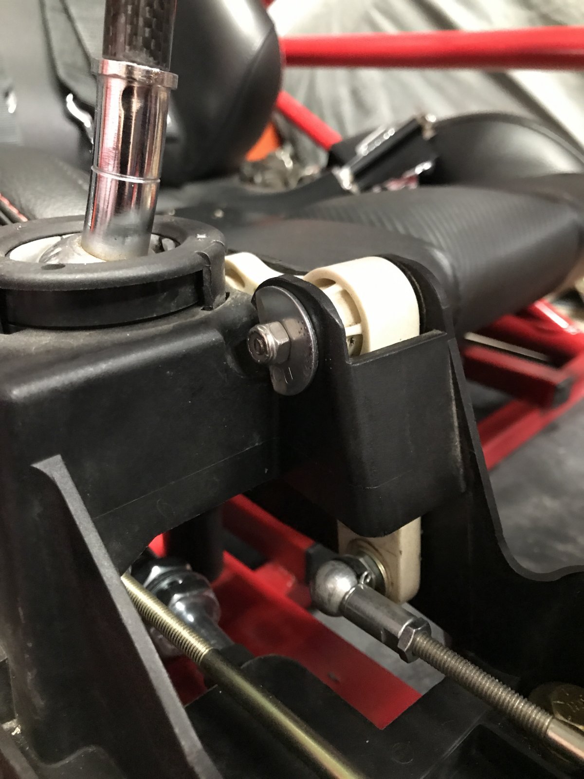

I noticed last week that my shifter had become mushy and not nearly as nice as it was when I first started driving it. I kept thinking it was something binding up in the rear. But it turns out I somehow broke the pin that goes through the horizontal throw lever so it wasn't moving the transmission gear arms like it should. Guess I'll print a replacement this week and that should last longer as I'll probably slide a bolt through the center.
It's hard to tell but the "pin" should stick out of the housing where the white lever is. There's nothing there which allows that white arm to flop around instead of moving the cable.
JSATX
Well I must have been driving this thing with a broken shift pin for awhile, because it feels like a totally different transmission when I shift now! The pin fit absolutely perfectly. I greased it up and then pushed it in with a C-clamp and ran a bolt through the center. All the slack I felt before is gone!

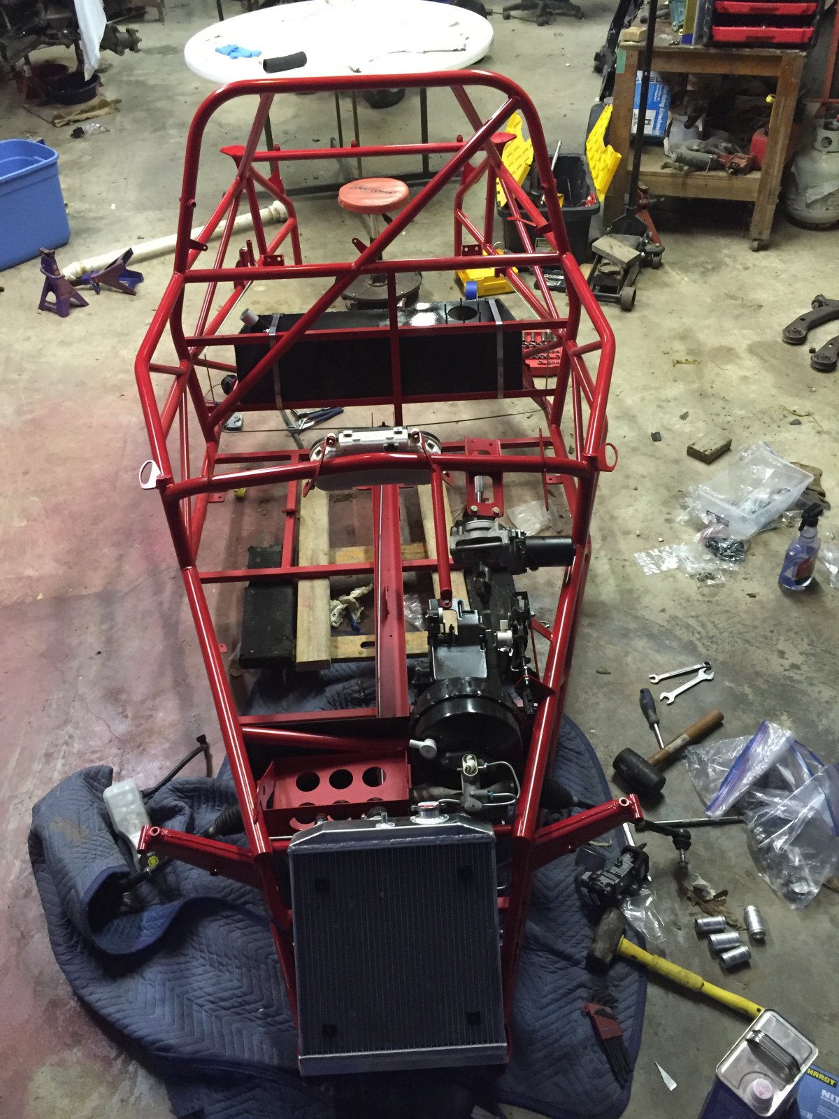

Started by installing the radiator tubes in the frame. It really is a very tight fit. Tried the paint roller method but just couldn't get enough tire wet into the frame, and ended up having the pull rope break off several times. Tried a slightly different method, cut a shop towl into about a 7" square and then folded it around a nut in the middle so I could tie a rope and have a swab type setup. Then completely soaked the rag in tire wet. Blew the rope though the frame and attached it to a drill on the other side. Spun the rope until it was very tight and started spinning the towl swab and slowly pulled it through the frame rails with drill. Hoses went in pretty quickly after that.
Installed brake lines, radiator, brake booster, pedals, clutch MC, instrument gauge, steering rack and motor, and fuel tank/filler neck. Had planned on installing the engine but I took it off the transmission to pressure wash everything and found out my clutch was at the wear limit indicators so unfortunately had to stop early and order parts. View attachment 520

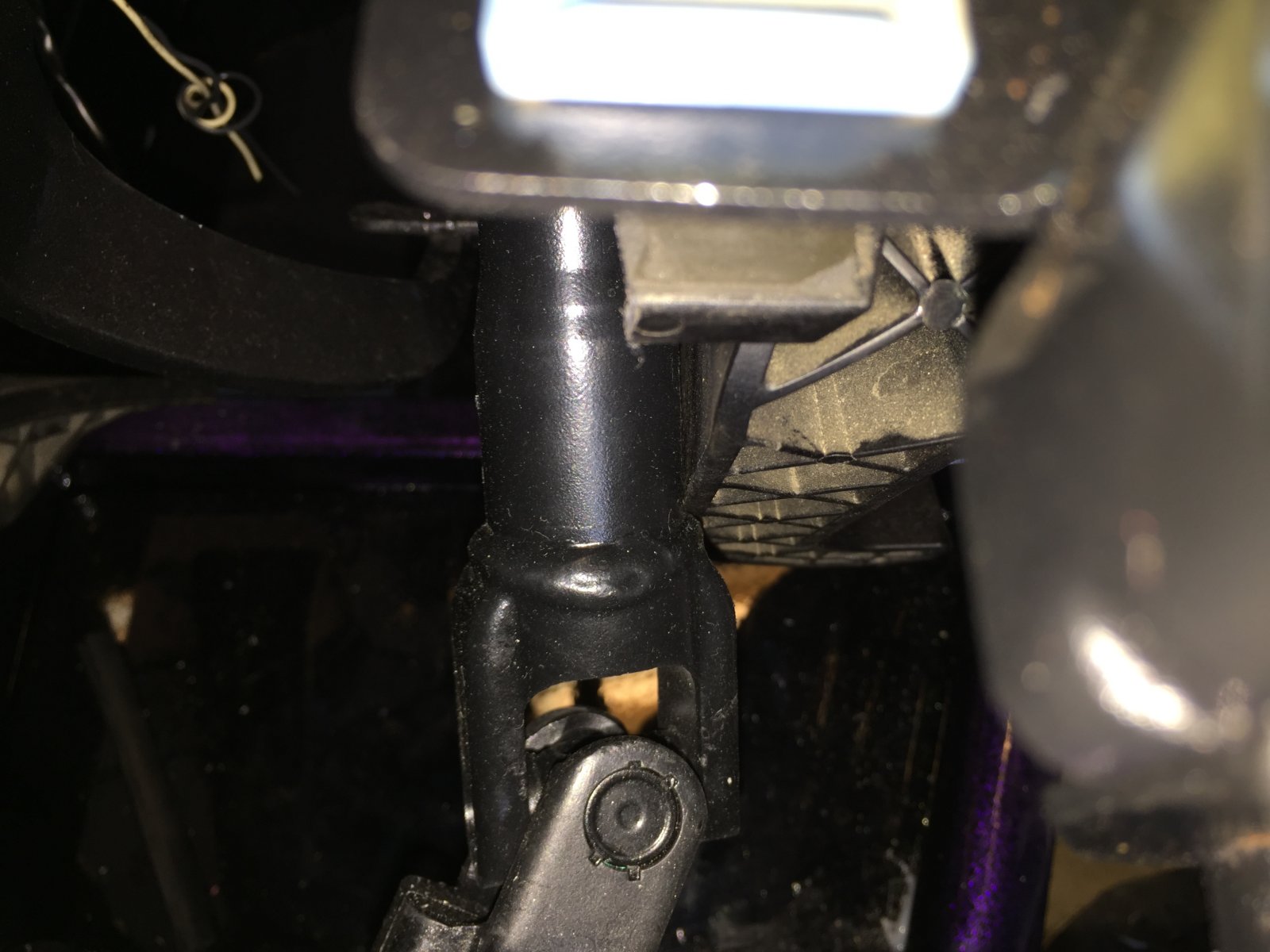

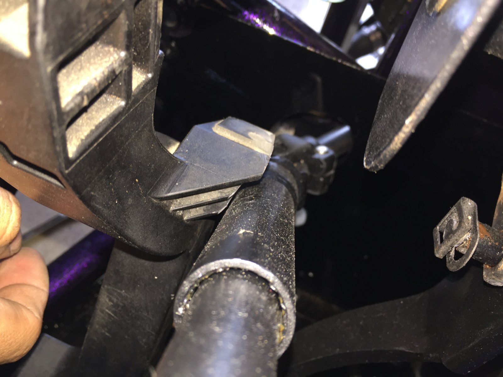

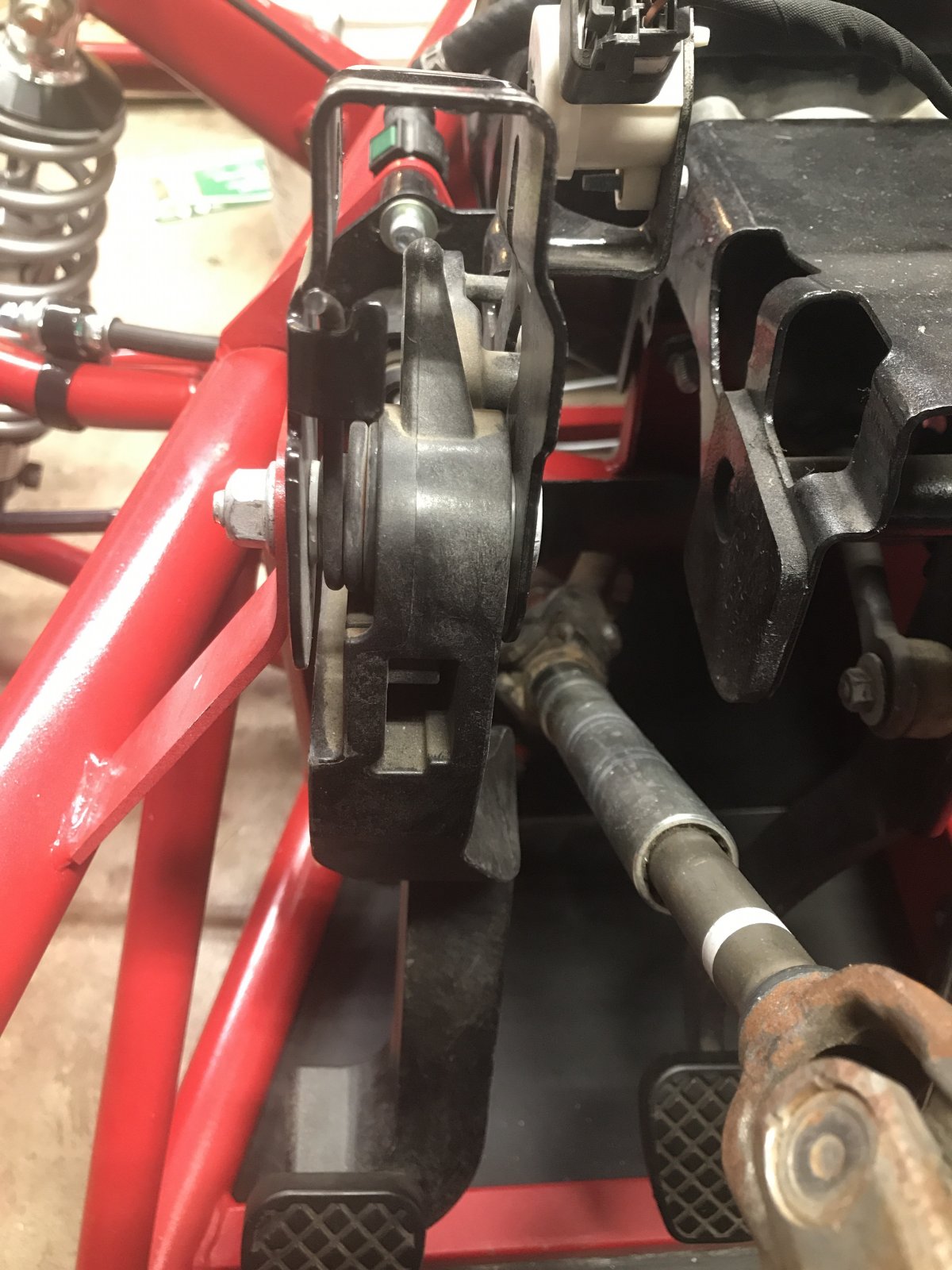

Does your clutch pedal rub on your steering shaft?

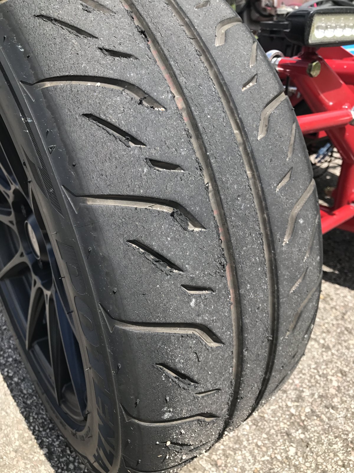

2) not near enough camber in the front wheels, after a few laps it's obvious the outside edge of the front tires is getting chewed to shreds. Now I knew this as I asked for pretty neutral settings for road use/less wear. If you plan to track your car you should absolutely stick to Adams camber specs of approx -3° (if I remember correctly mine are -1°)
