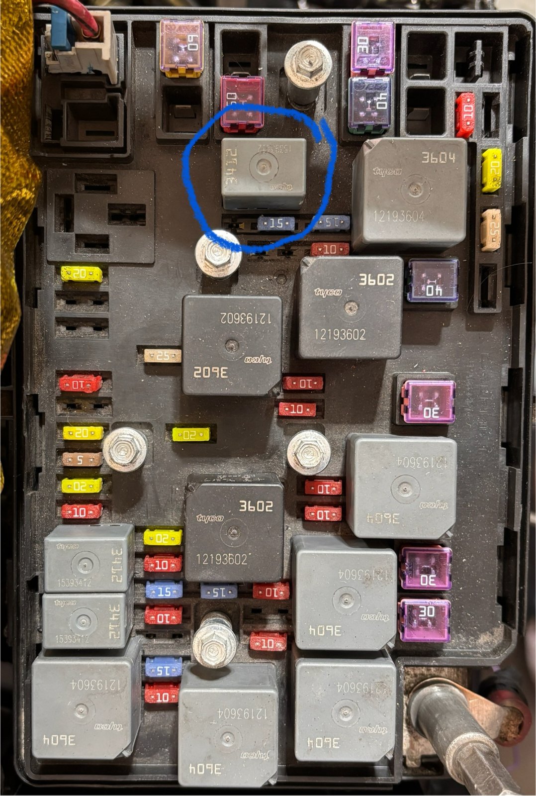

Can anyone confirm that my fuel pump fuse is in the right spot? It can also go in the spot right next to it and the diagram in the cover is a little vague.

L
I can’t thank you all enough.
