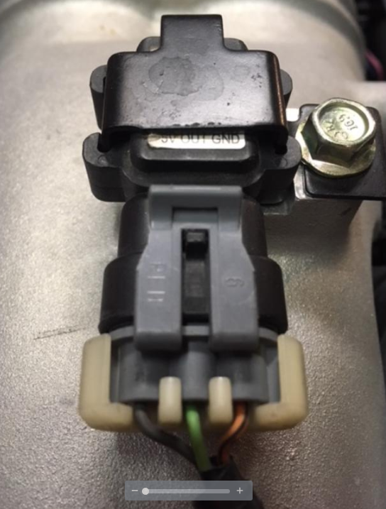

On the SS/SC, there are two MAP sensors. One is ambient (for reference) and the other is in the intake. The problem is both connectors are the exact same. Make sure to have them plugged into the correct sensor. If I was at home, I could get you the wire color for each. That is about the only way to tell the difference.

Please take a photo if you are able I have off today so I’m replacing the charger intake MAP sensor that had a crack in the housing it may work but it’s better to be safe. The MAF sensors that both use the same plug may or may not be plugged up correct. I do know when I unplug the MAF in the intake the car isles terribly.
Please take a photo when you get a chance
Thanks for your help!

Here are the colors of the wires of the MAP on the supercharger any ways.
Thanks for the connector I’ll double check it. The line in the trans may be leaking but now that I think through the reason my pedal hits the floor it is unrelated they share he same reservoir but not the same hydrolic system. I probably have air somewhere I’ll bleed tonight or tomorrow.

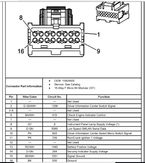

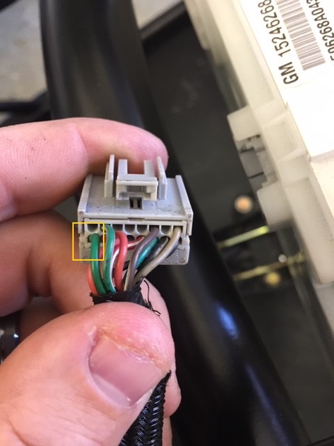

You may be missing the Low Speed Data circuit. It's the dark green wire. There was a bunch of them all going to one big black molded connection that the video had you cut out and solder together. Pin 9, I believe. Those lines carry all of the information. And obviously there needs to be a ground to the dash.
The illumination is a completely different circuit and 100% isolated from the rest of the dash. I know this because I just reworked ours with LEDs. Those are Pin 16 and 8 of the dash harness (top right and lower right looking from the rear of the dash).

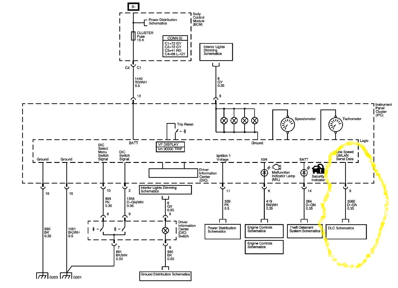

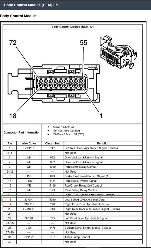

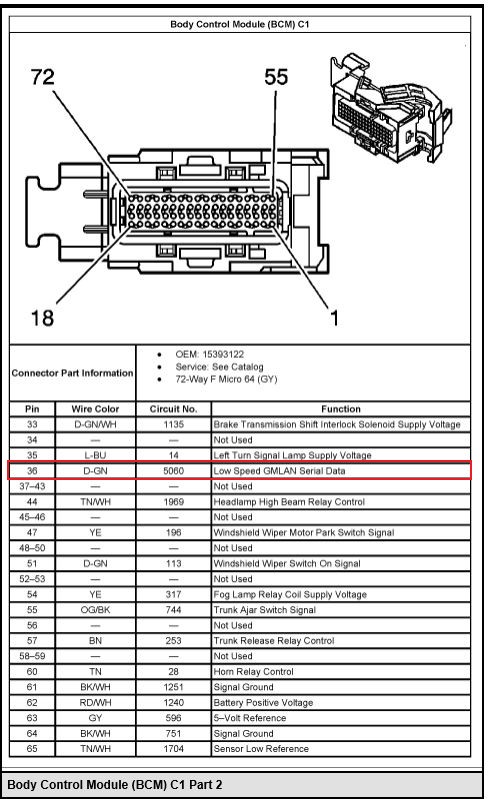

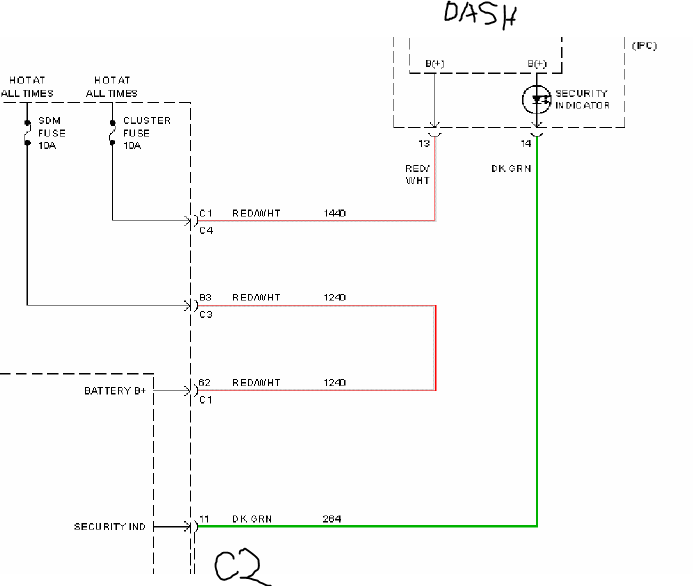

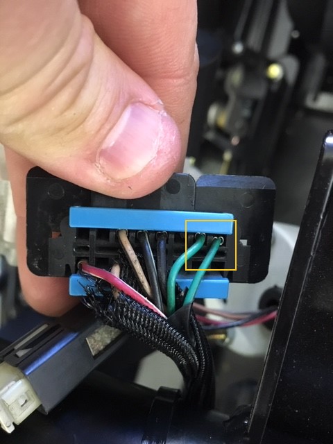

Your are correct pin 9 circuit 5060 is for the low speed data circuit of the instrument panel plug. It looks like it routes back to the BCM-C1 plug. What's odd is (2) PINs for that circuit 5060 pin 18, and 36 (shown below) are depicted on the BCM-C1 plug.
From OBD I receive continuity from Pin 8 (facing towards connector right/left), and Pin 14 of the instrument panel connector.
I believe the next logical step is to test from pin 9 of the instrument panel plug to the BCM-C1 pins 18, and 36 to see which one has continuity.
I believe
I think you have one too many green wires tied together. I'm going to keep looking but pin 14 (D-GN) Security Indicator Supply Voltage should not be connected to the GM Low Speed Data.
Pin 14 of the instrument cluster should ONLY go directly to C2 Pin 11 of the BCM. If it is showing continuity to the GM LAN wires, cut it out of that circuit.
Pin C1 36 is abandon. It went to the Vehicle Communication Module that was removed. This is part of the OnStar system.
Pin 9 of the Instrument Cluster should have continuity to BCM Pin C2 38 (according to my wiring diagram).
ncgoblin
You sir know your wiring between my research, your instruction, and continuity testing I was able to cut one of the green wires out of the OBD plug, wire from pin 9 to C2 38. Pin 14 to C2 11 I also made sure was soldered in. Now we’re in business all gauges work including gas gauge and the security key icon is now gone. While I had the instrument panel partially off I went ahead and followed your guide and razer blade all circuits for faulty lights now the instrument panel looks stock. I have to make some adjuments to the rear taillights and install seat belts then I am ready for state inspection!
