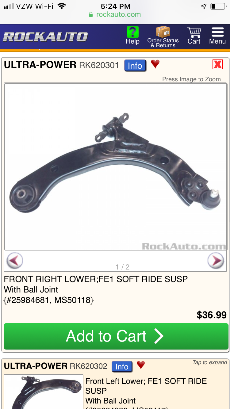

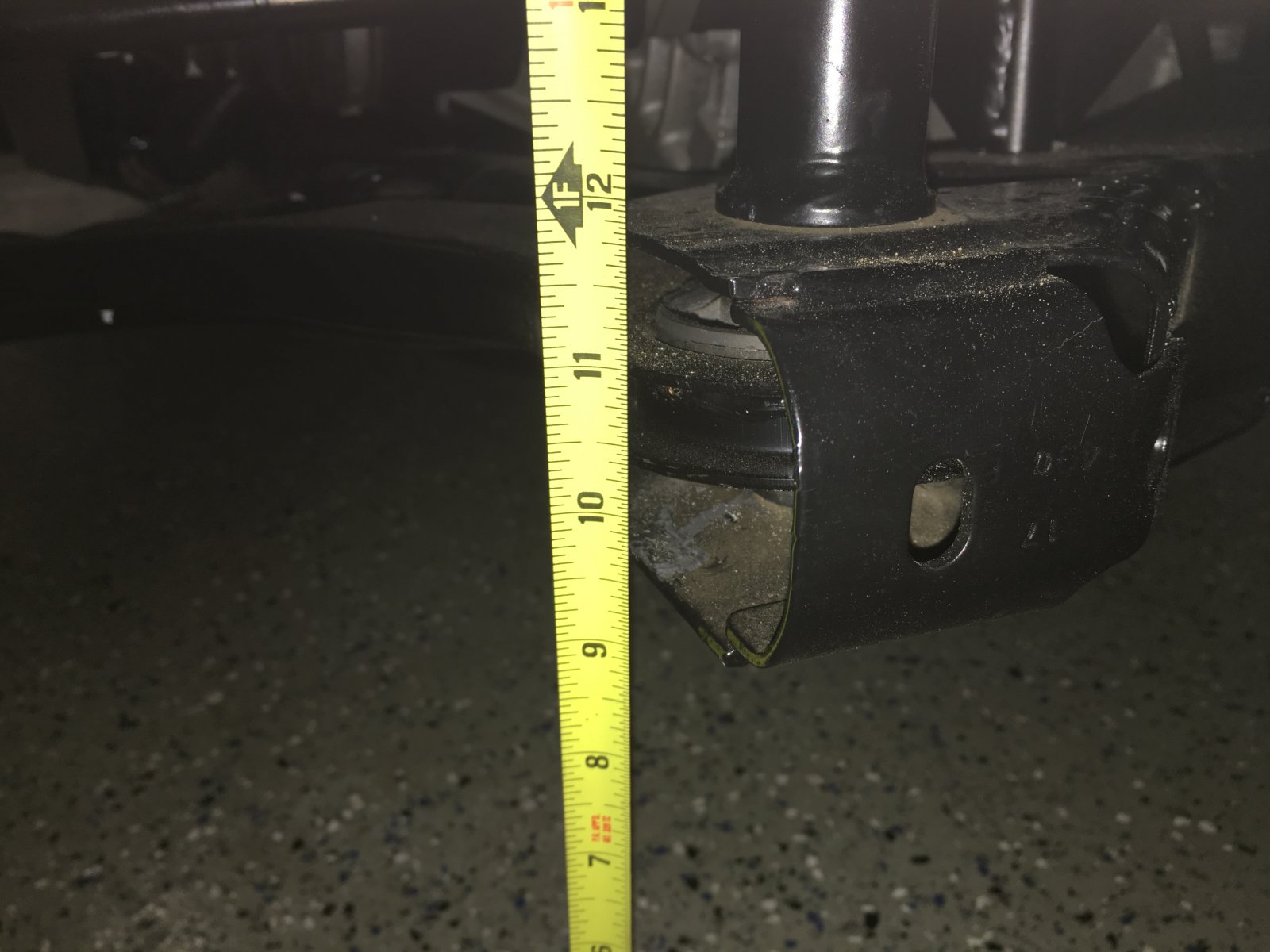

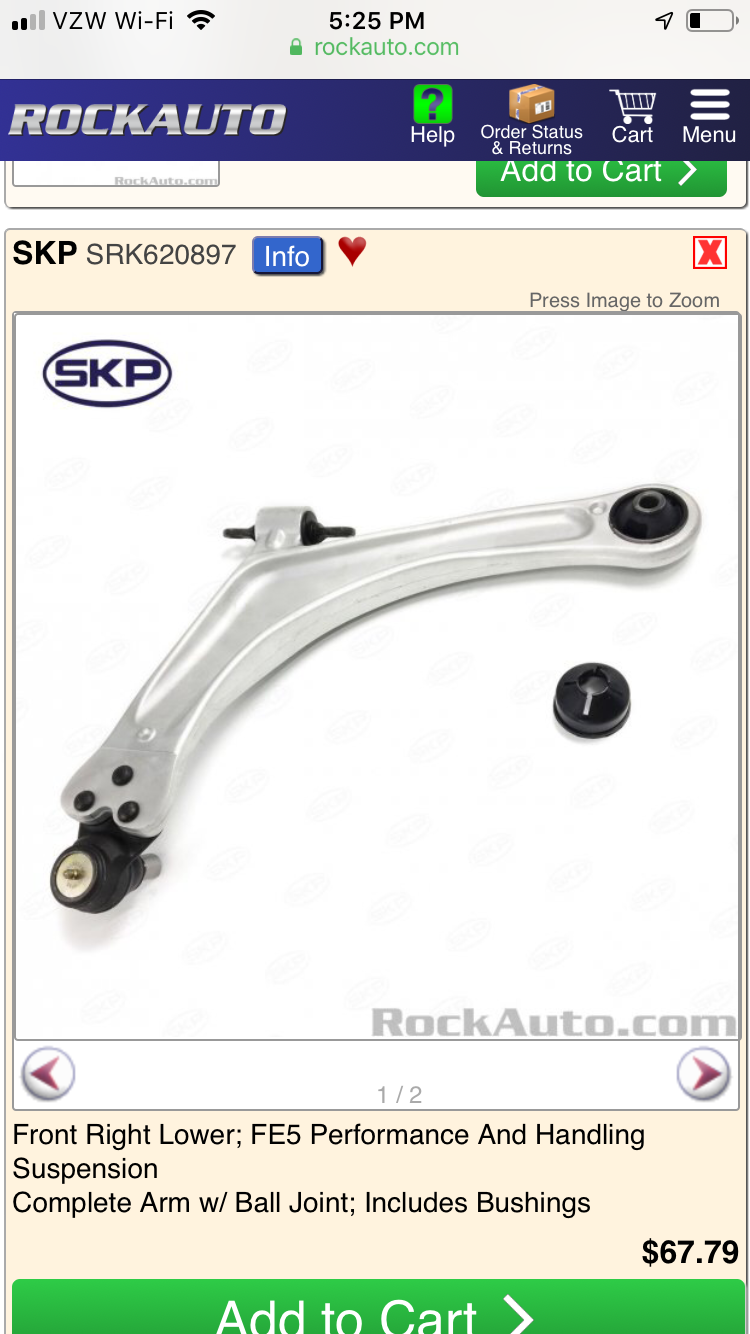

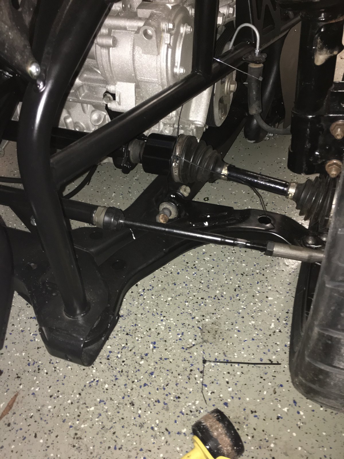

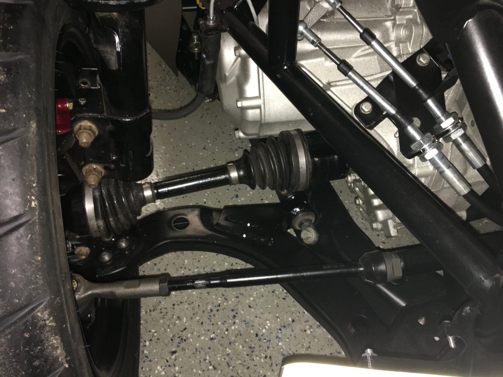

Today I went to Raleigh and got some powder coating done. I had my exhaust done in satin black high temp 1200 degrees and the springs Chad was generous enough to send me (oranage does not go with my color scheme). Chad mentioned they brought his ride height down to spec so I did not bother to cut and they were actually shorter then mine that I already cut. I installed and my ride height is 9” still! I am thinking the problem is not the springs before I just start cutting I want to verify with you all. First I think I purchased the wrong control arms everyone else has aluminum sport model control arms. Please take look at pics and let me know what your thoughts are.
My control arms:
Sport models
The arms will have nothing to do with the ride height. The struts are the only thing that will affect ride height (well, unless of course your spindles are different which I don't know how they could be). It's odd that the shorter springs did not lower the car, they should have. Unless the two springs are different spring rates. Shorter springs should bring it down. Now that you have two sets, you can cut one set up to your liking.
ncgoblin

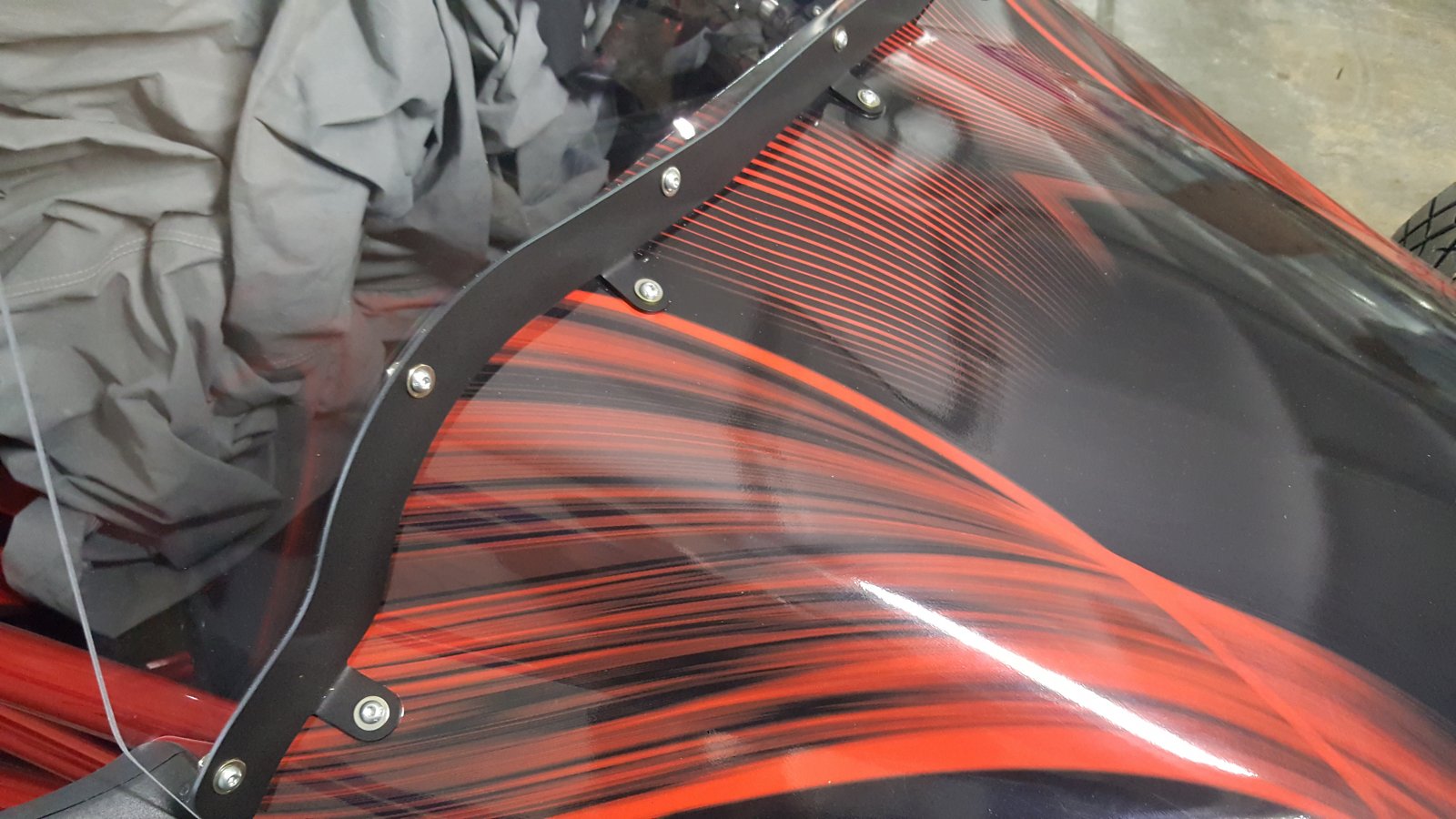

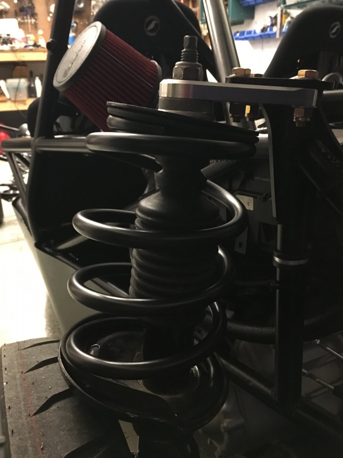

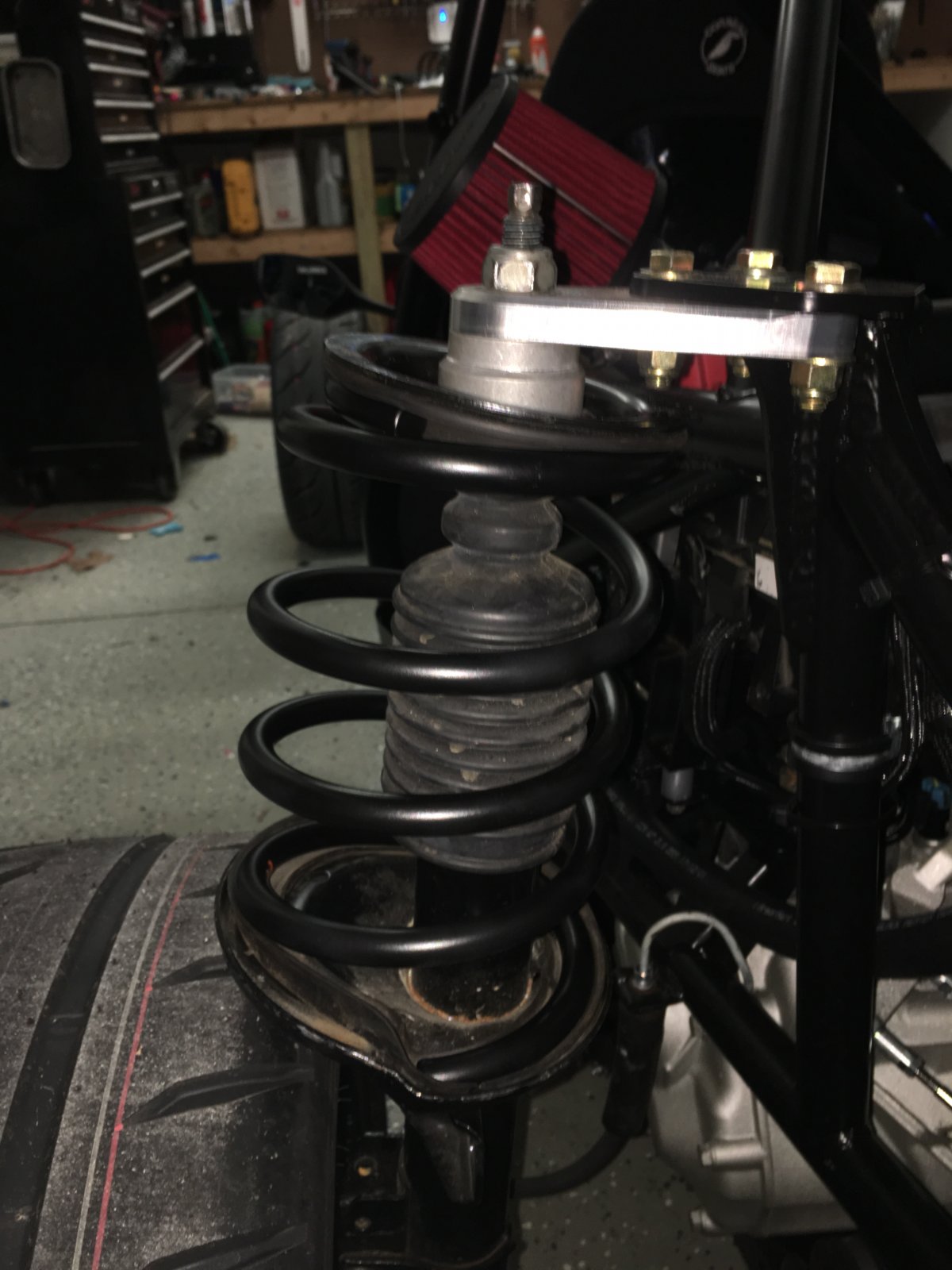

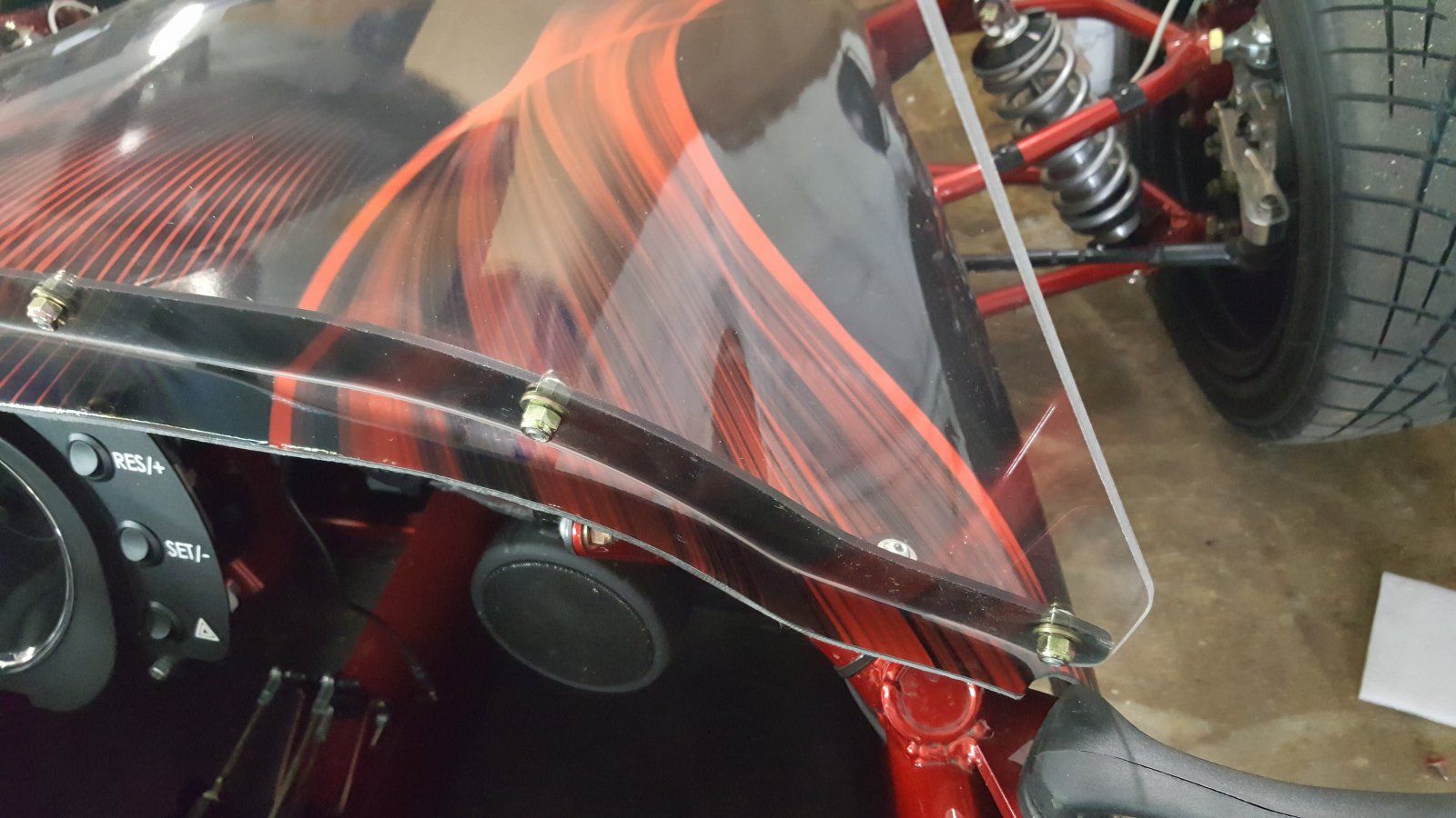

I went ahead and cut the springs even lower today then when I got them from Chad 1 1/2 links. My ride height is 6” now I was aiming for 7 but hopefully this will not be an issue. I also fixed the seatbelt straps thanks for the video. My hood is going to be marbalized painted this week black/red it should look very unique. Before I get it painted any tips on mounting the plexiglass windshield? I’m also removing my alternator it may have too much paint and not grounding properly.
The first hole to drill is the center hole three inches away from the rear edge of the hood.
Bolt the bracket to the hood. Then bolt the hood to your goblin. Be careful wheel drilling, you don't want to drill into your frame.
Next you will drill the two outer most holes. They are going to be about two inches away from the rear edge of the hood. You will need to flex the bracket toward the rear edge of the hood. This works best with some help.
Drill and bolt these two holes.
Now drill the two remaining holes.
Attach the windscreen. Start in the center and work your way out while bolting the windscreen to the bracket. It is best to leave the paper on the windscreen until you are ready to install it permanently.
Make a note of how much you want to change the overall angle.
Remove the assembly from the hood while adjusting.
Clamp one if the five tabs in a vise and bend the tab to the desired angle, match all of the other tabs to this angle.
Reinstall the windscreen assembly and check to see if any of the five tabs need to be adjusted. You can tweak each one individually, if you want, to match the angle of the hood in each of the five location.

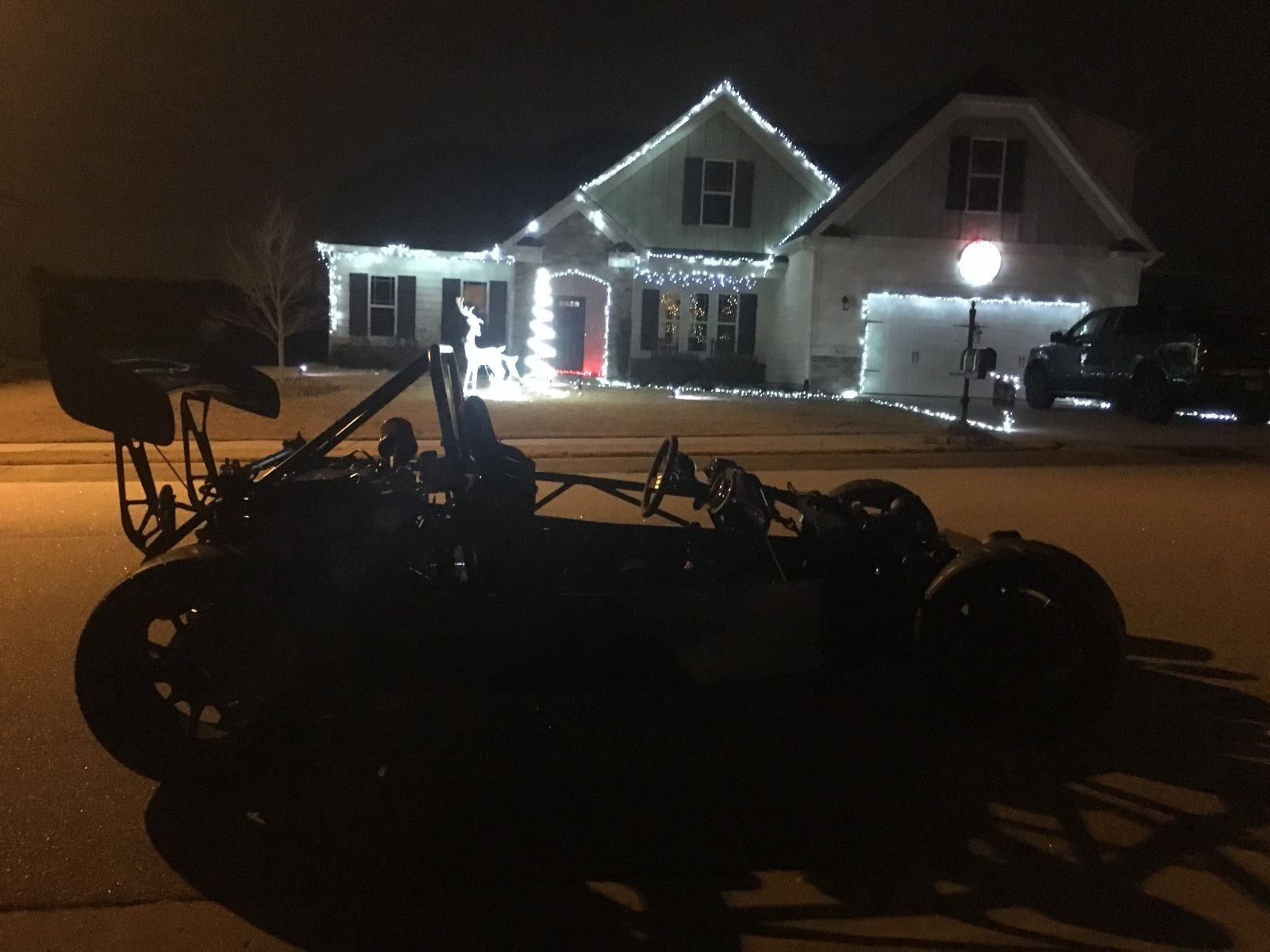

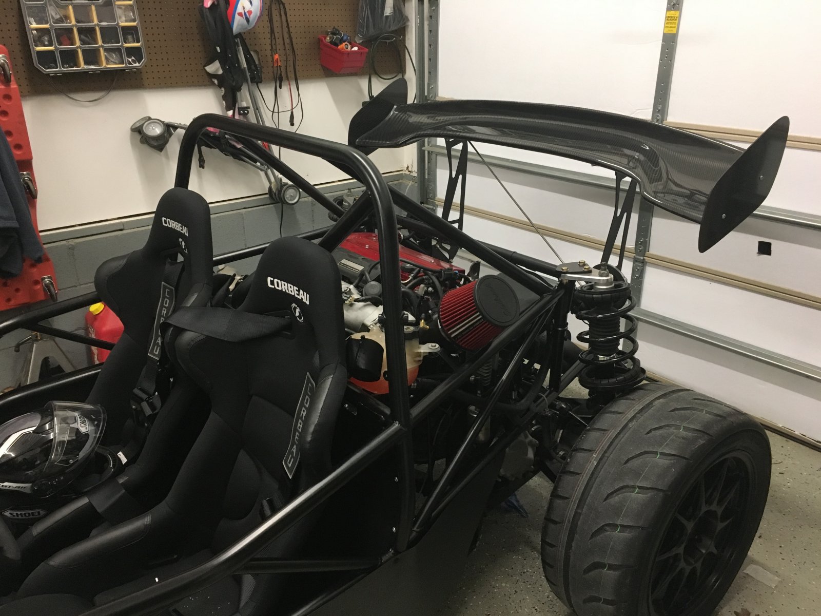

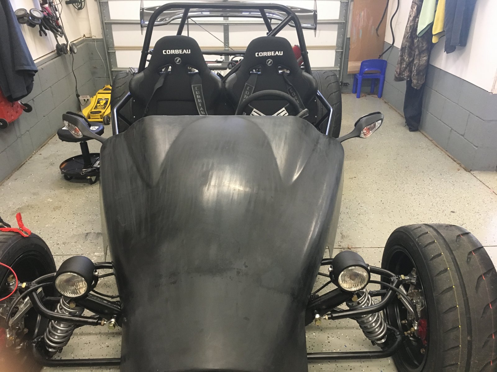

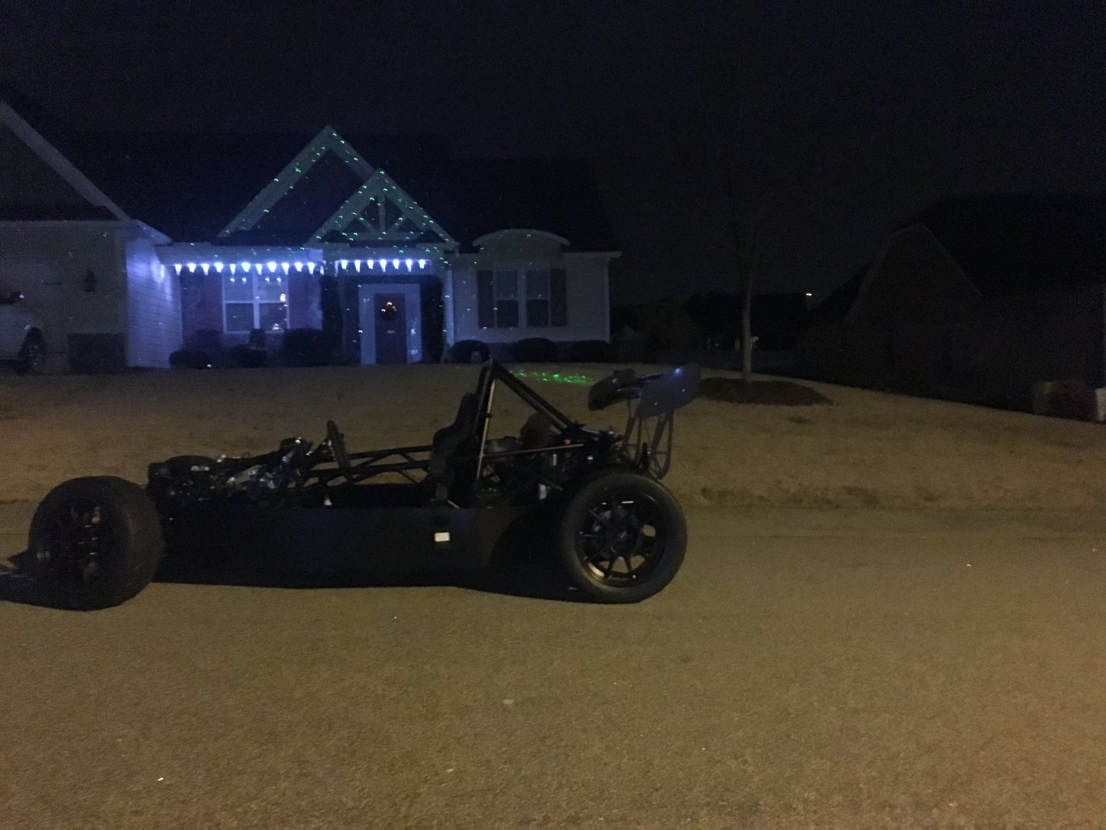

ncgoblin

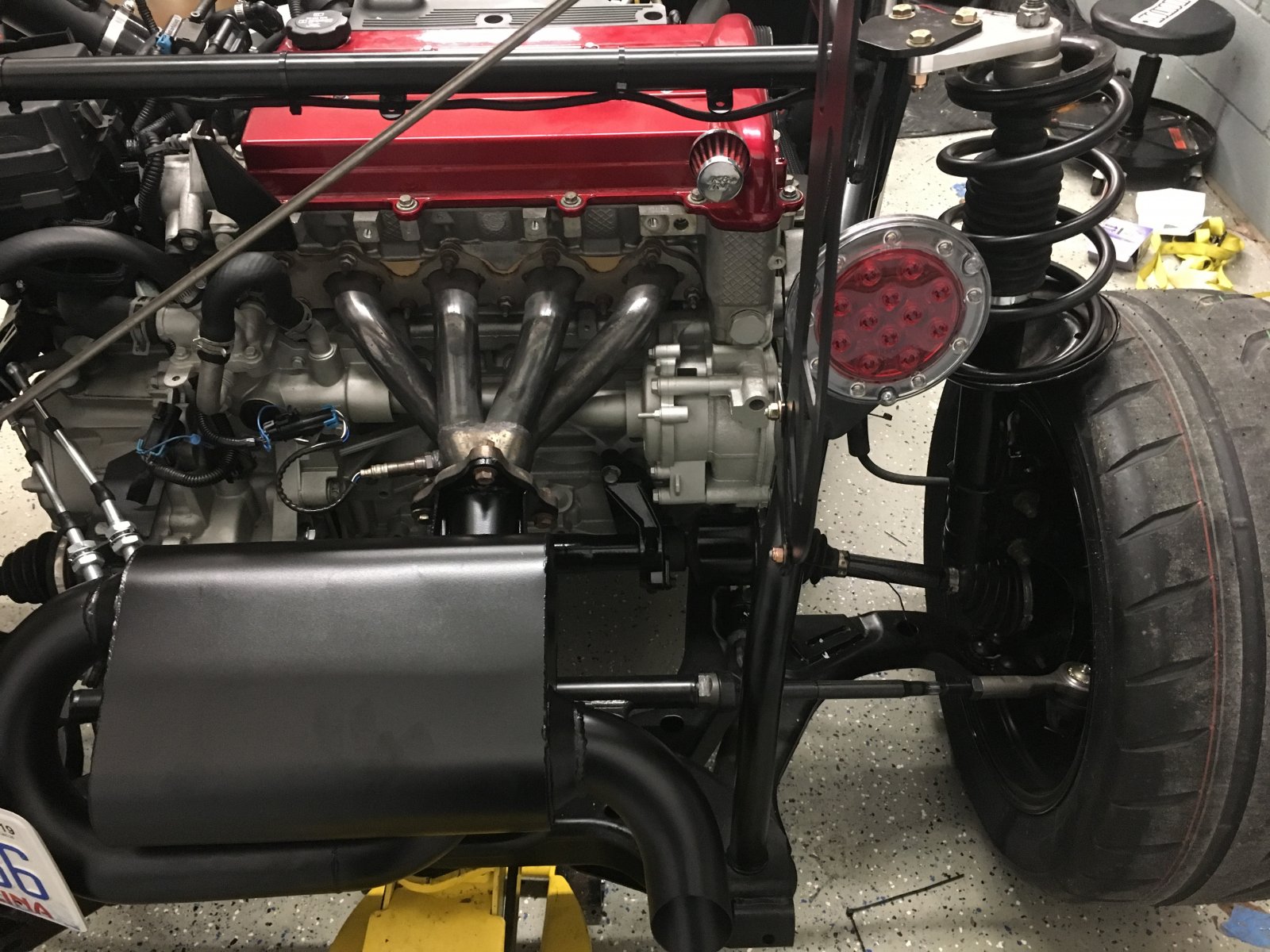

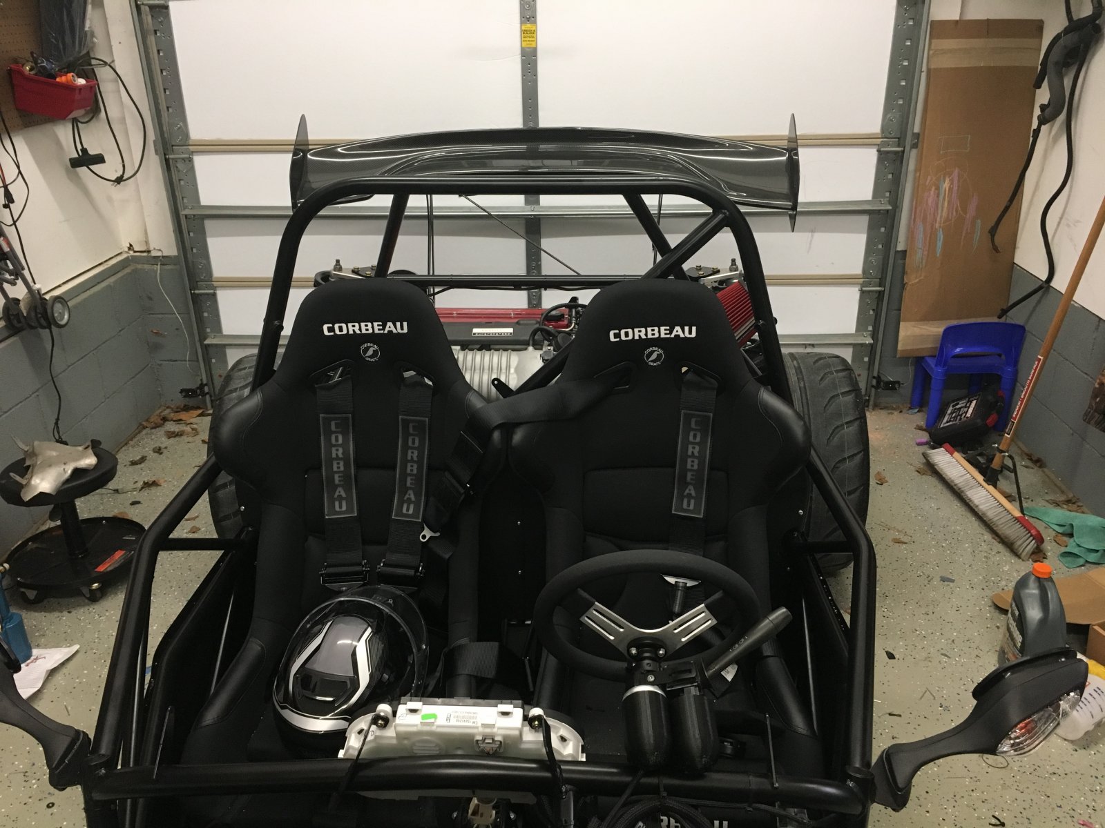

Here are some photos of recent progress. Not depicted is springs after cutting. Parked outside buddies house he was sick and asleep so I sent him this the next day lol.
