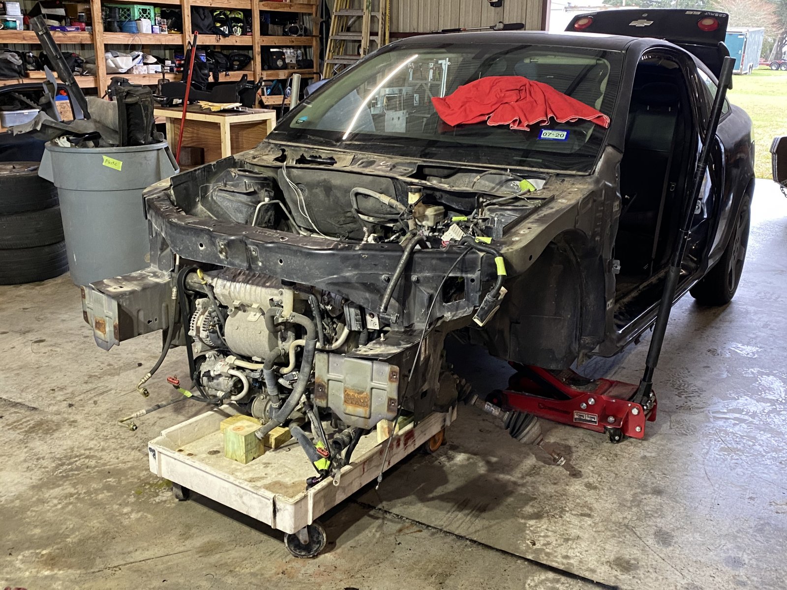

Regarding dropping the engine with a hoist, that's certainly a straightforward option, but you can also lift the body with a floor jack while the engine is sitting on the ground, or cut the core support and just slide/dolly the engine and trans out the front.
Ghostknife
Just put jack stands at the pivot point and have a big friend sit in the trunk to lift the front up lol.
I did what Ruaq said and it was very simple
devianteng
I have a set of QuickJacks and obviously used them. But I used my hoist to set the engine on a wheel dolly, then just rolled it out from under the car. If you can get the front end up after setting the engine on something with wheels, that's what I'd do again...was pretty easy for me and my FIL.
Regarding shifter linkage, I disconnected it at the trans. Was pretty straightforward/easy if I recall.
Sluggonaut
Some have said a little extra persuasion was needed, but my manual shift cables came off at the trans with a simple twist of a flathead screwdriver.
I had a hoist available but it was easier to lower the engine/trans onto the dolly, disconnect everything, and then use a jack to lift the car off the engine/trans. I also had dollies under the rear wheels so I just rolled the car back after using the jack to lift it high enough.
Yep. Lift the car, not the engine.

Yep, I actually did that as part of following the videos (and partly as an excuse to bust out the angle grinder and make some sparks fly). My buddy is coming over tomorrow with the hoist so we'll figure it out I'm sure.
