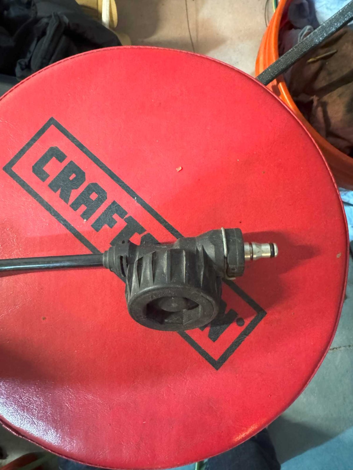

What is the puck on the clutch master cylinder line and is it necessary? I don't have much experience with hydraulic clutch systems at all, every manual I've ever owned was serviced at a shop.

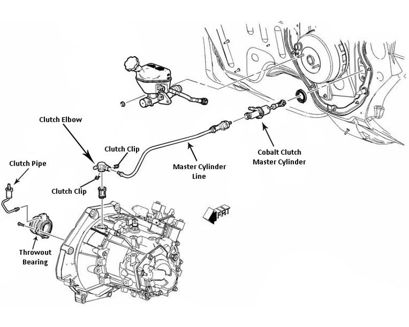

Are you referring to a part on this diagram? I know factory F23 hydraulics have something that I'd be inclined to call a puck but as far as I could tell browsing your build thread you haven't swapped from the original F35 transmission your '09 donor should have had.
52191
pisco

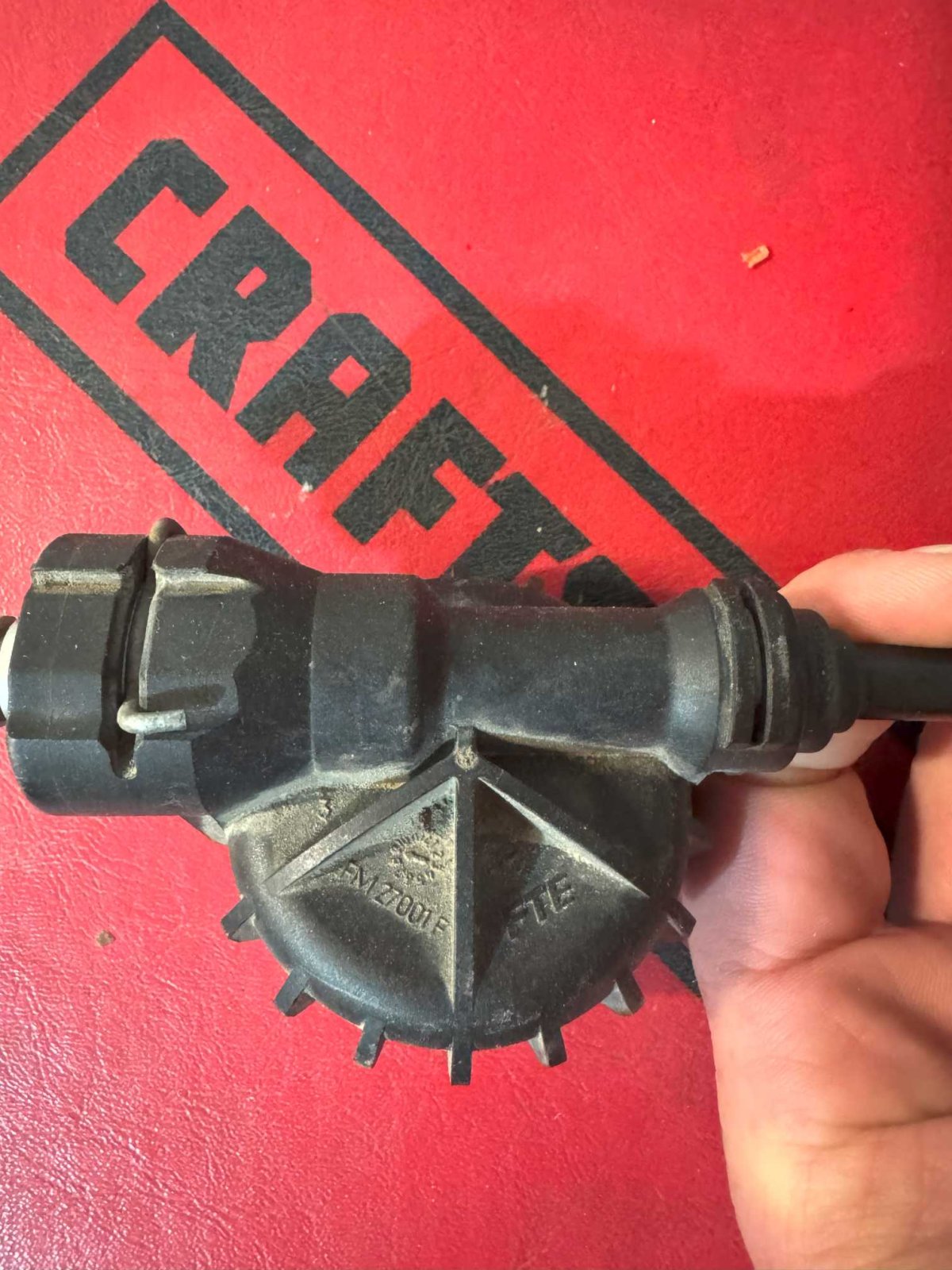

yeah it isn't in the diagrams for the F35 but it was there attached at the master cylinder part number FM27001F
not sure its purpose, loosely translated from the german listing for opel vectra parts they called it a vent. not sure thats a solid translation though
Is it good, bad or useless?

This came off my donor.

Well, the F35 system doesn't show it or use it.(even though Rauq's image is from an HHR) I would be inclined to leave it off of F35 installations. I've only seen it on F23 systems at either end of the pressure hose. (I cannot say about the F40 systems, I have not seen many of those.) I know it fits all the connections in both systems. Maybe it is a N/V/H part that made the system "quieter"? "Vent" might equal "silencer"?
In any case, as far as the high pressure side of clutch hydraulics goes, a DFKC supplied hardline runs from the clutch master to the elbow on top of the transmission. That accumulator or whatever it is doesn't get reused.
There's another hardline inside the transmission from the elbow to the slave cylinder, but that's Cobalt original and gets reused. There's also a hose that gets fabbed from kit parts that goes from the fluid reservoir to the clutch master.
pisco
That's how I had it hooked up and was not successful in getting any clutch line pressure at all, That part is referred to as an air separator so I was wondering if it helps bleed the system somehow. I will chuck it in the bucket and move on to another problem.
I do appreciate the input from the more experienced
I should say, I don't remember my donor ('06 SS/SC) having that piece, and I have not run one on my Goblin. Obviously I didn't run one of those "pucks" with the original F35 transmission, because I don't remember having one.
I did have one in my hand when I ordered a new F23 clutch hydraulic hose after my transmission swap, and I didn't install the part then either.
I would guess that's either pulse damper or a flow restrictor than an air separator. I can't imagine how an air separator would work on a pressurized hydraulic hose, at least not an automotive application with no vent or drain on it.

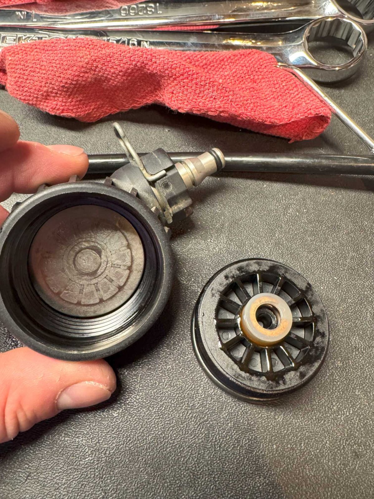

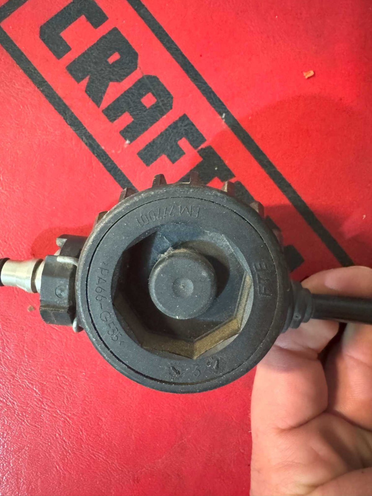

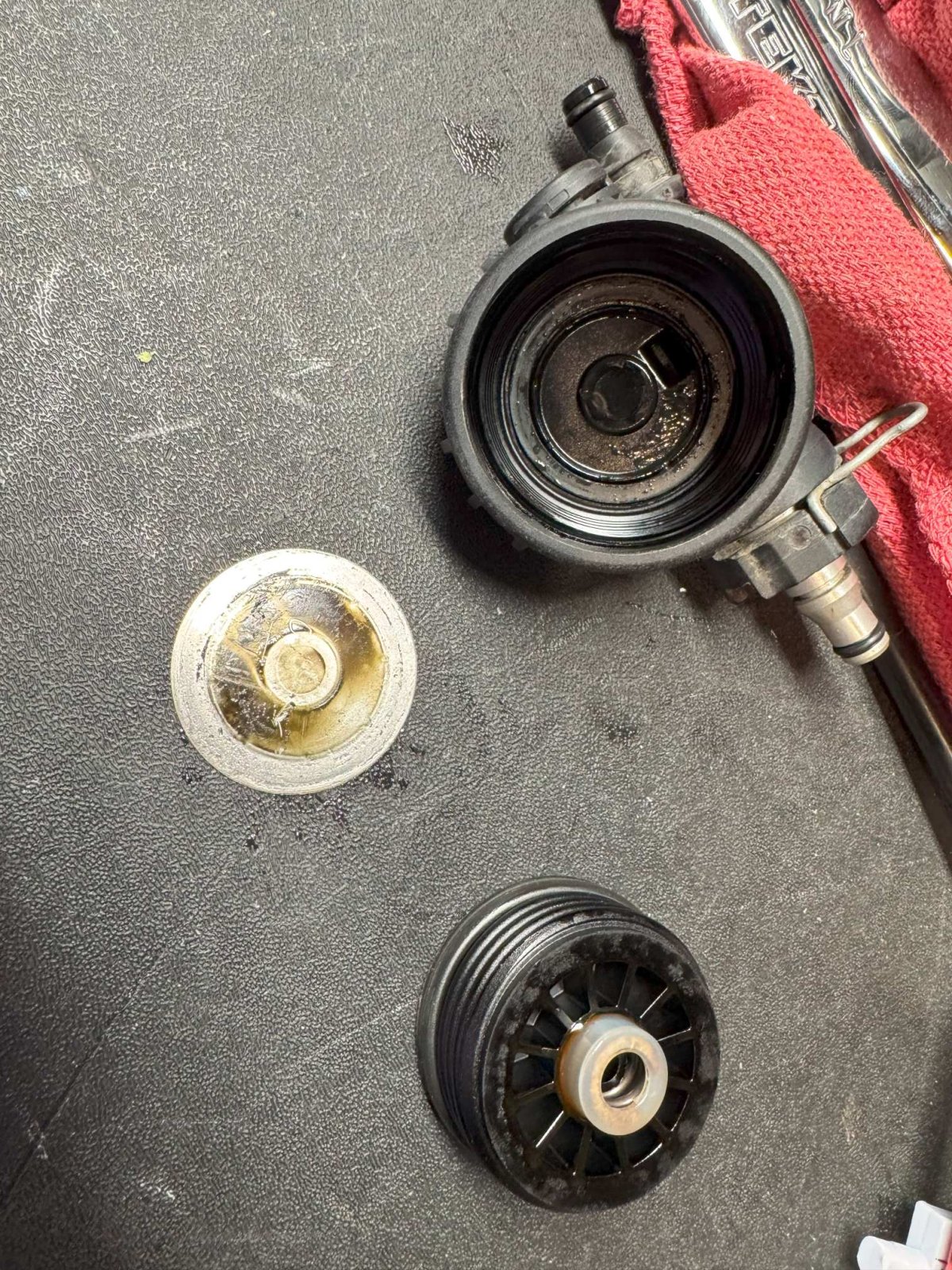

I agree, however it does appear to have a threaded insert I'll try to disassemble tonight for science
pisco

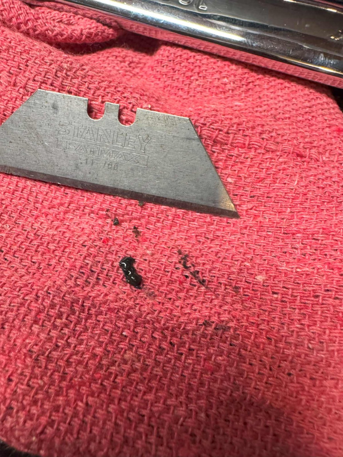

the square passage at the bottom is open to the clutch line and allows hydraulic pressure in, the white circle on the cap is a spring pressing the metal disc against the hydraulic pressure, the metal disc has a rubber seal around the perimeter, it looks to me like high pressure allows the seal to open and vent either air or fluid into the back side of the diaphragm, I cannot tell if its vented to atmosphere or completely sealed
there was a fair amount of gunk under the seal, more than I'd like to see in a hydraulic brake line anyway

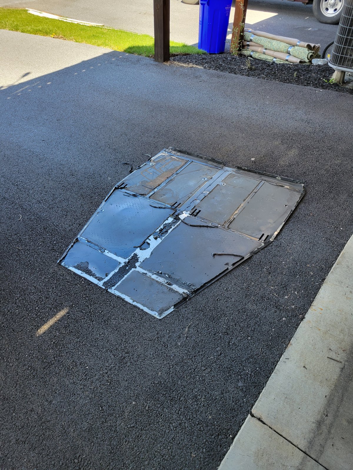

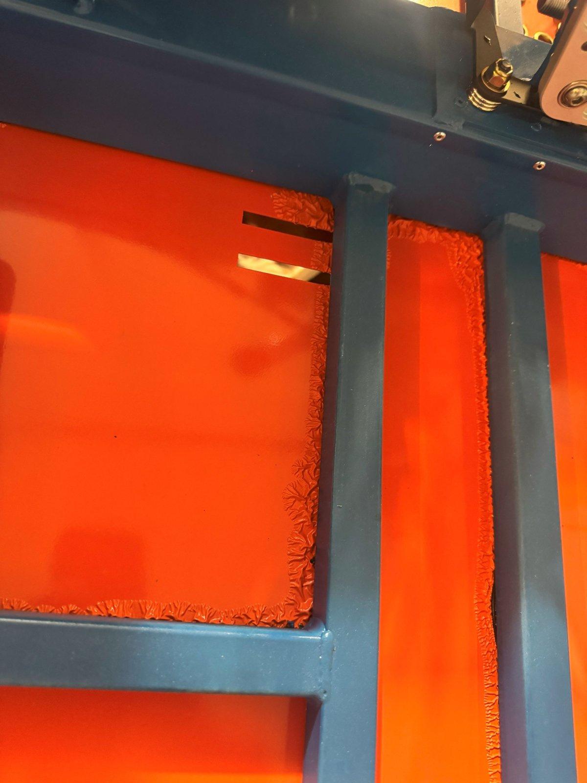

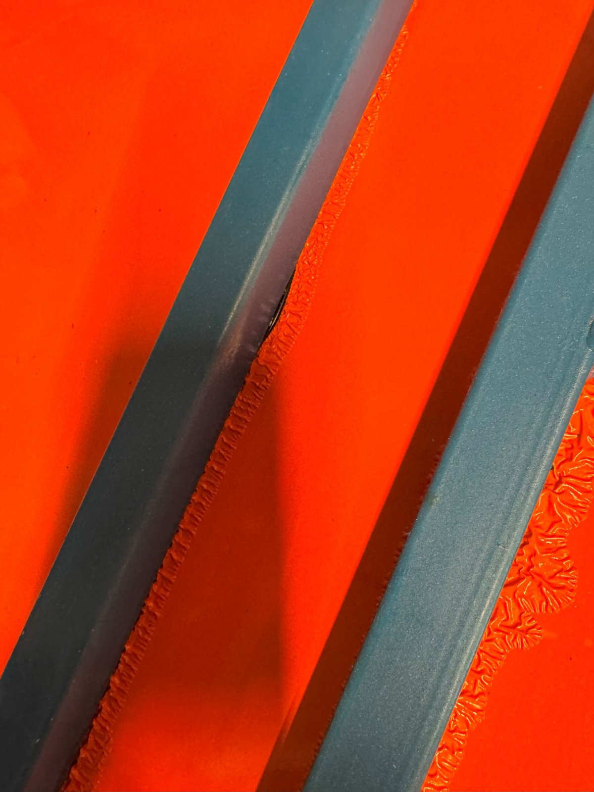

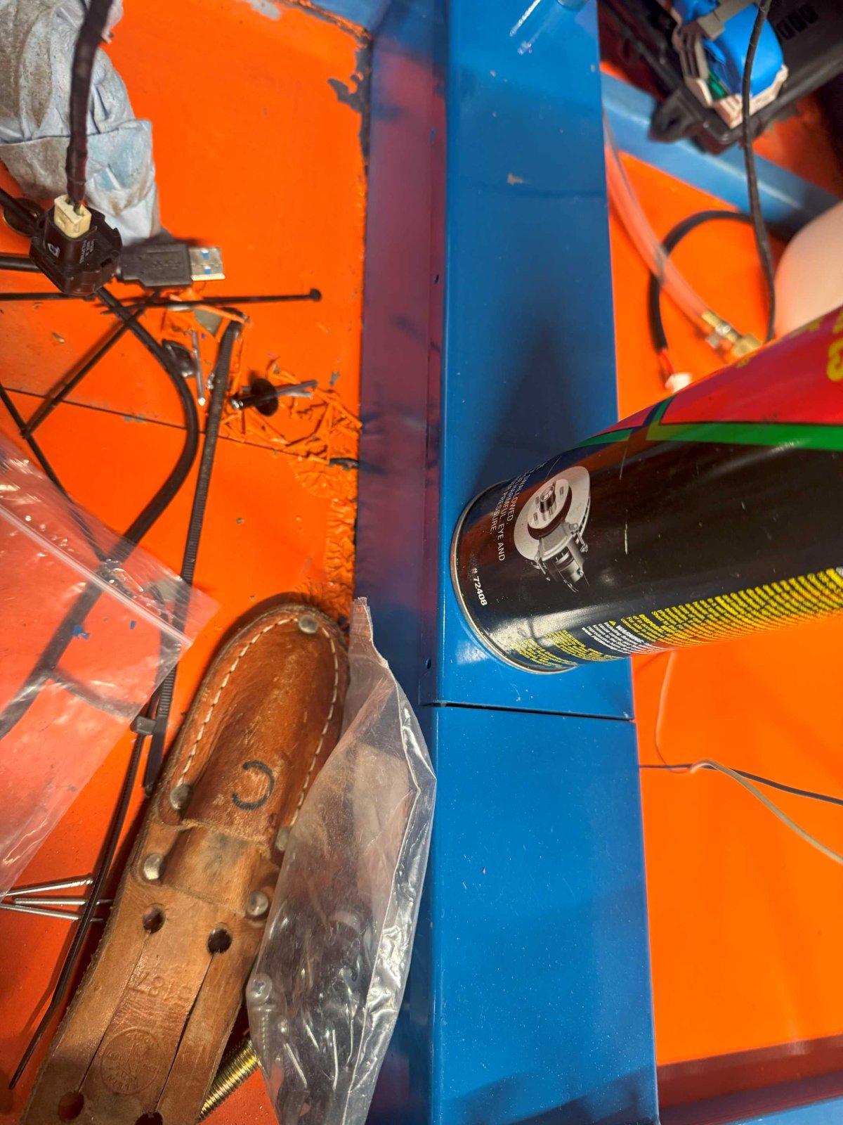

more of the aftermath of the great brake fluid flood of 2025
current plan is to punt this problem to another day, I will try to get it clean and mask off interior to re shoot it will do solid color on frame and floor pan and will probably silicone the seams to prevent any fluids getting between ever again.

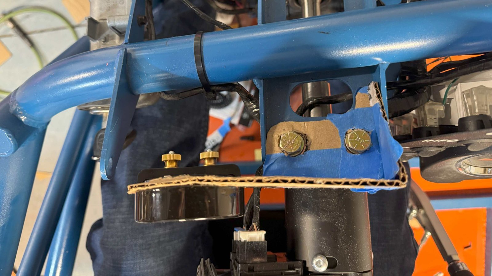

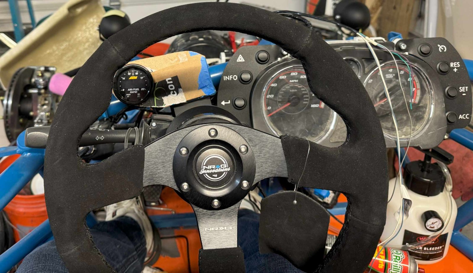

mocked up a bracket for the wideband and boost gauge (need to order boost)

Having experience with this same brake fluid issue, I can tell you with fair confidence, you're going to end up pulling the floor pan off to thoroughly clean between it and the frame rails. Otherwise, coating will never again stick to the floor pan.
Ask me how I know.
pisco
Ask me how I know.
not what I wanted to hear!
thats ok I'll figure it out someday right now I just need to make this thing safe to drive and drive it, pretty can happen later...

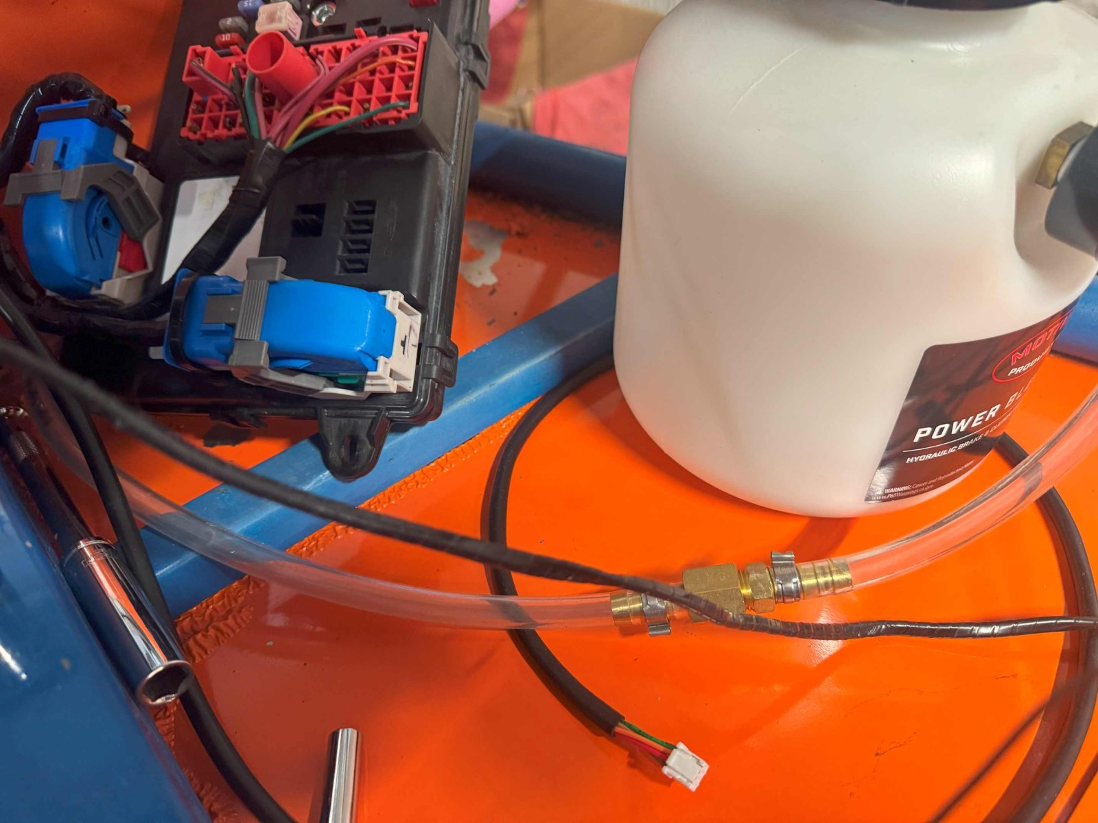

I would leave it out. If the clutch isn't bleeding out properly, it is likely due to your bleeding technique. These can be difficult to bleed without either a vacuum or pressure bleeder. I prefer pressure bleeding if you have the reservoir to master cylinder hose set up to handle some pressure.
I am using a motive power bleeder, I don't know if I can blame that for the leak between the res and relocation block.
I got fluid all the way to the elbow but never back pressure on the pedal, none at all!
