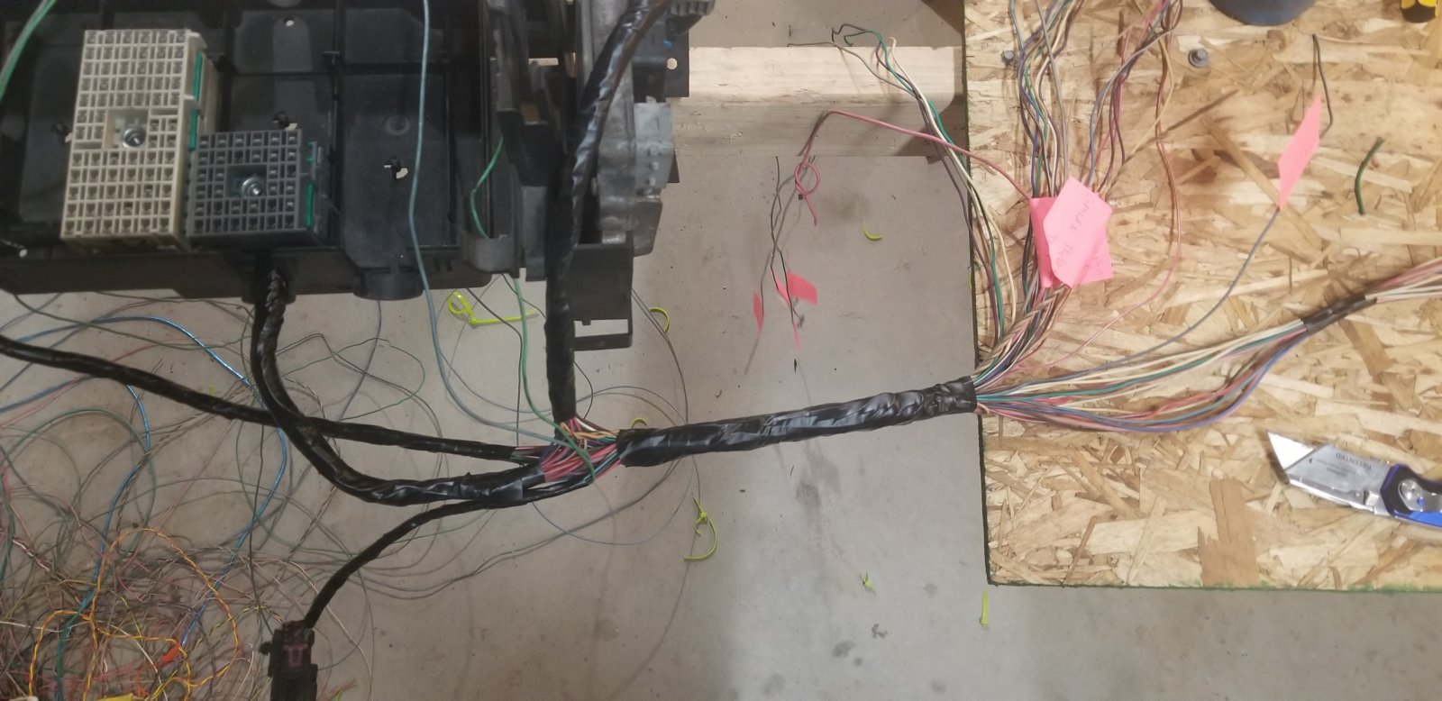

Yesterday I spent almost six hours going through my wiring harness and checking all the pinouts for the wires I thinned out while watching the first 4 harness videos. I have a few wires that I am questioning what to do with.
I have the following
Tan + tan/black data wire
Grey stop lamp supply volt
Thick pink Run/crank ignition volt
Grey 5v reference
White EVAP canaster vent solenoid control
Purple unidentified wire
Green fuel tank pressure sensor signal
Grey fuel pump primary relay
Dark green backup lamp
What I have and what the guide has at the end of video 4 are slightly different. Can someone identify the wires shown at the end of the video or help me figure out what I did wrong?

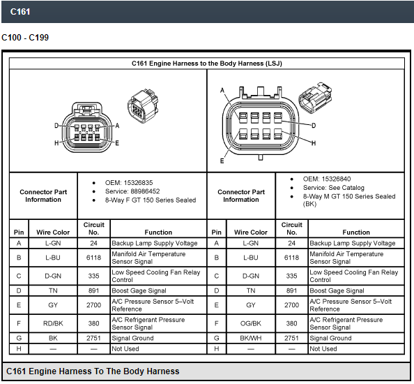

Sluggonaut
I'm in the process of thinning the AC Pressure wires from my engine harness. If that grey wire runs to pin E on the purple engine to body harness connector that is what it is:
31953
This is the engine harness side, but it will be in the same place on the body harness side:
31954

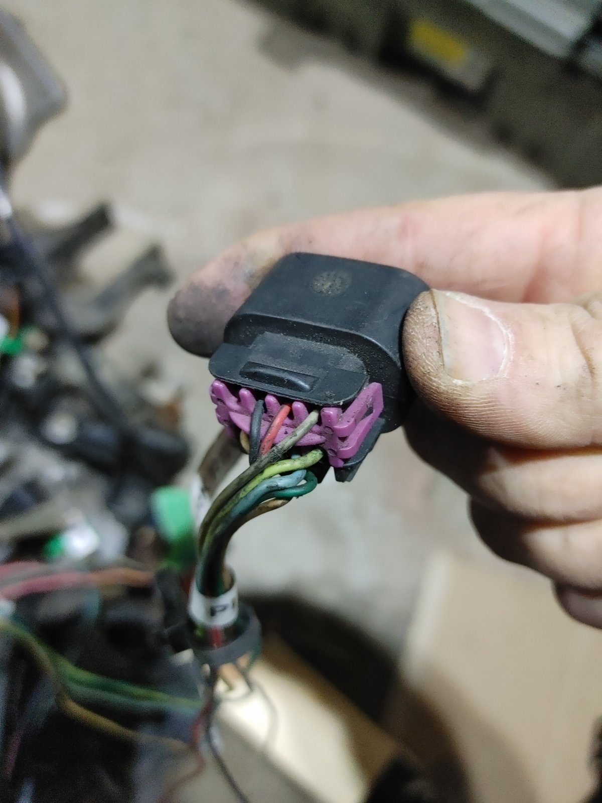

I've run into a bump while combining my dash harness to my body harness.
My conectors for the brake and clutch are different than what are shown in the build videos. I cant tell the differences between them and I dont want to screw anything up. In video 9 (3:45) they take the brake pedal wires and cut and tie them, I cannot determine what conector is the correct one for my 06 lsj.
Then in video 10 (4:54) they tape the brake and clutch conectors. I only have the accelerator pedal conector and one other disconnected from the harness due to not knowing what plugs are what.

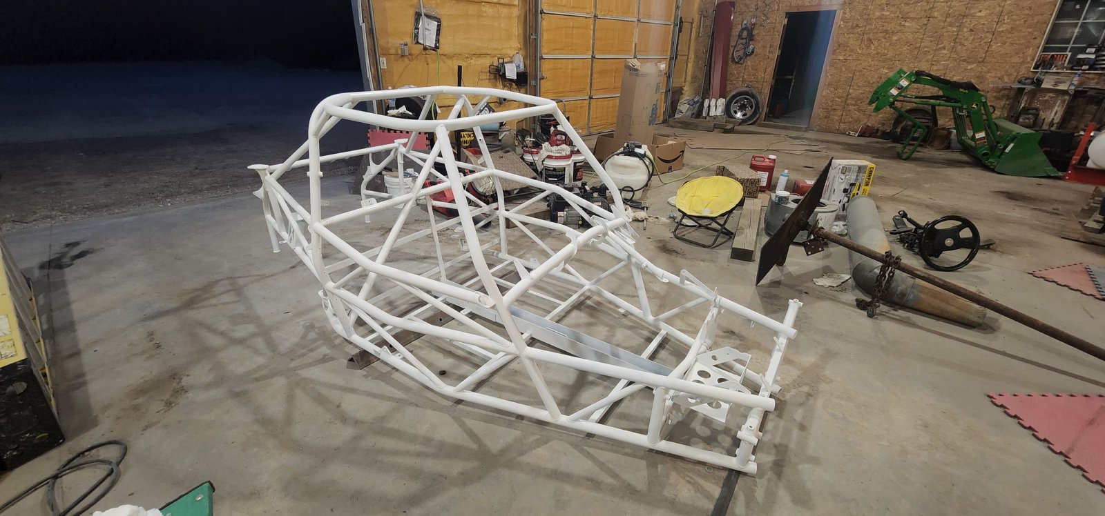

Also what is everyone's experience with painting the chassis themselves?
I plan on using a single stage white automotive grade paint (like GM gloss white)
My LSJ clutch switch has pink & yellow wires. I removed the cruise clutch switch. The pink gets 12V+ from the BCM, and the yellow sends power to the crank relay when the clutch is pressed.
I painted my frame with Rustoleum gloss white. Mostly because I want to able to weld to my frame, and make changes. It is easy to fix paint chips, and I end up doing touch up on my frame about once a year.

It's been a while, I've made some decent progress.
Wire harness is complete
Chassis got its last coat of paint today
