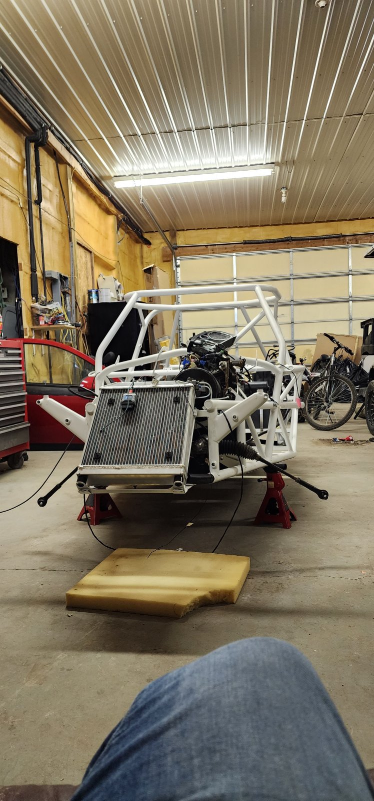

Having the car somewhere nice to work on makes it much easier to get up and go out in the garage. I now have it in my heated garage. (Don't mind the clutter, family storage)

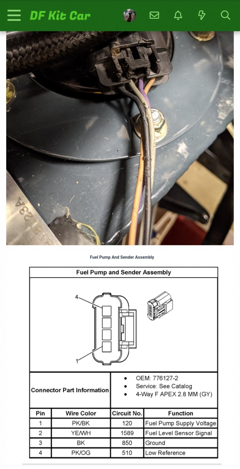

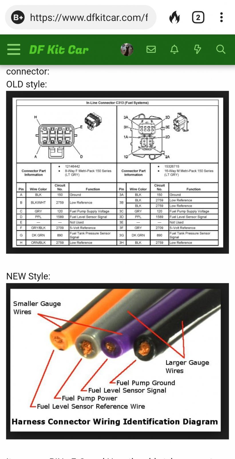

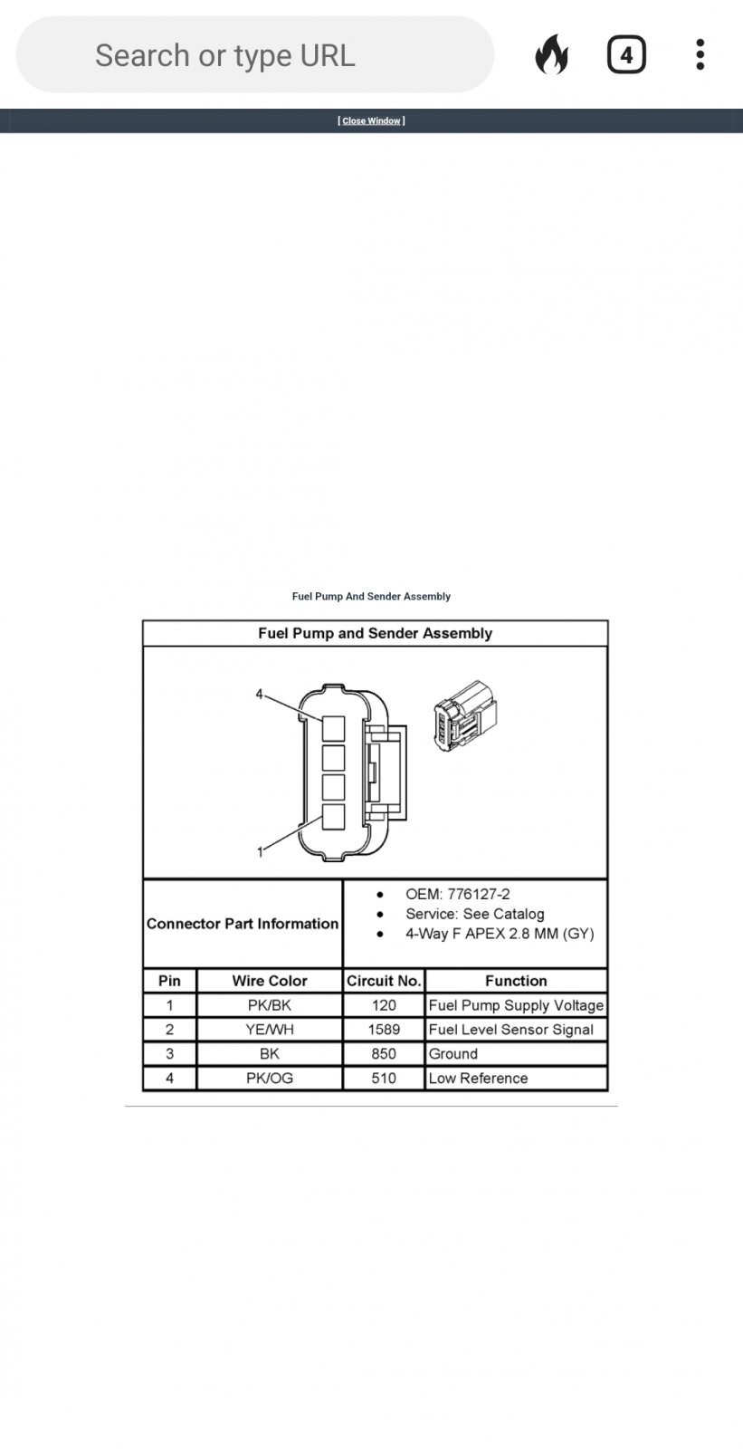

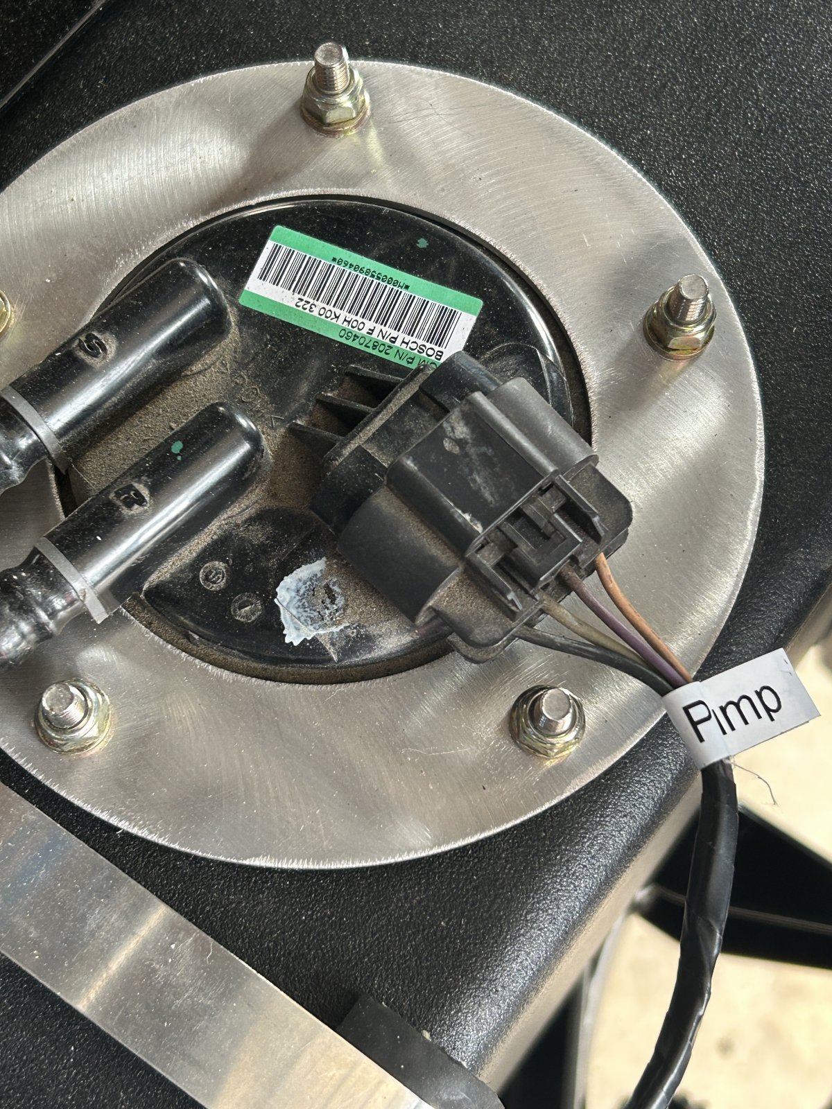

We then put dielectric grease on the plugs under the fuse block and tightened them down as tight as we could without stripping them out. We ensured some grounds and sorted through a few wires and then realized that I might have wired the fuel pump wires incorrectly. I have an 06 LSJ and the build videos used an LNF so they were different between models. We still don't belive this is a possible cause or contribution to the no start but if anyone has the correct wiring for my year and engine it would be awesome if they dropped it here.

I'm at a standstill once again with only the fuel pump wiring and no communication with the EPS module to guide me.
Not sure if this will help, but here's the plug end:
39781

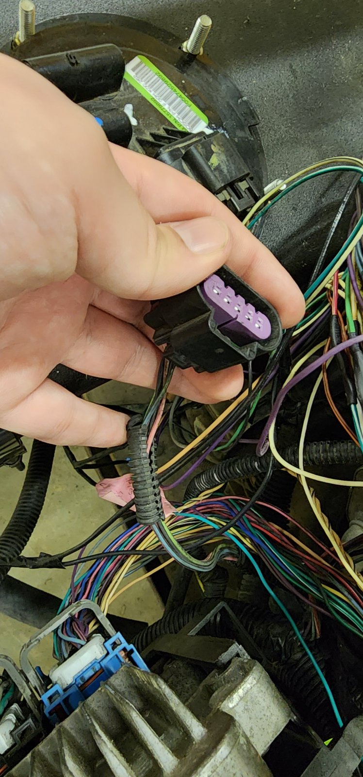

I'm not even positive that I have all of the engine harness connected properly.
I have the large power wire that goes from the battery to the starter and fuse block post but I'm unsure what this plug is.
Either that or injector plug.

F
Green wire set aside goes to c1 pin 24 and is the fuel tank pressure sensor signal
Thin of grey wire goes to ecm c1 pin 47 and is a 5-volr reference 1
I have the others figured out
I'm also looking for a fuse block ground that I dont have, its needed in part6 at 1:20
Do you happen to remember what you ended up doing with 24 and 47? I now have the same two wires hanging out and wondering what to do with them.
