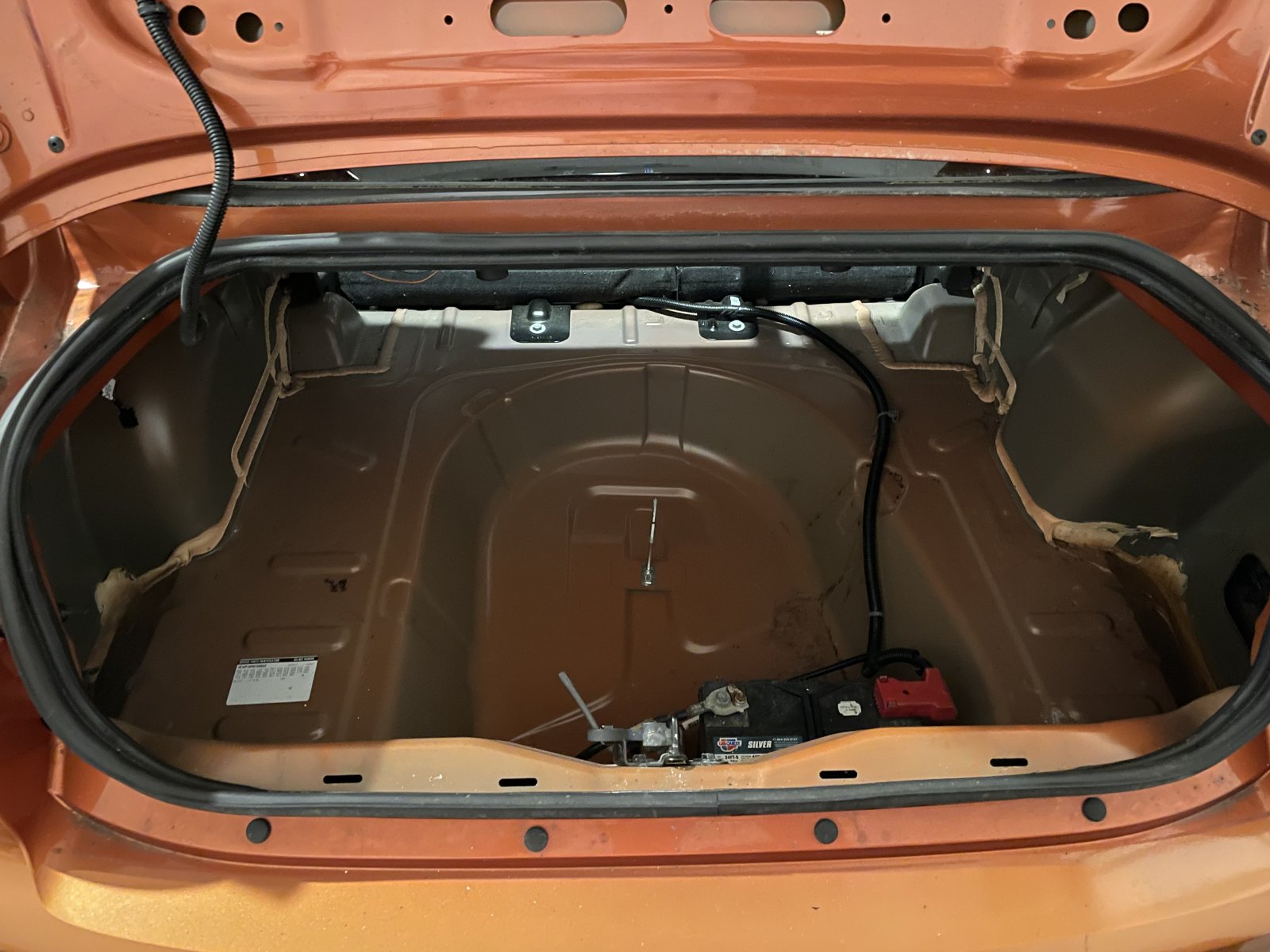

Got the car home, but had to wait for the TN title, so decided to strip the trunk on 3 November. Had to wait for the full tear down because Florida wants to see the car in person if it’s never been titled in the state. Wanted to make sure it was titled in my name in Florida to prevent any issues with registering the Goblin when it came time.

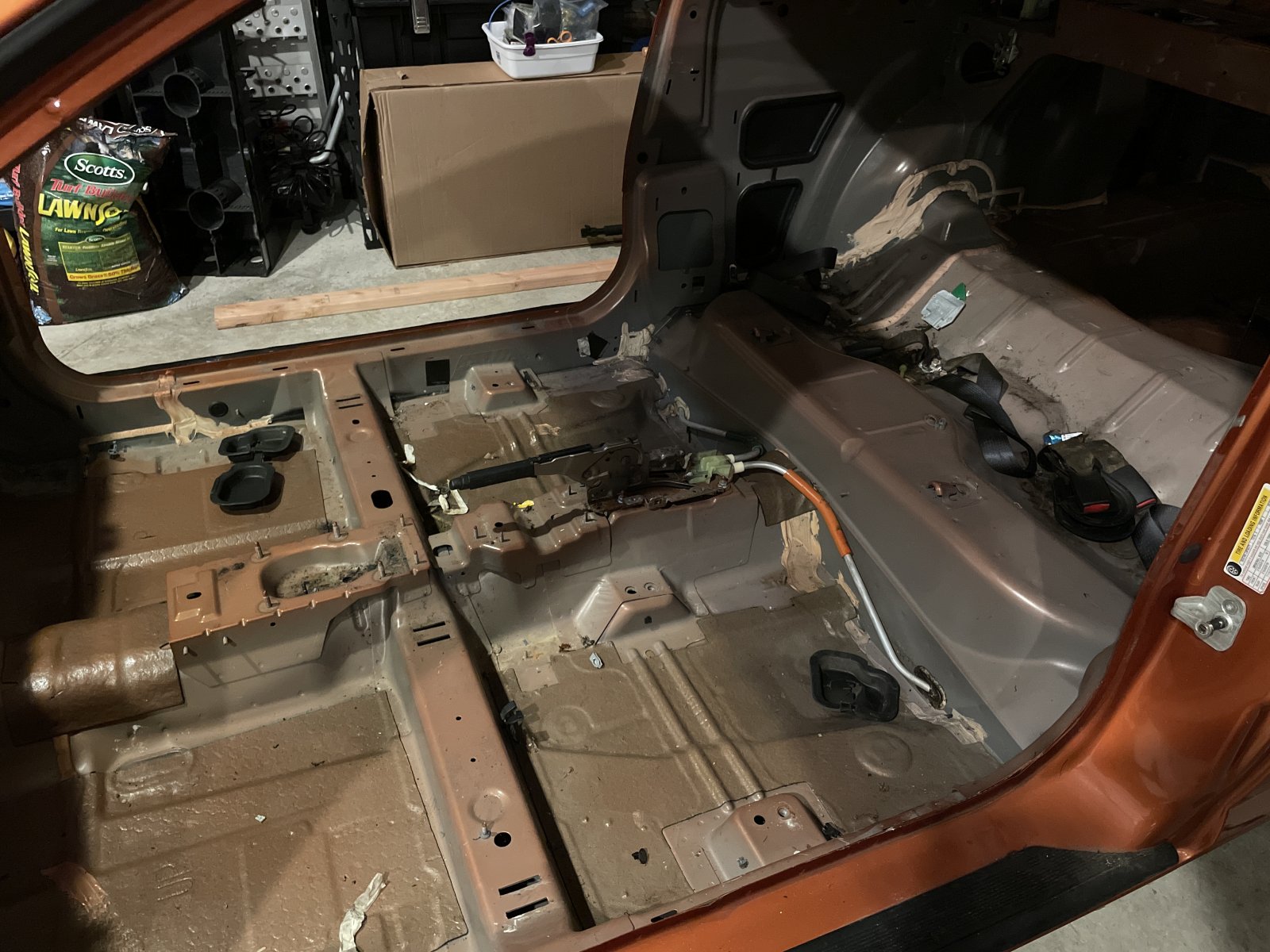

Got the title in my name on 13 November finally. Was excited to get started ripping the donor apart, but have been busy with work and reserve duty. Yesterday was the first day off in 3 weeks, but I didn’t let that stop me from getting to work! Got through videos 1-3 (stopped before dropping the subframe in vid 3).

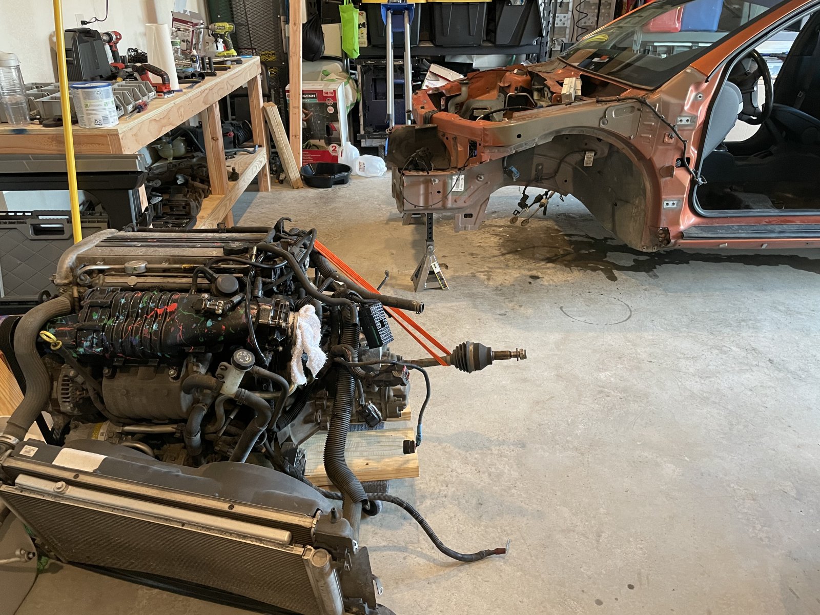

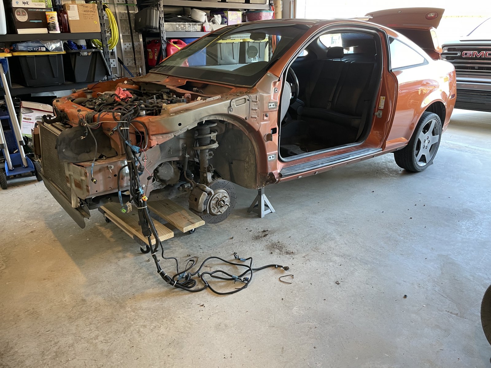

Finished the 3rd video and completed the 4th today. Glad I’m past this part as I feel it’s about 30% of the entire build. Never dropped an engine before so had me a little worried, but the build videos (albeit for a NA build) were a huge help (THANKS LONNY AND ADAM!) and the build is moving right along.
18522
Wish I had an engine hoist to help drop the engine, but everyone’s suggestions in other posts helped a lot. Had a jack on each side and lowered the car onto the dolly (under the engine), unbolted, then jacked the car back up and slid the engine out the front. Glad I had a second set of hands to lower and raise the one side with me (wife). She’s helped me mod all of our cars and isn’t afraid of getting dirty.

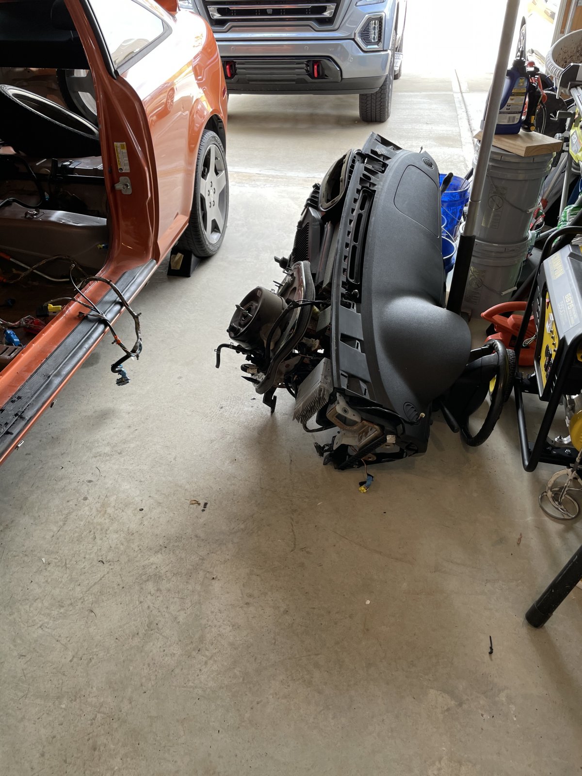

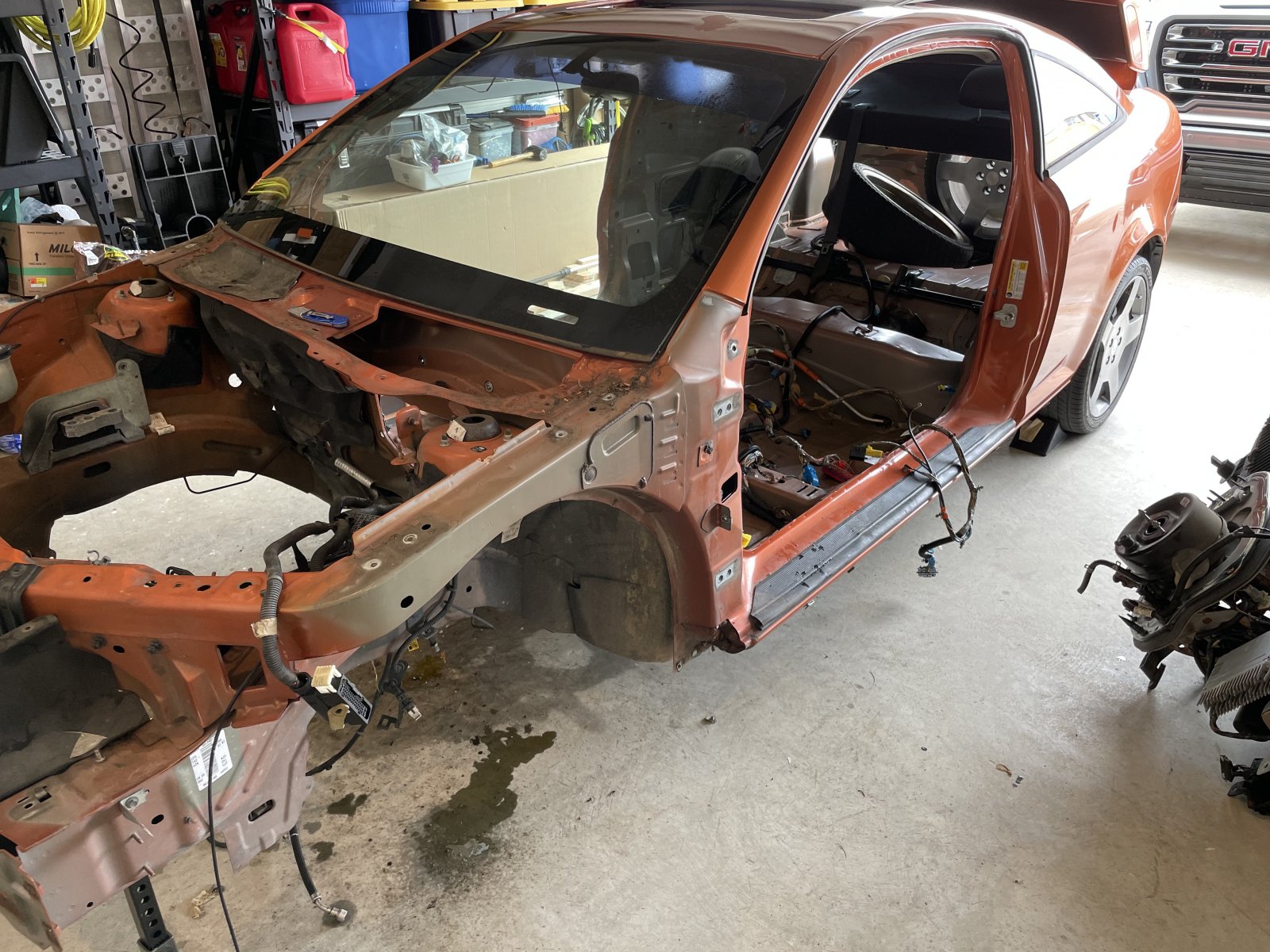

Made progress on stripping the donor today while staying out of the kitchen. Got the dash out, stripped the inside and pulled out the main harness. Next step is the gas tank, rear assembly and pull the dash harness from the dash. (Completed through video 6 I believe it was). Need to grab the ebrake assembly once I dismantle the rear as well.
