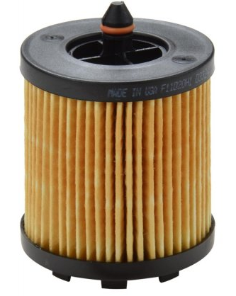

Pardon my ignorance but where would we put the magnets on the oil filter?
19577
True, didn't think about the oil filter being a cartridge. Maybe I will have to work on a way to get a magnet into the filter cap that will collect metallic particles so they can be removed with the oil filter cartridge change. The cap is plastic so it may be as simple as epoxying some neodymiums to the outside?
EDIT: there are a couple companies (CBM, DDM) who make filter adapters to provide for remote filters and oil coolers. The stock GM filter cartridge is tiny and is a good candidate for an upgrade.

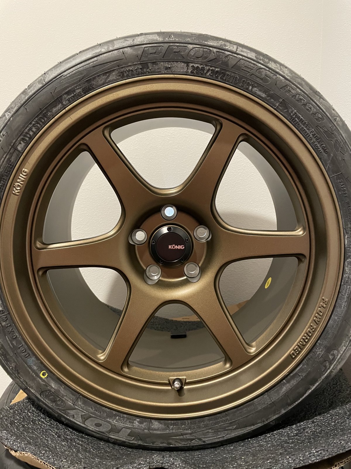

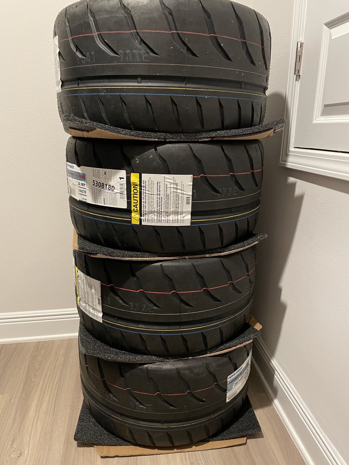

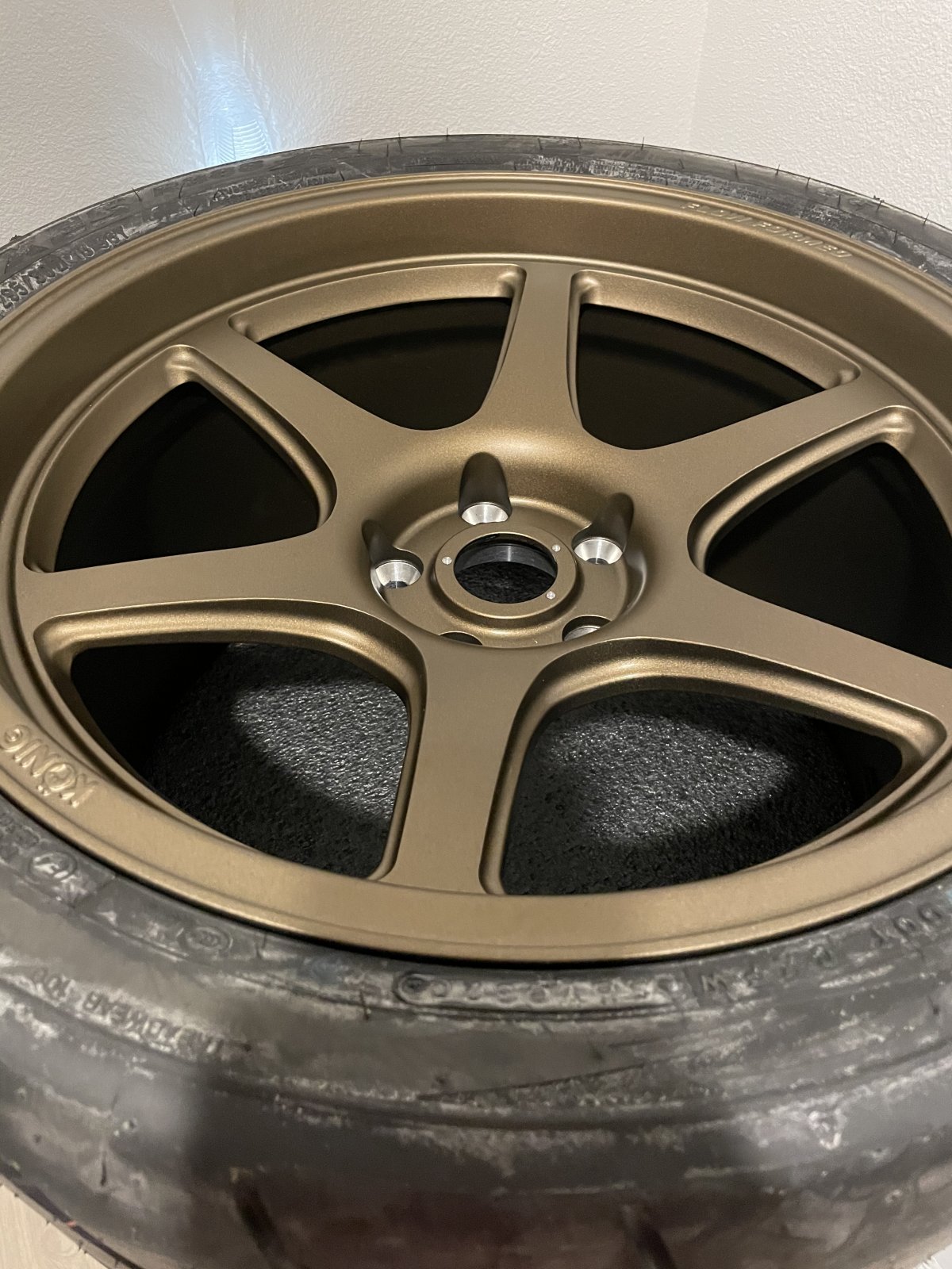

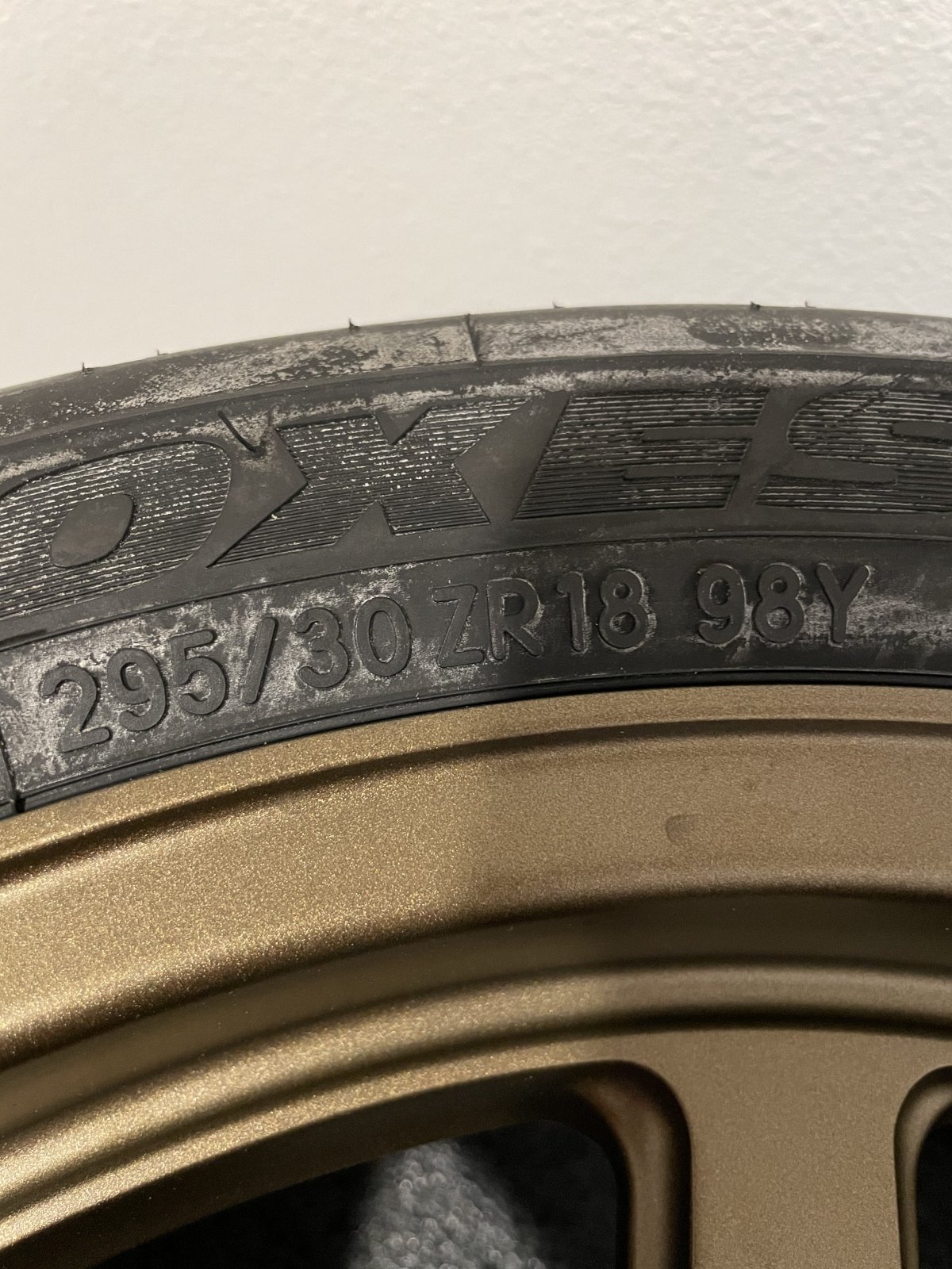

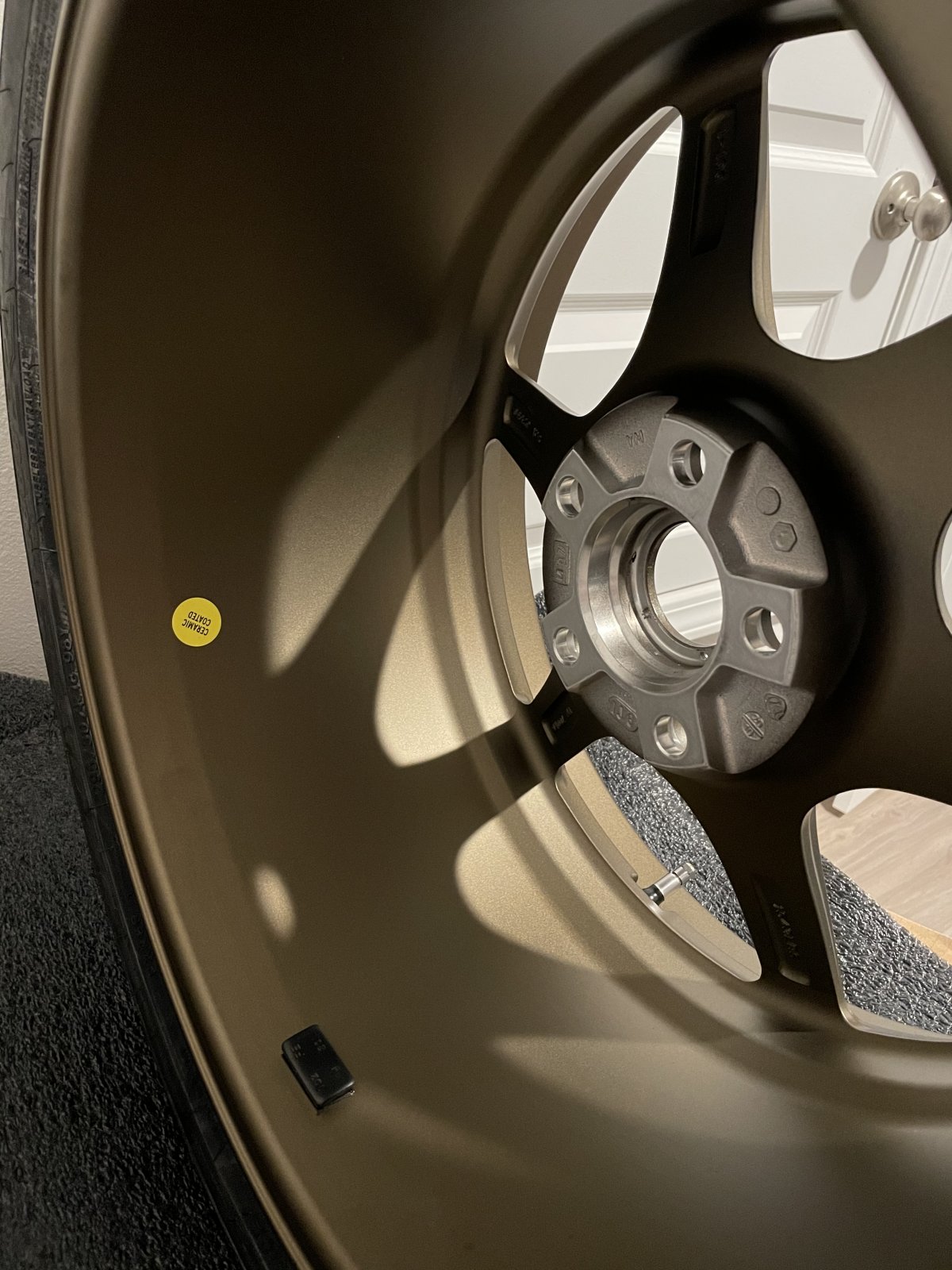

Got some goodies today! Really happy with these wheels! Fitment Industry did a ceramic coat on them before sending them as well. Only issue I have is they sent 12x1.5 wheel bolts, not lug nuts. Gonna have to send them back for the right ones. Not a big deal

Those are going to look nice on the car! What's the offset on those wheels?
18x10.5et18 so I figure a 1” spacer will give me a slightly smaller backspace than the factory wheels, giving me the clearance I need for the struts. The overall diameter of the wheels is also slightly smaller than stock
