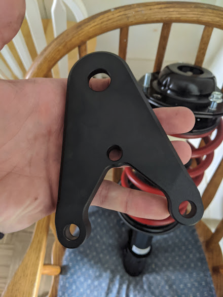

Hey everyone. I'm spending today working on the rear suspension. I'm past the point where the videos end so I'm kind of flying blind. I do have all the manuals for the Cobalt so I'll be referencing that for torque specs and whatnot. My question is... how do I get the rear shocks to attach to this?

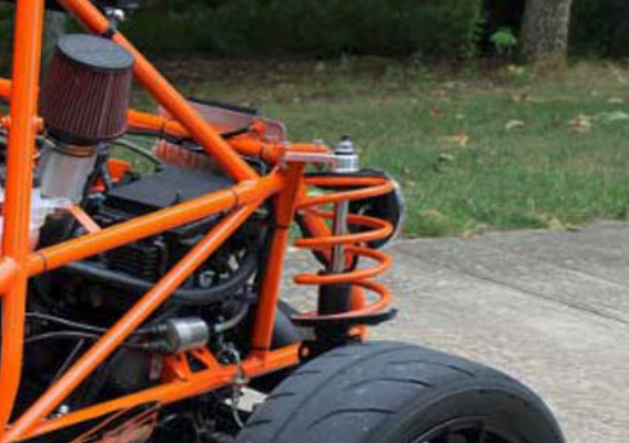

After looking at pictures on various threads I came across this picture of @ctuinstra 's build where it looks like the "cap" is taken off the top of the shock?

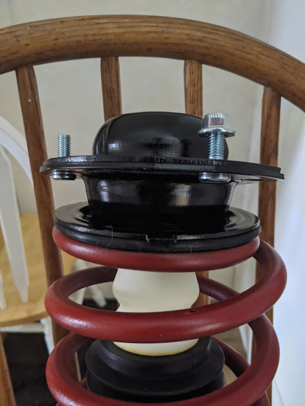

vs mine:
11423
So do I just need to loosen that center bolt and remove the "cap"? Also, I assume I'll need a spring compressor to accomplish this? I've been trying to avoid that as I plasti-dipped the springs as an experiment. I'm afraid the compressor will rip the dip, but if I have to do it I have to do it.

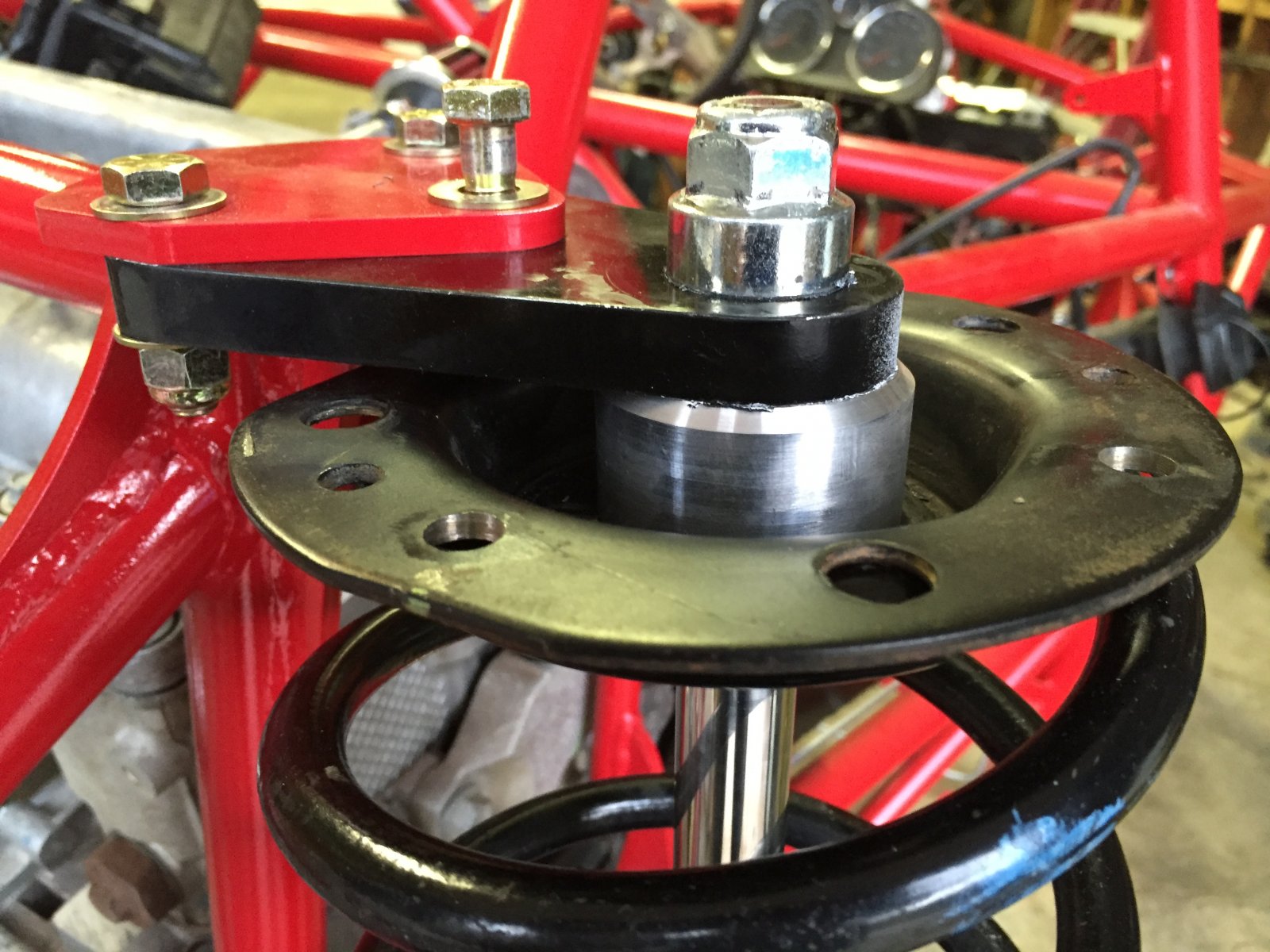

Yes that top cap is removed but there’s also a DF supplied spacer that goes on top of the strut
And I assume the bump stop (I think that's what it is?) gets removed? It looks like you removed the stop and the accordian cover @Karter2026 ? I suppose the front coilovers don't have them so it shouldn't hurt.

I think it would be better to leave the boot. But mine were torn and they looked like crap. I see no problem running them without the boots. If we were out in the salt and snow I would feel different
Waterdriver
You might consider keeping the bumpstop. Especially when cutting the spring. They'll get fully compressed and might want a soft landing when it bottoms out. Running the boots with the bumpstop inside it.
