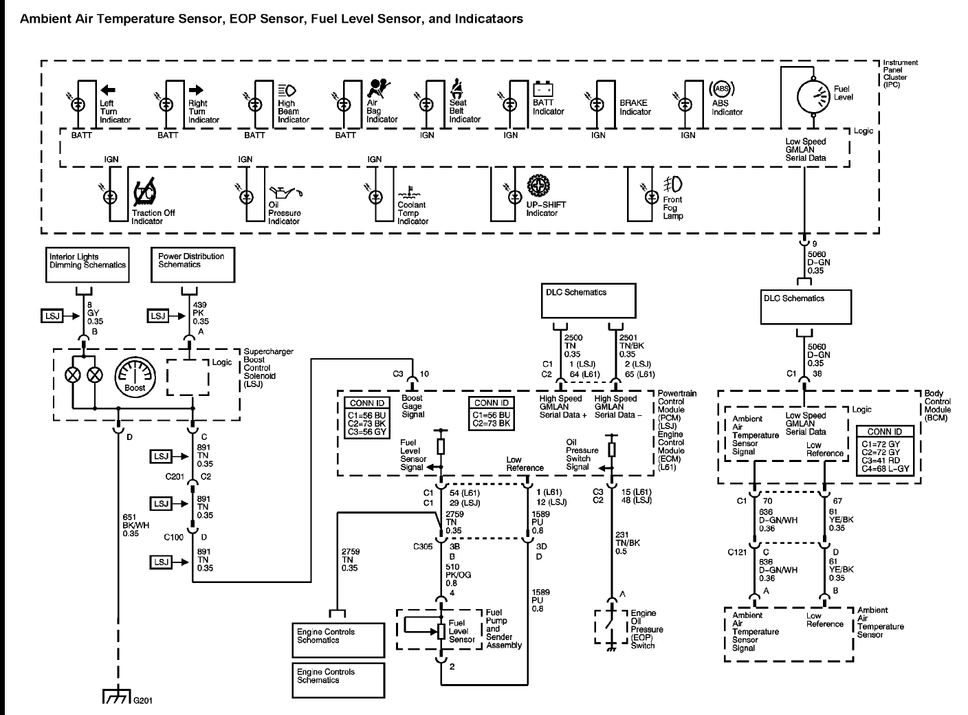

you can view ambient temperature through ODB2 using one of the cheap bluetooth scanners and torque lite app. If you can read the ambient air temp through the scanner perhaps you could narrow it down to your gauge cluster?
Found this diagram for a 2005 but maybe it will help with testing continuity between the sensor connector pins and the BCM (bottom right corner of the drawing)

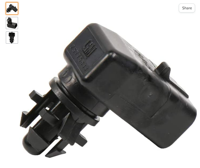

Possibly made a discovery on my Ambient Air issue. I do not have the black units below! I just have a green and blue plug. I must have left that sensor with the donor so a new one is one the way.
36598
Sluggonaut
I think you found the issue - you sort of need the sensor in order to sense the temperature. lol
I imagine this one is commonly missed because it's tucked away in the driver-side headlight housing IIRC. Even after I found it, I think I misplaced it a handful of times prior to actually installing it.
edit: These things are like $2 on Rock Auto. I only know because I looked it up one of the times I lost it.
O'Reily's ended up having one for $6 or $8, so I reserved it for myself and will get it after work. Hopefully that is one minor issue down. A few (and counting) more to go.

Plugged in the Ambient Temp Sensor into the harness and I now have a temperature readout on my dash. For some reason, I was thinking this would be the coolant temperature, so that was why I was wanting to get it. I guess that is in the 'Info' from the readout which my button does not work right now. I'm hoping it's just a faulty button, but I think it might just be in my wiring harness. Also had a new issue pop up. I lost reverse and 5th gear. It seems the shift lever will not go far enough over to grab them right now, so I'm going to just start at zero from the Lonnie instructions. I did fiddle with a linkage when one broke and it's probably from that.
