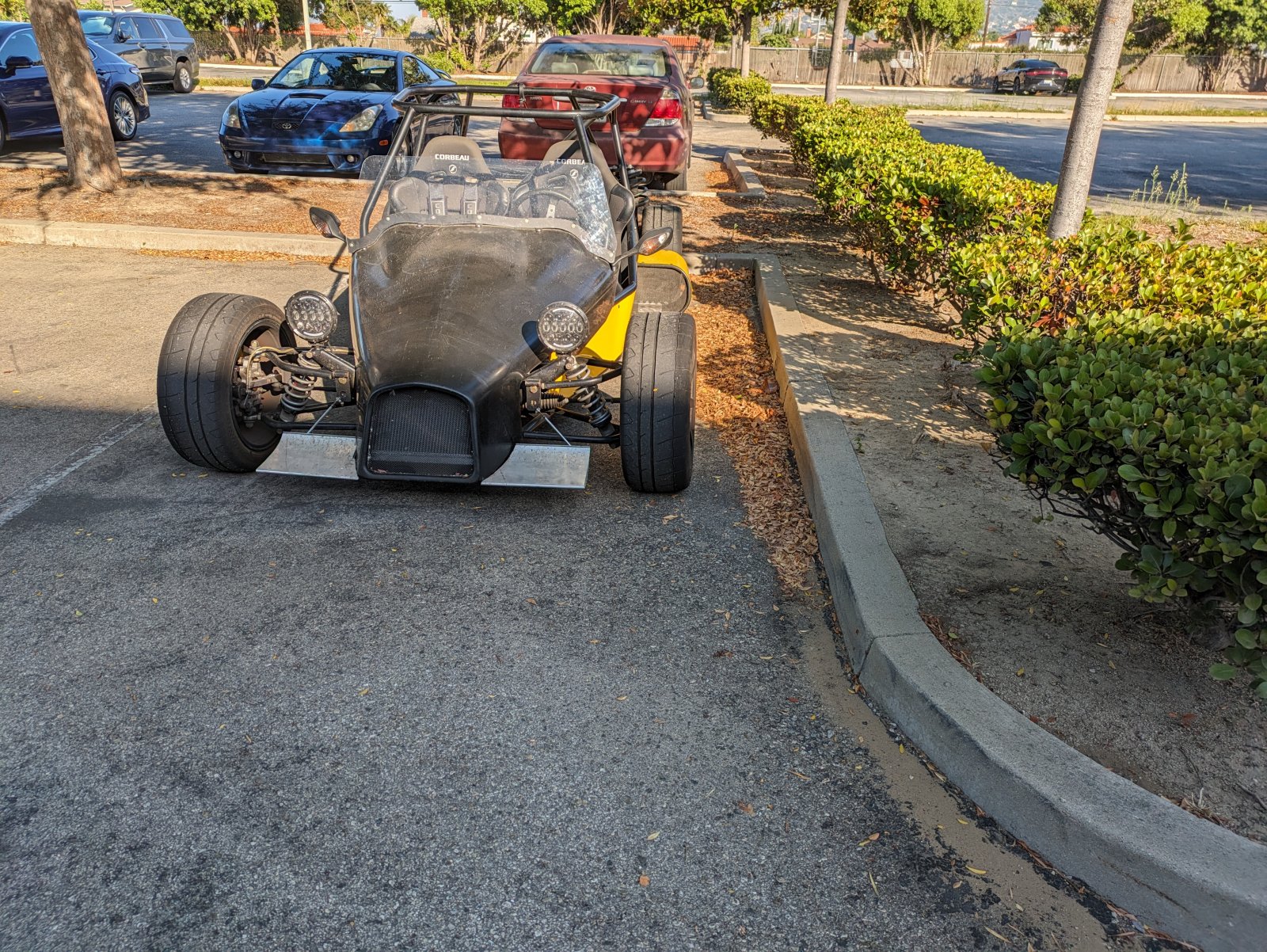

I have seen threads about the cars running hot and needing cooling options. I have the opposite problem. On commutes to and from work it struggles to reach 165. At track days it hovers right around 195. Other than covering up the oil cooler or the radiator, are there any other ideas to keep the engine warmer.

I have an external oil cooler on the side of the car, which would get some air cooling from driving. That is the only change, and why I included the picture.

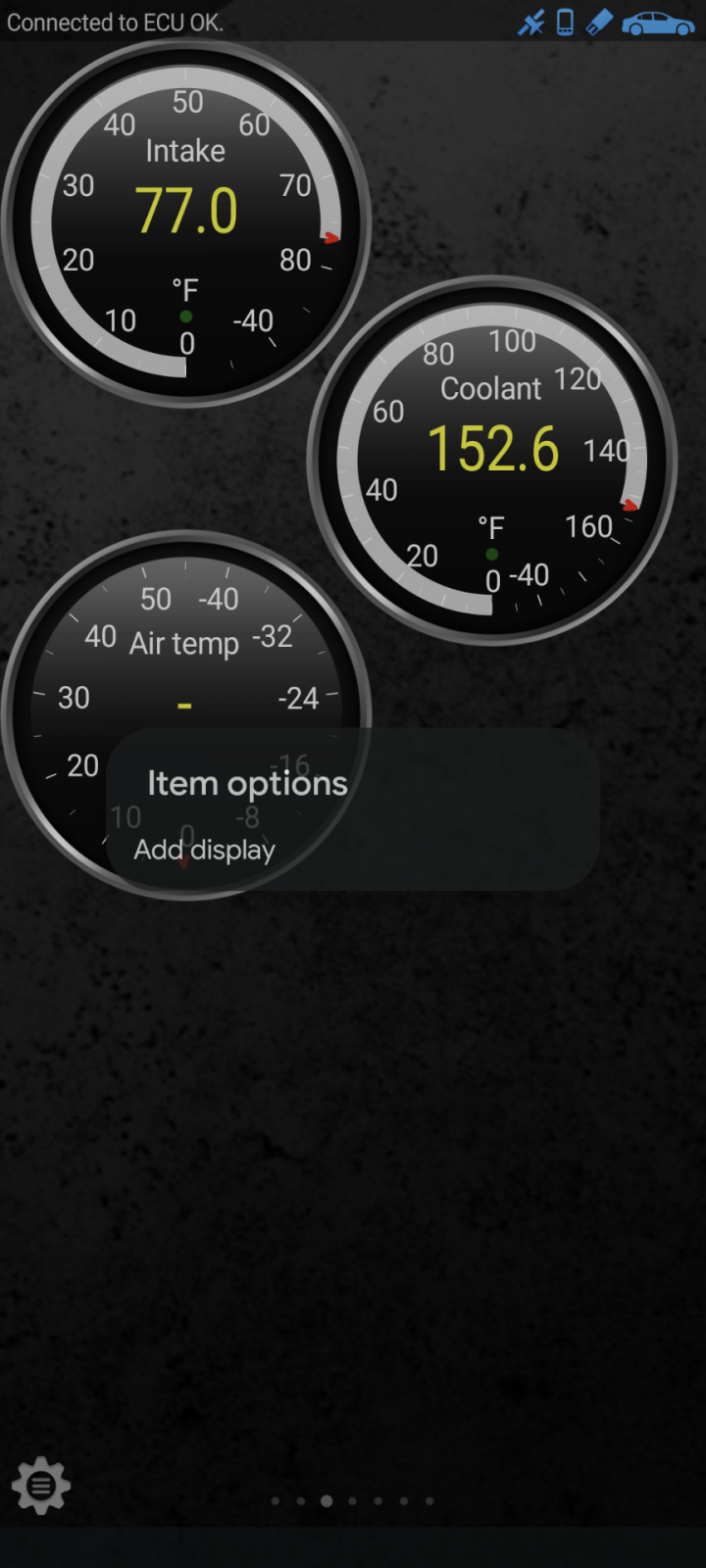

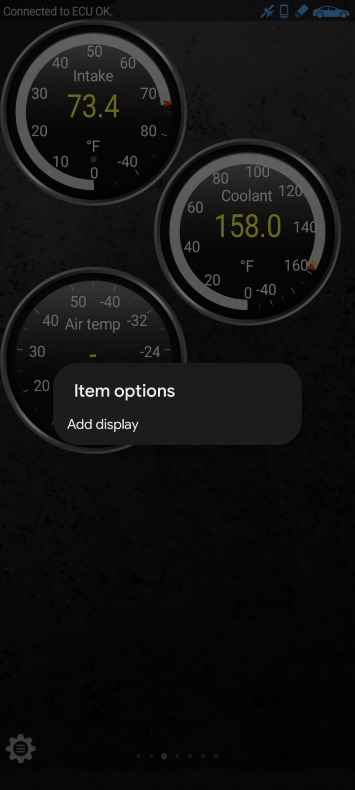

I'm thinking it might be a bad sensor or I'm not getting enough voltage to it. I had two separate 15 minute drives this morning. And the Temp ranged from 151-158. I did replace the coolant thermostat (180) and oil thermostat (200). I felt the coolant pipes and they were hot, and the oil line was warm.

In case anyone was wondering it probably was the ECT sensor. Did a 7 minute drive this morning with the outside temperature being about 72° and my thermostat for ECT was 172
