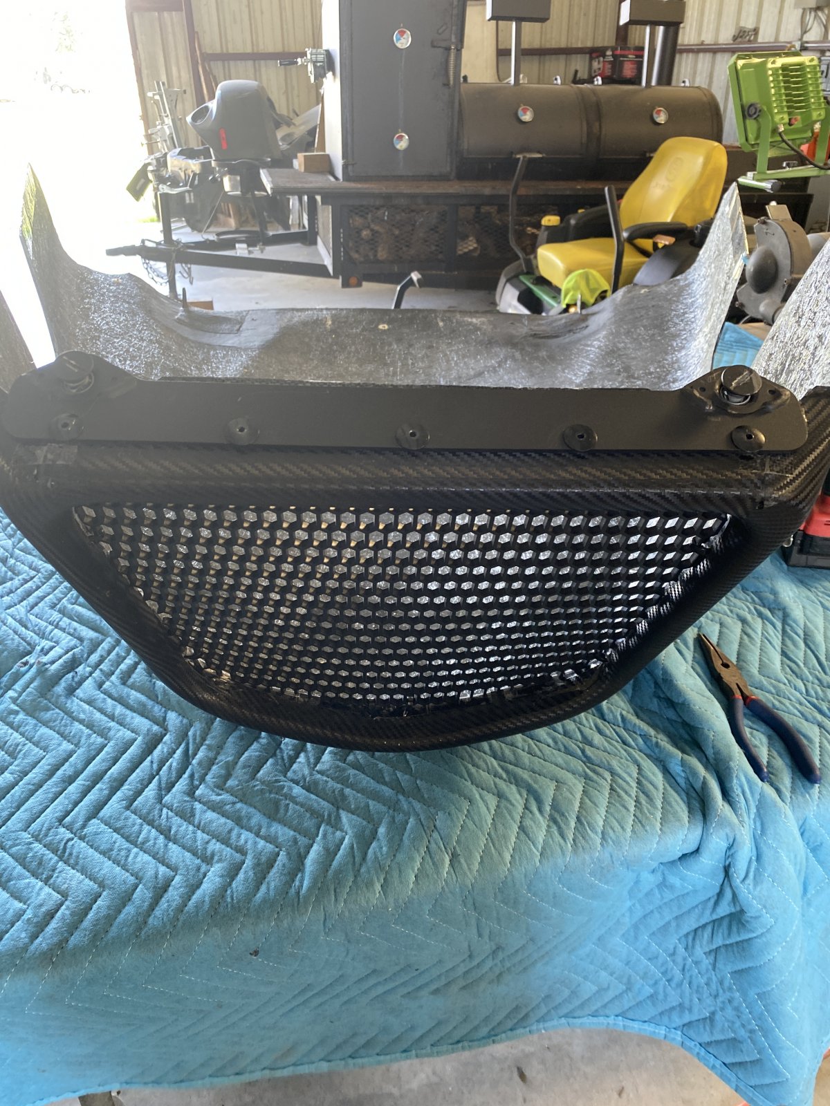

Can anyone share how the hood mounts in the front? Pics?
I see there are quarter turn fasteners welded in up there but the hood is cut to miss them and there are holes drilled in the bottom of the hood like there is a mount plate that would go there but I have nothing of the kind....
No pic for you at the moment but you're correct, there's a mount plate with two DZUS connectors and five rivets that come bagged as part of the kit. If you're missing that baggie, you'll need to contact [email protected].

Yes. There’s a mounting plate that is riveted to the bottom side of the hood with the quick turn fasteners. The mount side of those fasteners are on the radiator sub frame.
Bottom of hood

Where did you get your grill material?
Got it on Amazon. Its a little bit thicker than what others have used, but I like it. Being plastic, it’s still light too. You can make 3 from the one sheet. Room for oppspies.
