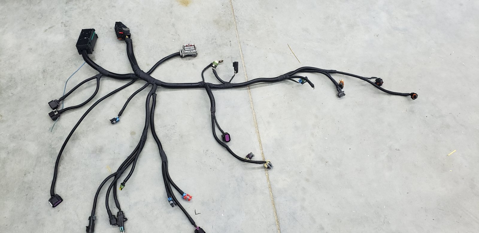

So here is my thinned out engine harness. As you can see there is a couple of feet of various sizes of wire loom. I had to purchase 50ft of each size of high temp nylon wire loom to do this. If anyone is interested in redoing their engine harness I have a bunch of loom to share.
That is one of the cleanest harnesses I’ve seen

Since the loom comes in different colors, would it make sense to 'color code' the different harnesses - engine, body/chassis, dash - using a separate color? Just thinking out loud. :D
The harness in the dash area is too tight for loom and from what Ive seen in build vids it would be tight in the tunnel also. Im using Tessa tape for the harness,, May add loom to the engine bay area for chaffing.
And all I could find in high temp was red and black.
