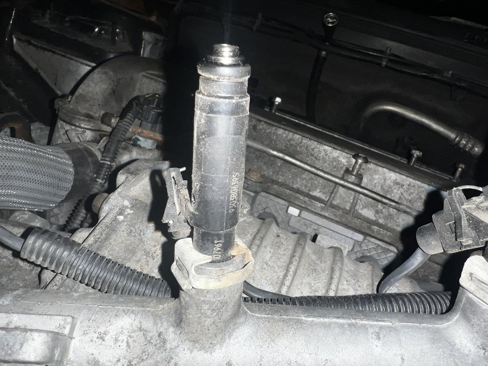

I didn’t have time for another leak down test but I pulled the injectors…surprisingly easy. Injectors installed seem to be 60# injectors. They are Deka 107961. (Picture attached)
I vacuumed off the area and reinstalled. Started it back up and put a screwdriver on each injector to listen. They all sounded the same and consistent to one another.
The previous owner did say it needed a tune but I still need to solve the issue of cylinder 1. As I mentioned I have a head gasket and a valve cover gasket kit coming. I’m going to hold off on the head gasket until I have the engine pulled and start with the valve cover and spark plug O-ring gaskets and see if that fixes my issue with leaky cylinder 1.
This weekend I will try to find a bore scope and get some pictures of each cylinder for further diagnosis.

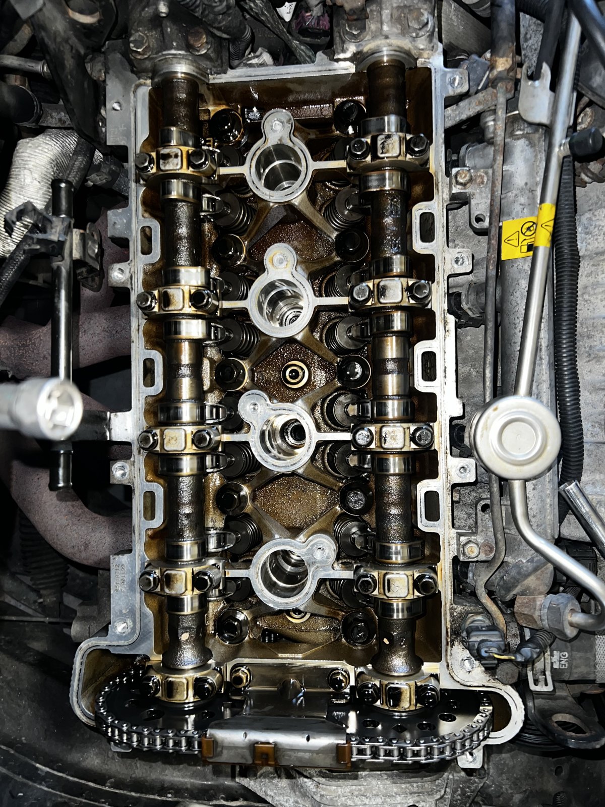

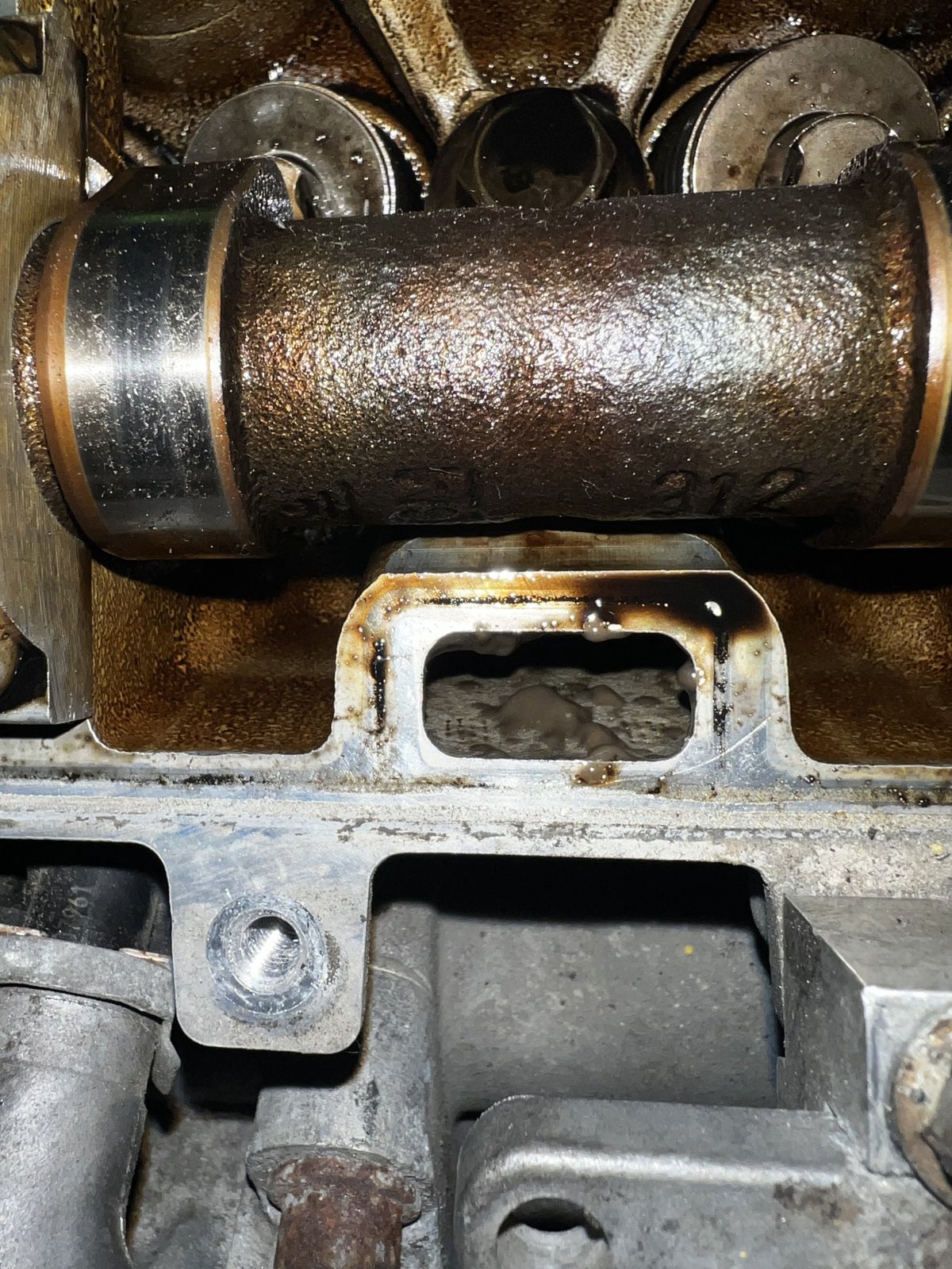

Pulled valve cover to replace gaskets and noticed milky sludge in the front right rectangular port closest to the front of the car. When everything was back together cylinder 1 passed but cylinder 4 now fails a leak down test. I am puzzled.
Running to get a scope now to look inside.
Air now leaks from cylinder 4 to cylinder 3. Just like it was on cylinder 1. I also noticed air coming from dip stick and the hose connection on the top left back of the engine leading to the intake.
