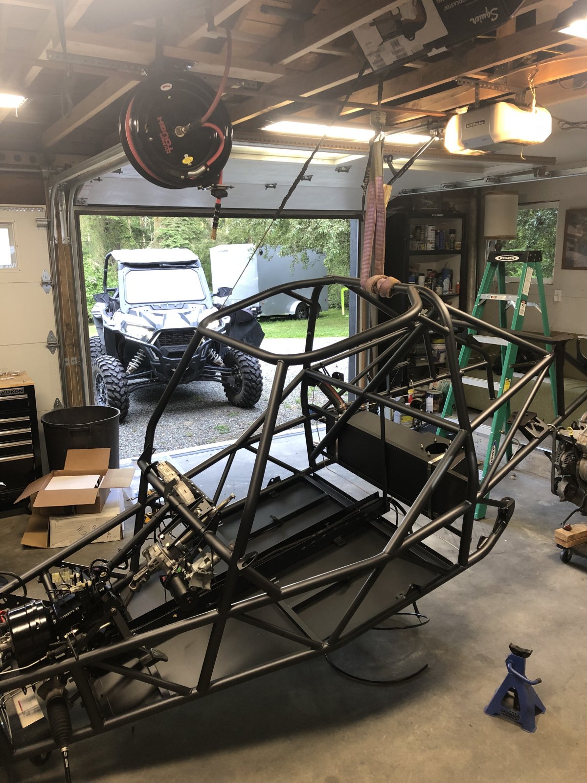

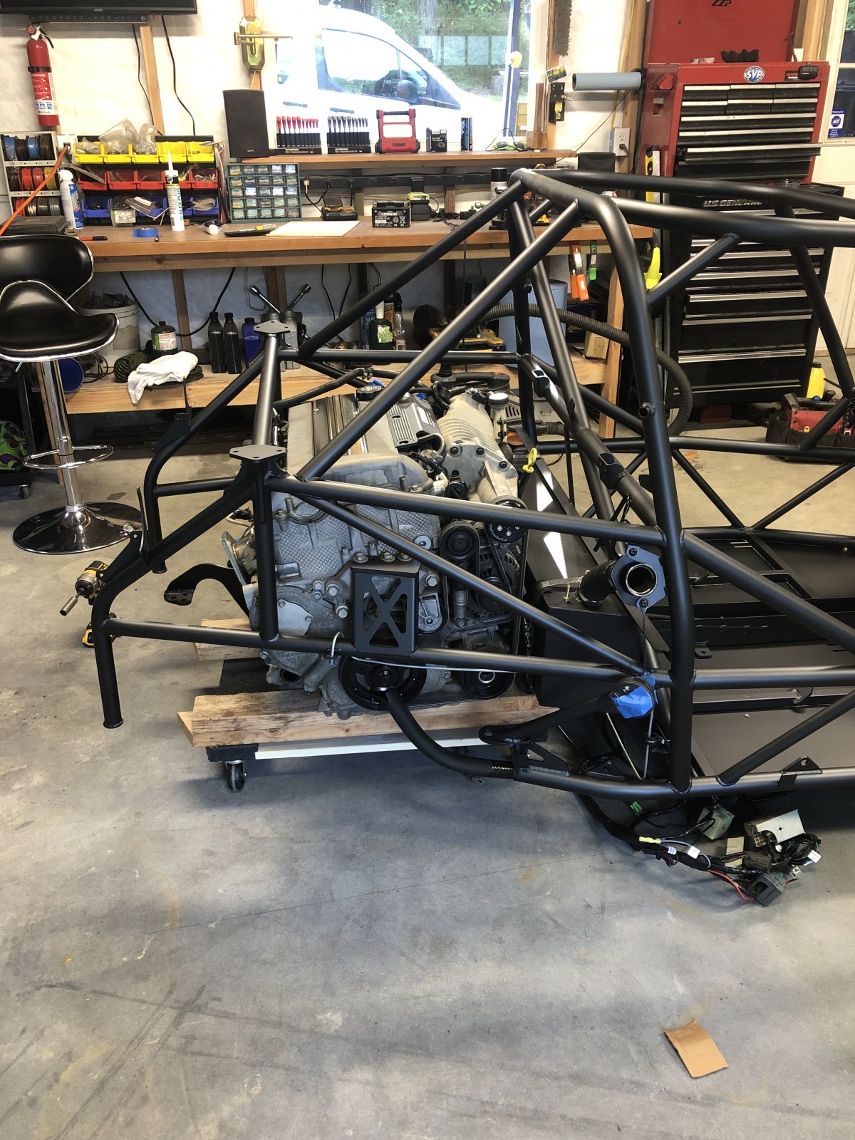

Reason 269, why it’s important to own a side-by-side. Didn’t have a buddy available so I used the winch to lift the car over the motor.

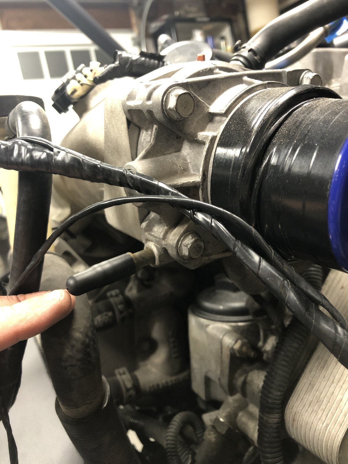

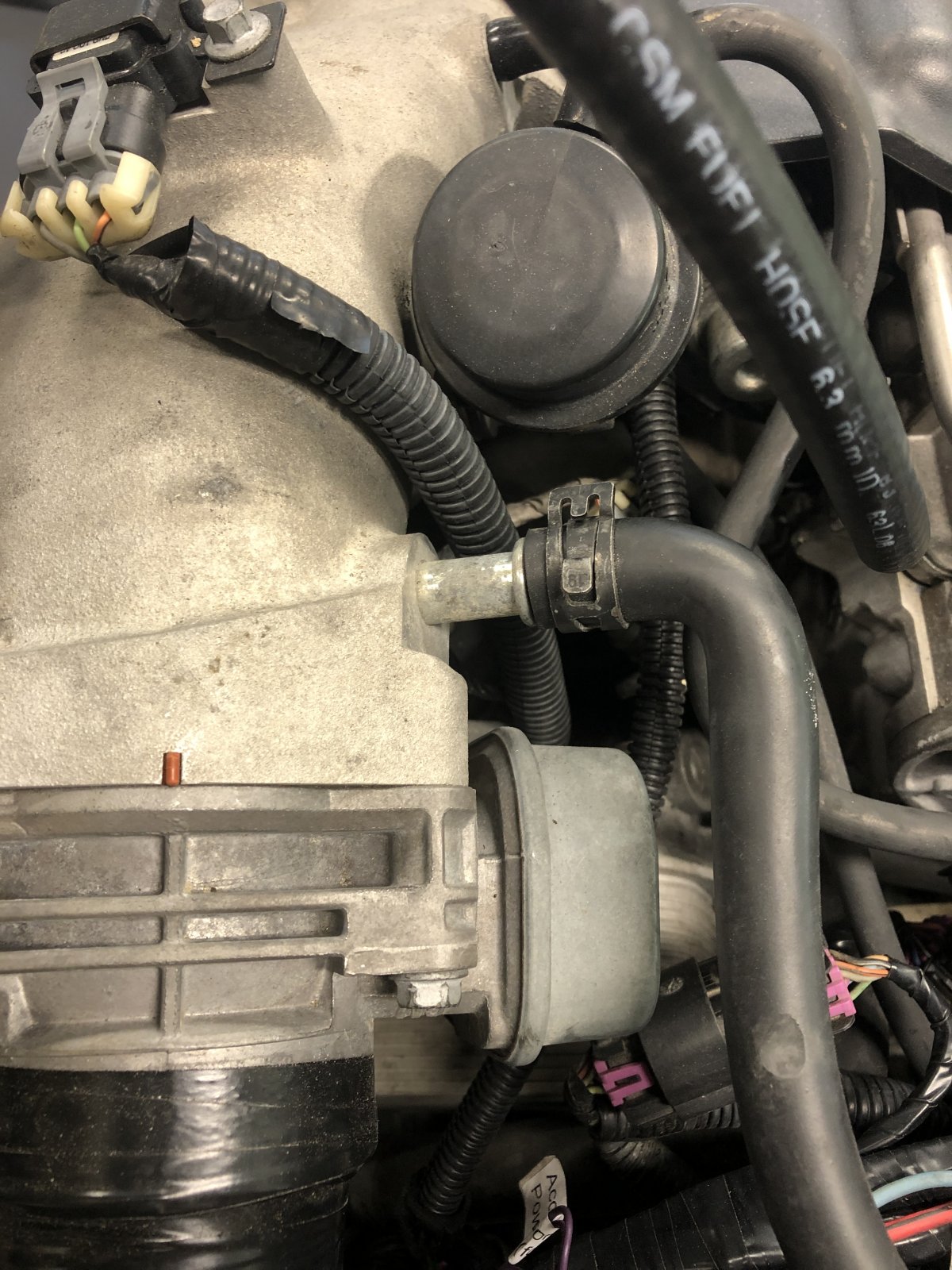

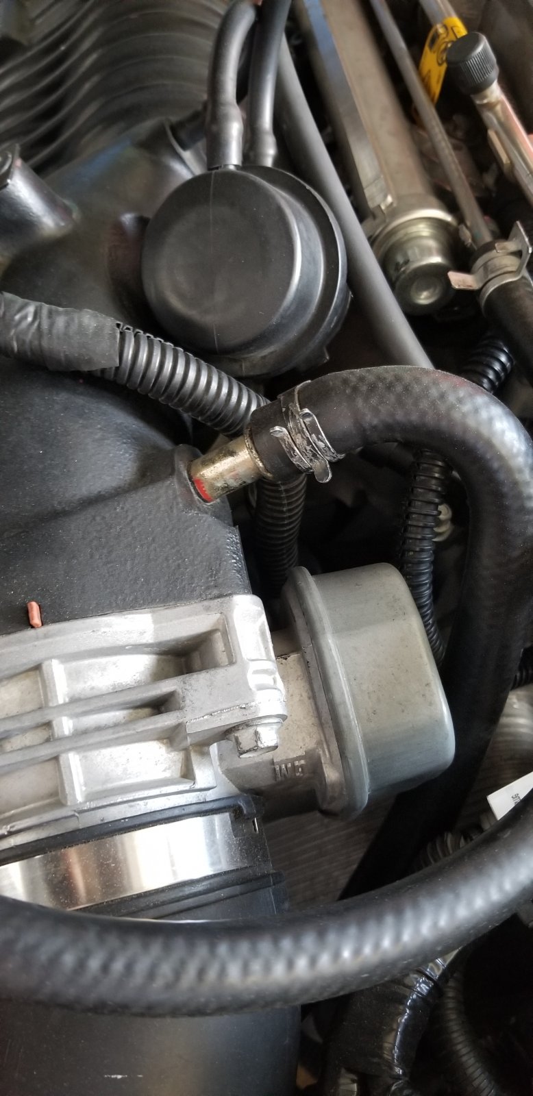

I ran the brake booster vacuum line to this port behind the throttle plate.
OK, I believe that is the one that normally routes around to the valve cover. Did you end up using the stock fuel pump? If I remember correctly you have the exact same donor I do, 2005 SS. My fuel pump doesn’t have the standard plug in the top, it has kind of a harness that comes out of it. I’m considering buying a new fuel pump and I’m curious if I can just get the standard for a 2.2.
Waterdriver
Yes, used the SC stock pump and re-used the pump power plug by modifying it. It wasn't difficult and if I need to replace the pump I know I can stick with the '05 style pump.
Link to my post on it:
Whidbey Goblin
So it seems like I should use this port for my power brake booster vacuum line. My question is, where do I run the line that comes from the valve cover?

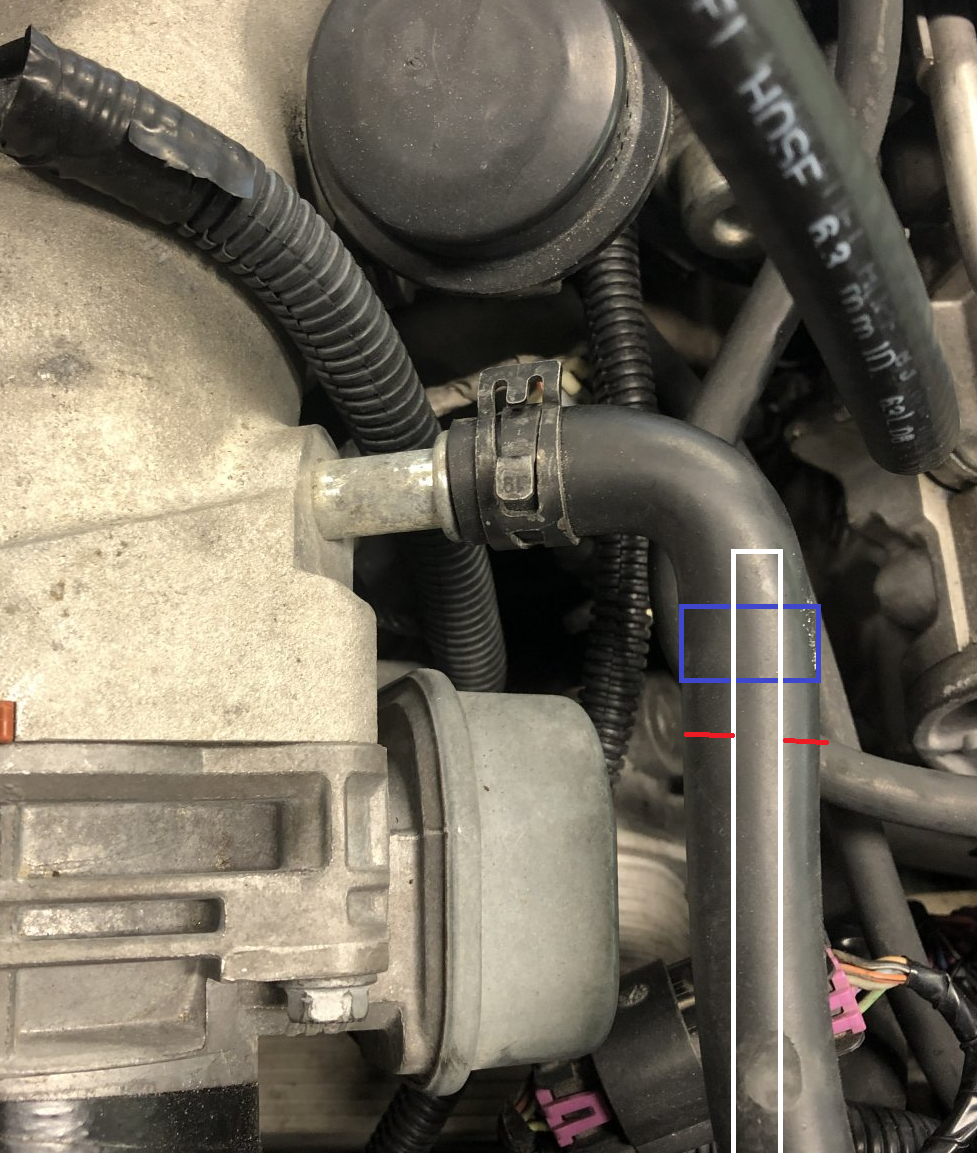

I cut the black hose at the red line, then inserted the brake booster line (white) into the black hose, and put a hose clamp (blue) on it real tight, to shrink the black hose down onto the booster line.
24756

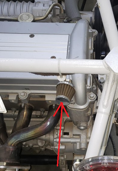

I removed the valve cover hose, and put a small filter on it. If you are running stock boost this works well, but if your boost pressure gets too high, you might want to run this to a catch can, otherwise this filter will start leaking oil out the bottom. Up to you if you want to run these fumes back thru the intake, and get that gunk all over your intake parts.
24757

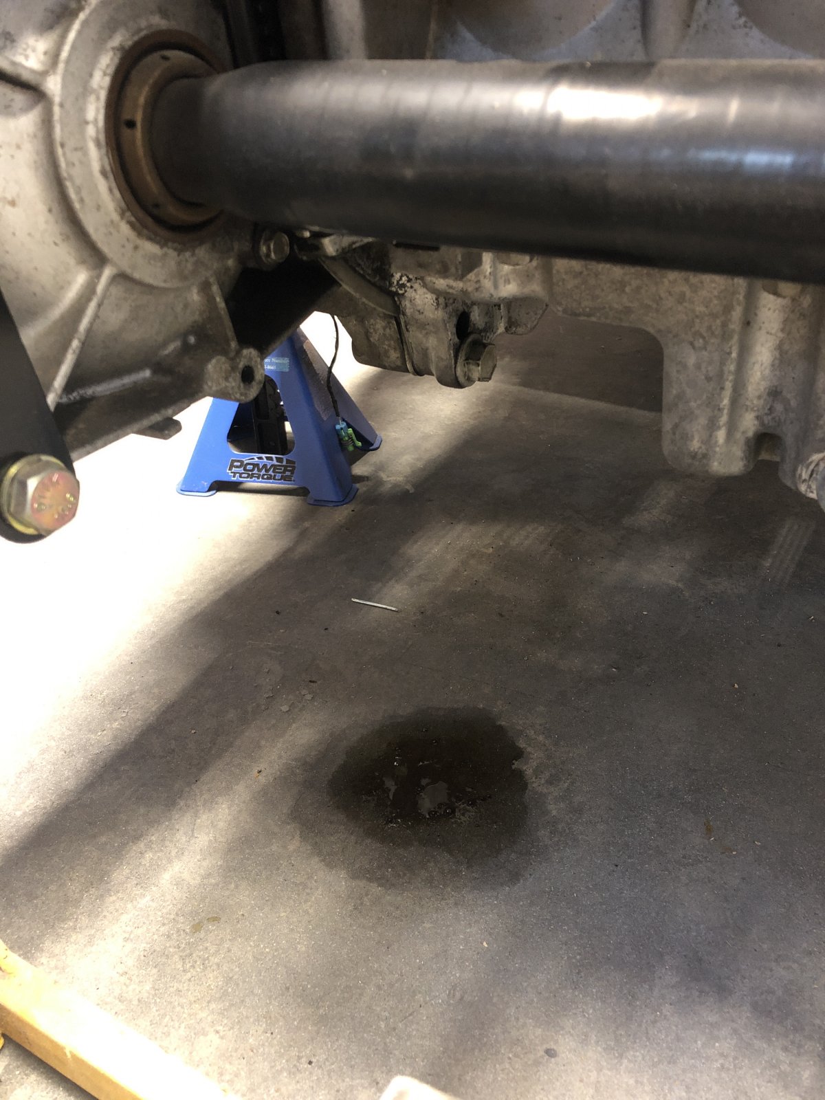

So my first start was good, I ran it for probably 10 minutes. Started it again yesterday for a couple of friends that came over to check it out. Now this morning I have a puddle of oil underneath it. Appears to be coming from between the engine and transmission. Rear main? Just the oil Pan?

Waterdriver
Is it engine oil?
Or is it transmission?
I had a little leak, a spot the size of a quarter and ID'd as tranny oil. After it made the two spots it hasn't leaked since.
Whidbey Goblin
It does not smell like trans fluid. My dip stick reads over full but I only put 5 quarts in it and the car isn't sitting level. I’m kind of wondering if the stress of running it with only the two motor mounts could’ve created a leak at the oil pan. I did hook up my power brake booster vacuum line between the first start and this last start. So this last start didn’t have any vacuum on the vent line at the valve cover. That would be the only difference.
I would finish the Goblin and as long as the oil leak is not too bad drive it for a while. When the engine gets up to temperature a few times the seals will soften and conform better which might solve the leak problem. If it doesn't at least you got to drive enough to test the clutch and know if anything other problems need to be addressed while you are in there.
