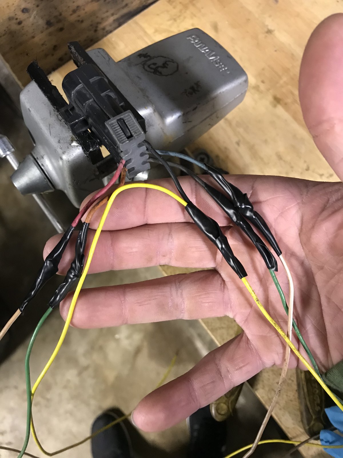

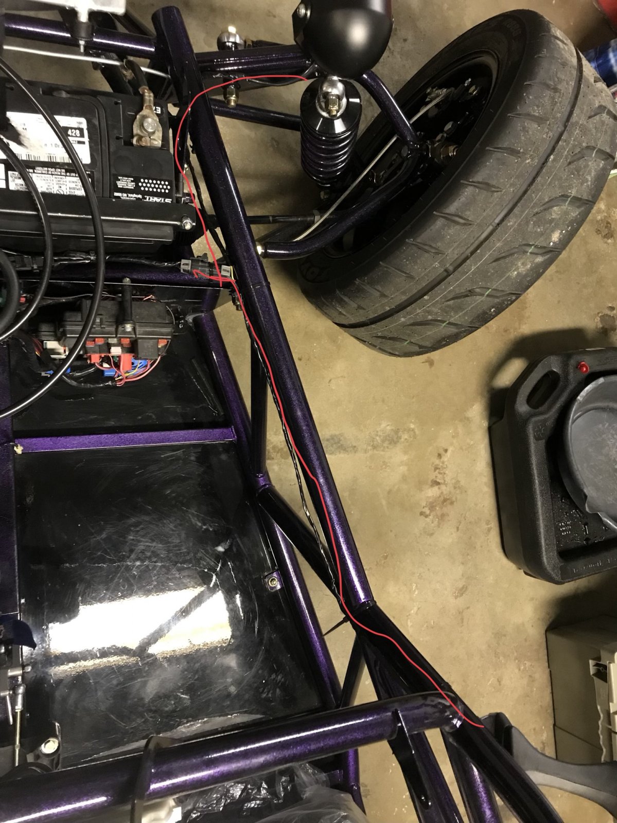

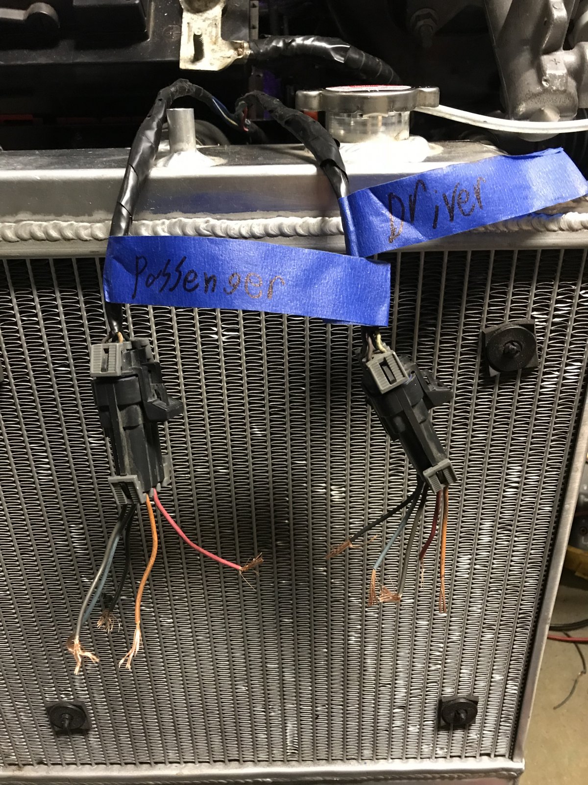

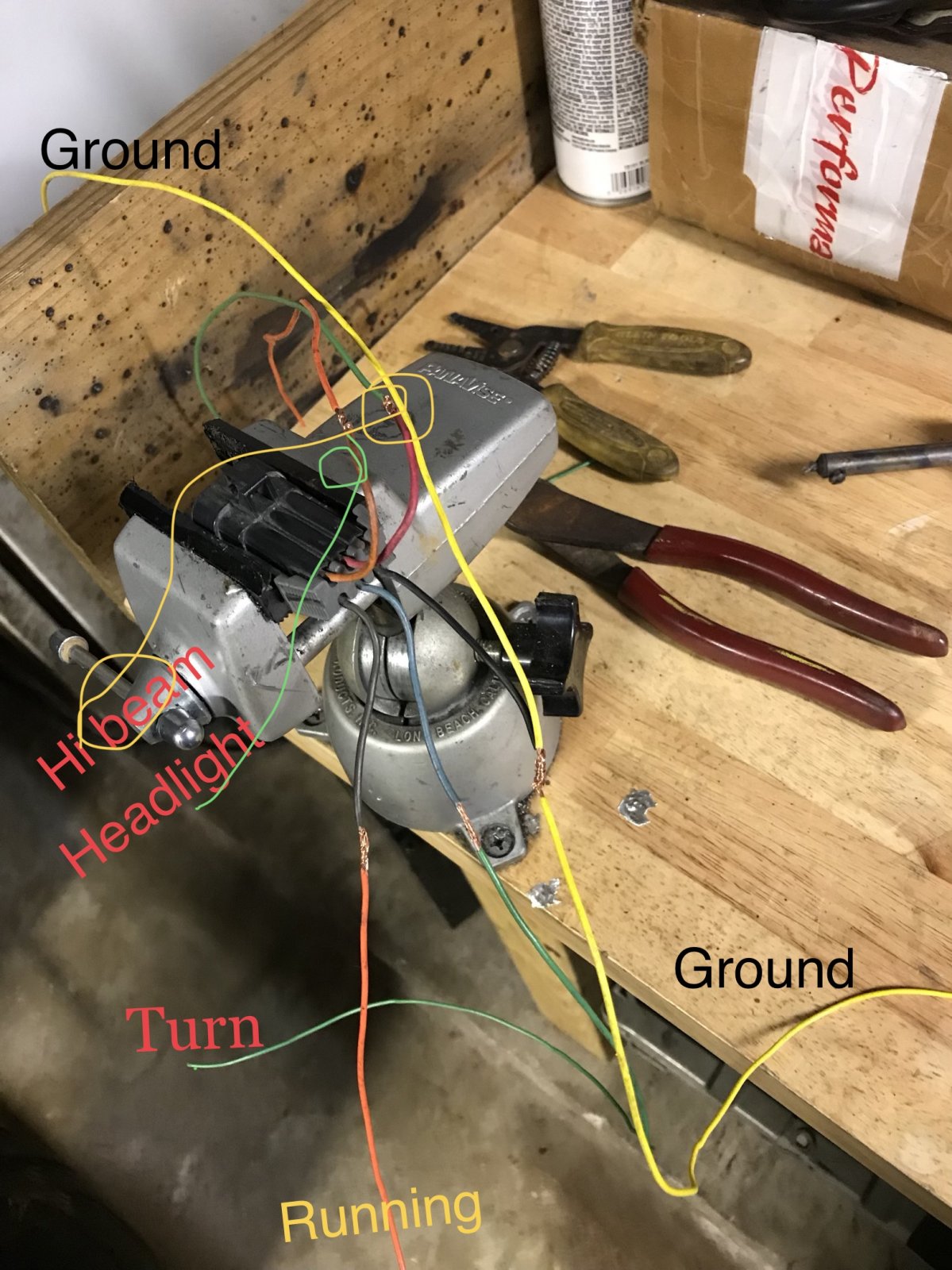

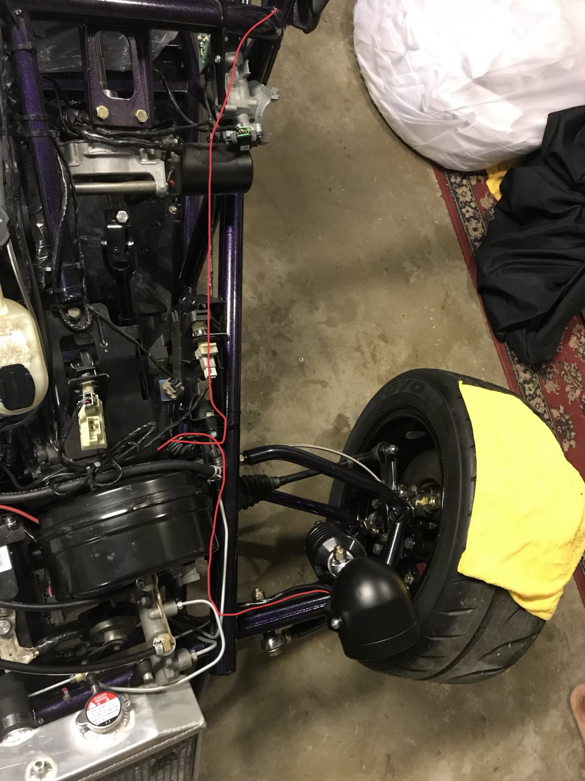

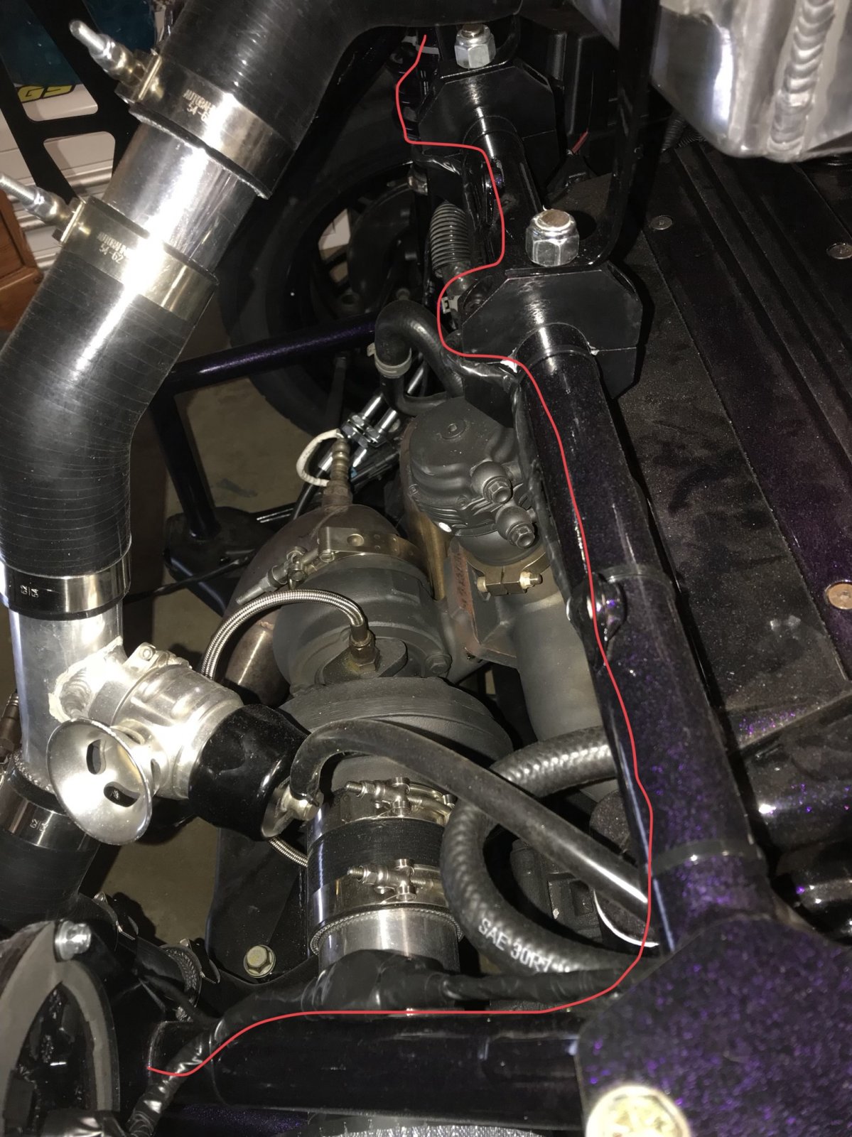

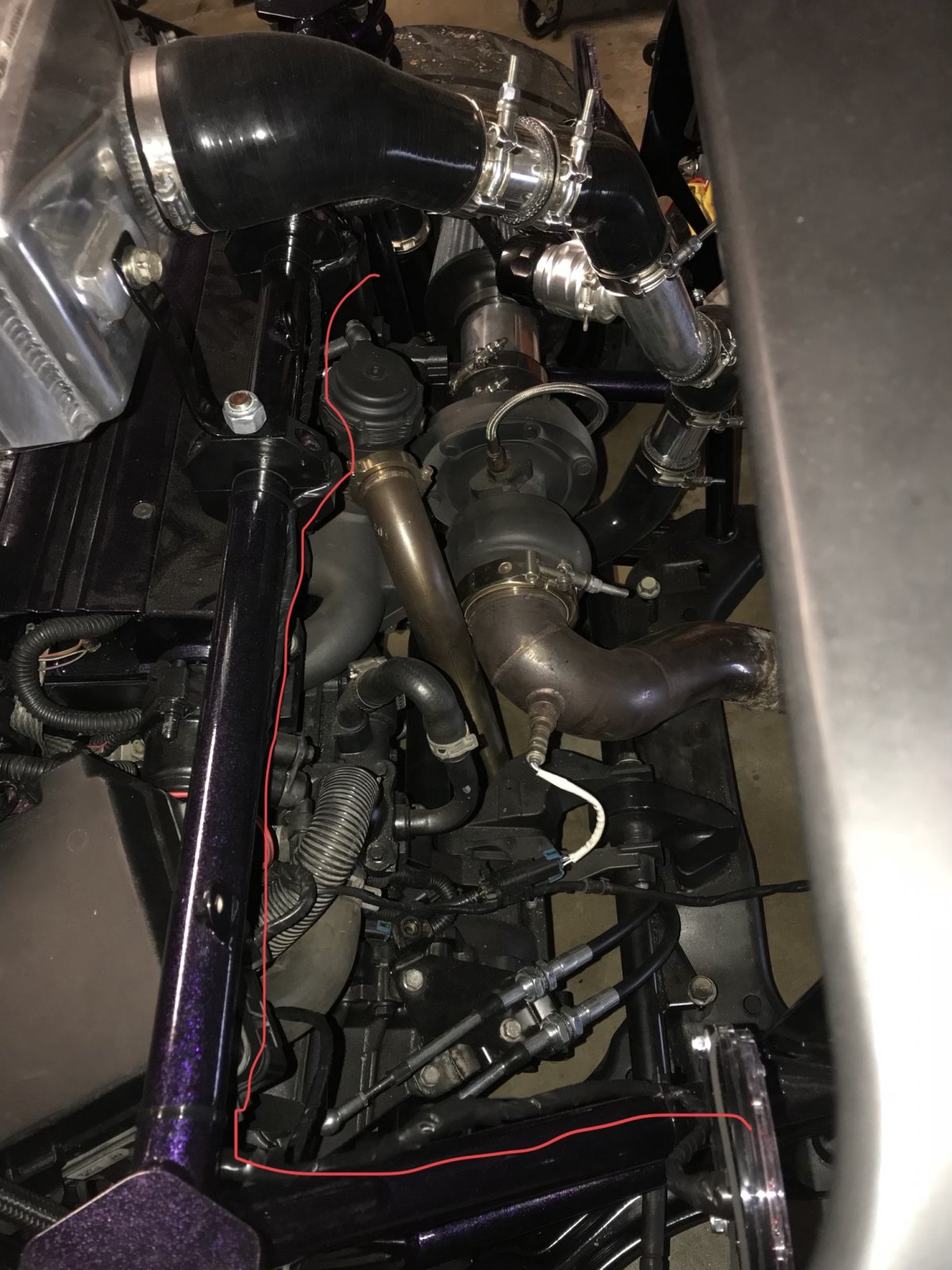

Well I finished all of my lights last night so here’s a few pics. Just wanted to show everyone how I ran them, and label the headlight plug for anyone having trouble
Would somebody be willing to post up the wires involved with the stock DF headlights and turn signals? I have the source side figured out so I'm just looking for the destination side. It looks like Rob covered the tail lights already.
I'm trying to get wiring finished up so I want to make sure I ran all the wires I need beforehand.
