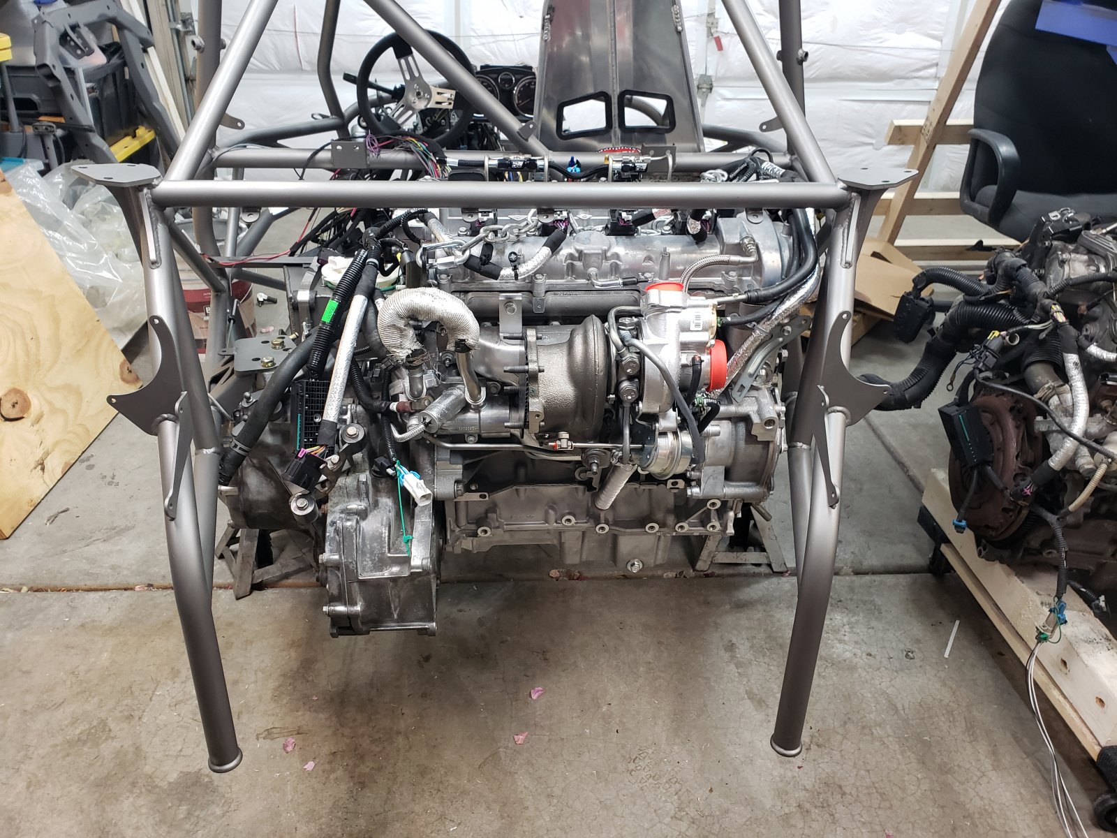

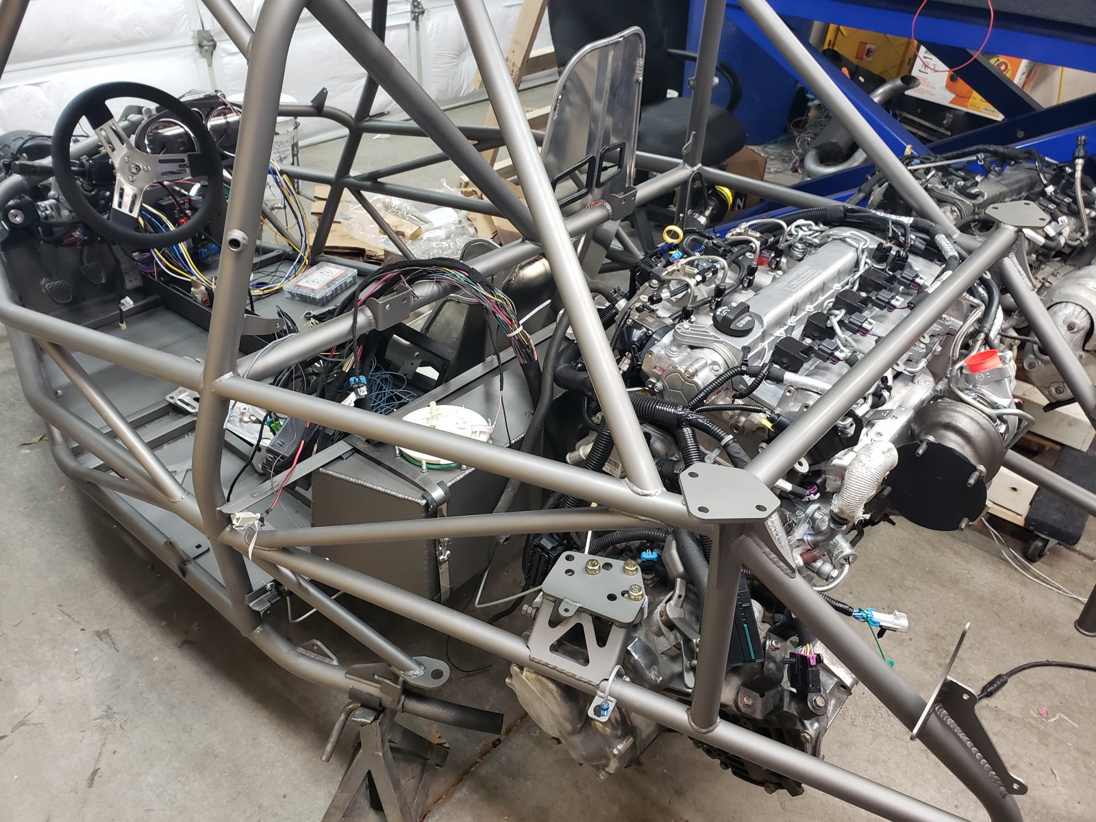

Engine install is next. Just starting to dig into the ATK motor to figure out what the differences are.

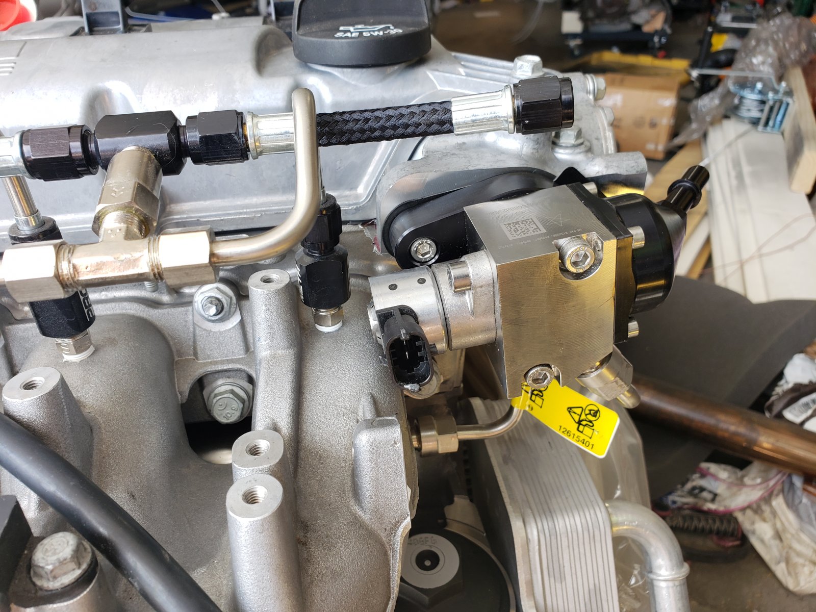

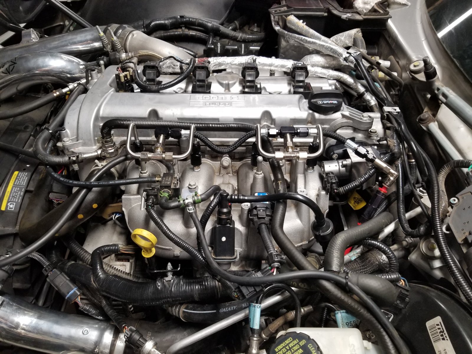

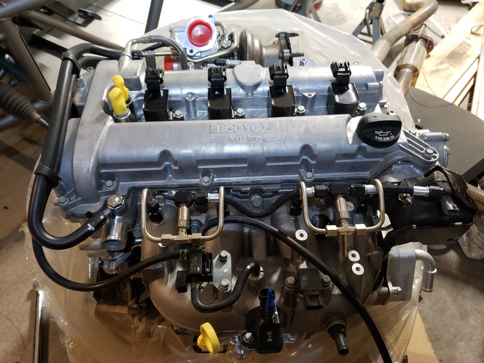

I was just looking at this port injection setup! Looks fantastic.
Was the meth port injection a direct install or did you have to adjust the nozzles to line up with the middle of the runners?
What nozzle size are you running?
Straight meth or mix?
Are you taking it somewhere for the tune? If doing it yourself, what is the approach when introducing meth? Higher timing and less fuel by a %, starting to spray at 18psi etc.

I sent the intake manifold to Rodney at ProMeth and he did the installation. This is the setup I ran on my Solstice. I originally ran a single nozzle right before the throttle body which worked fine but I was chasing a little bit of intermittent KR that would show up on isolated cylinders. I was hoping the direct port setup would even things out and take care of that but it didn't really make a difference. I got a great deal on a couple cases of Boost Juice a while back so I still have a bunch of that.
The tuning was done by Matt at ZZP. I used a progressive controller that turned on at 15psi and went to 100% at 30 psi. Matt just tuned it with that running in the background.

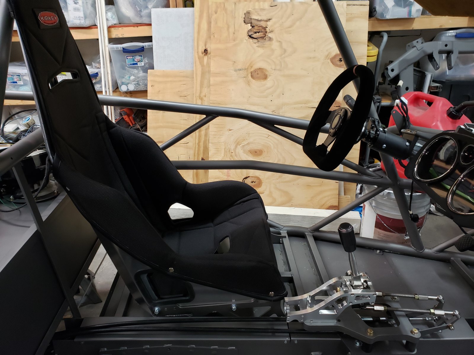

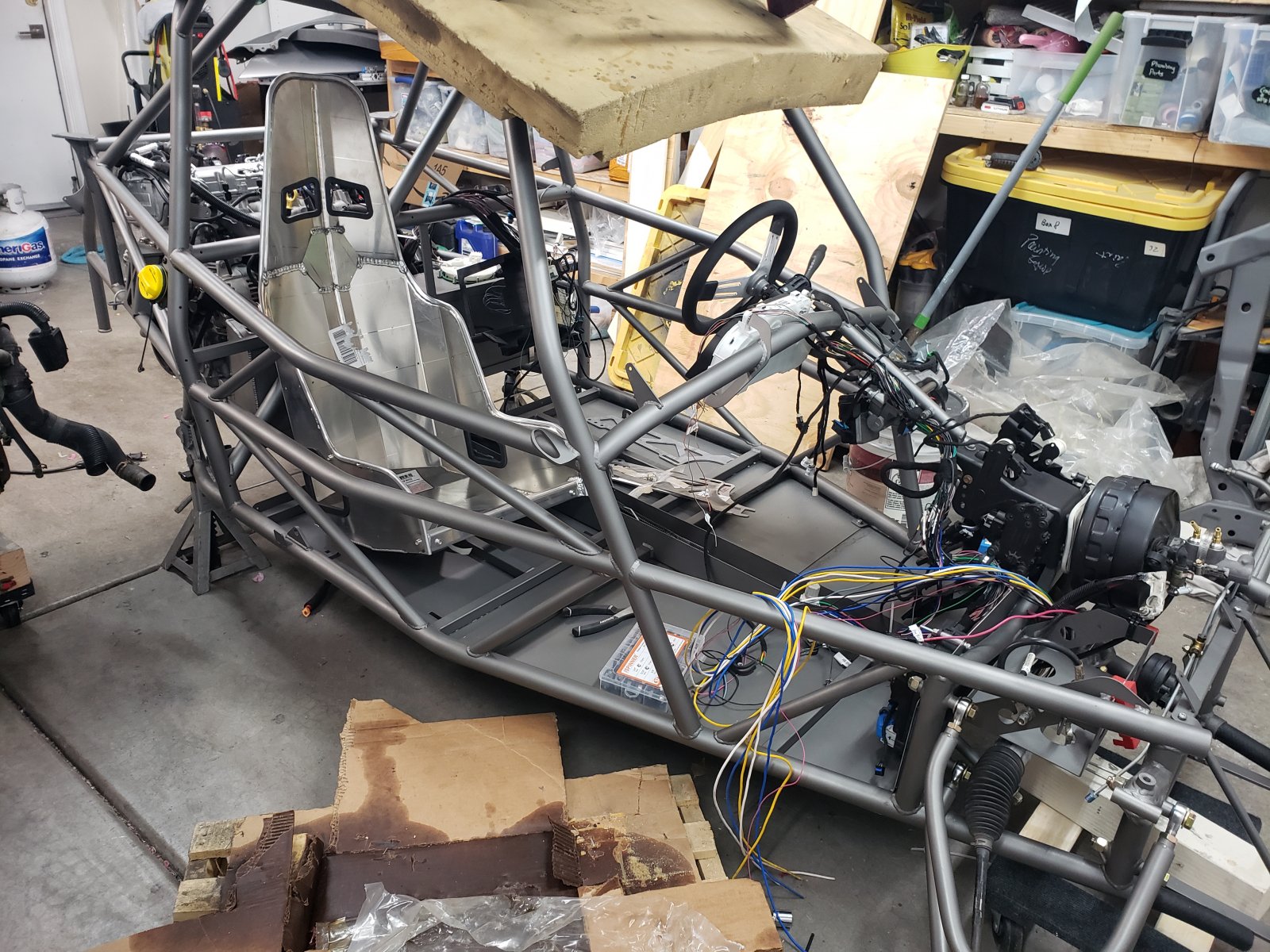

As a side note on the Kirkey seat install, the DF seat mounts work great. I have the 17" wide seat and it fits perfectly with the mounts in the middle width configuration.
