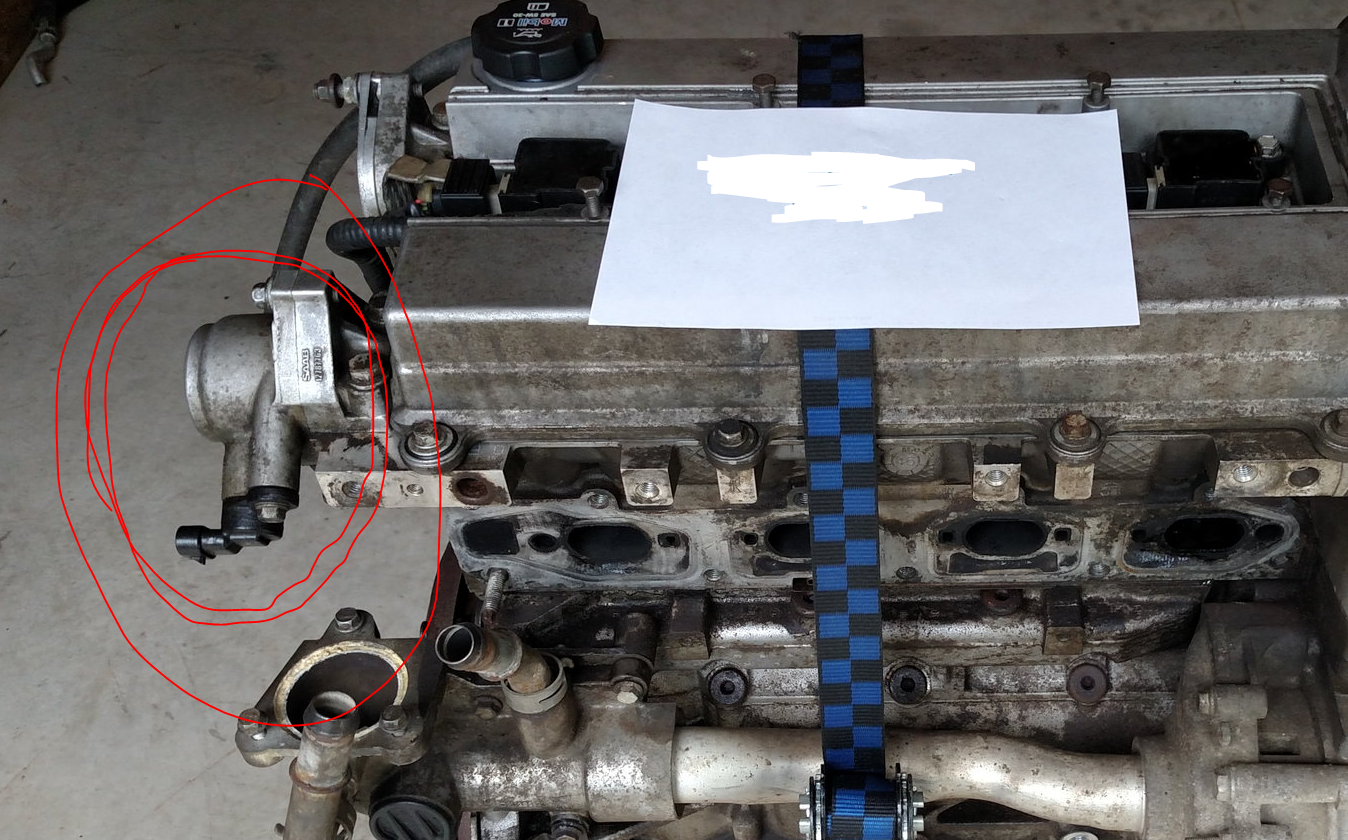

I think I'd probably start by checking the cam position sensor. I believe you set the engine to TDC on the compression stroke of cyl4 and then align the cam position sensor marks. Mine was misaligned once and it made starting the car very difficult!

FOZDA, my research and chilton manual is showing I have a crank position sensor but the cam position sensor appears to be 2008 and later?? Am I over looking something?

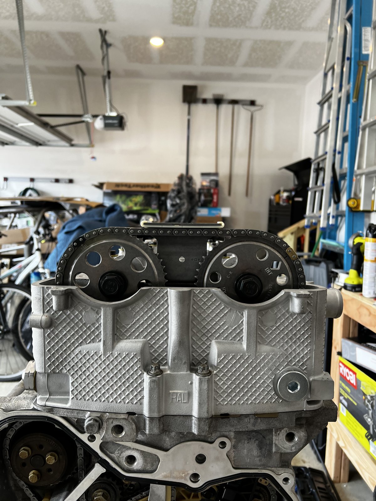

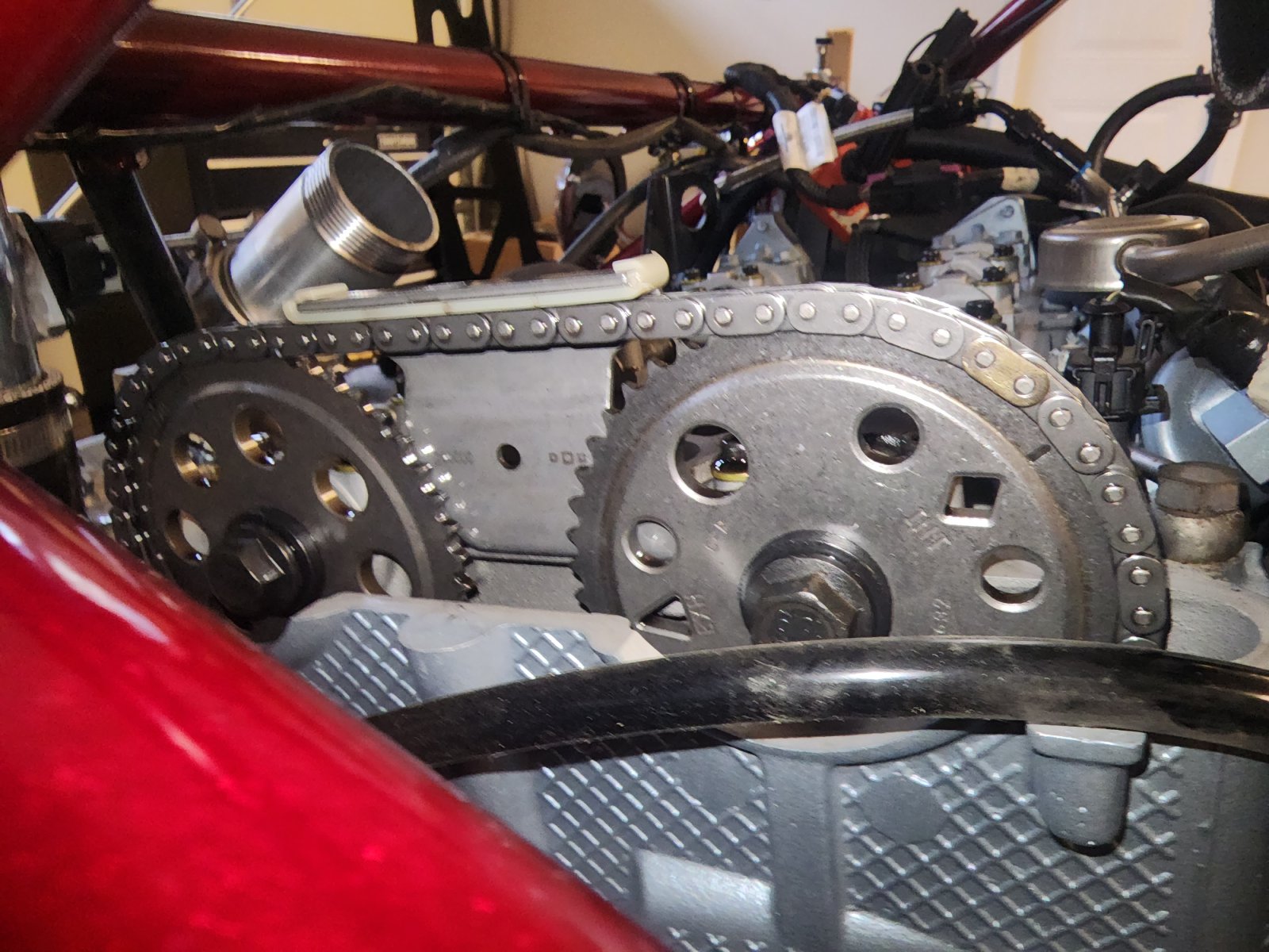

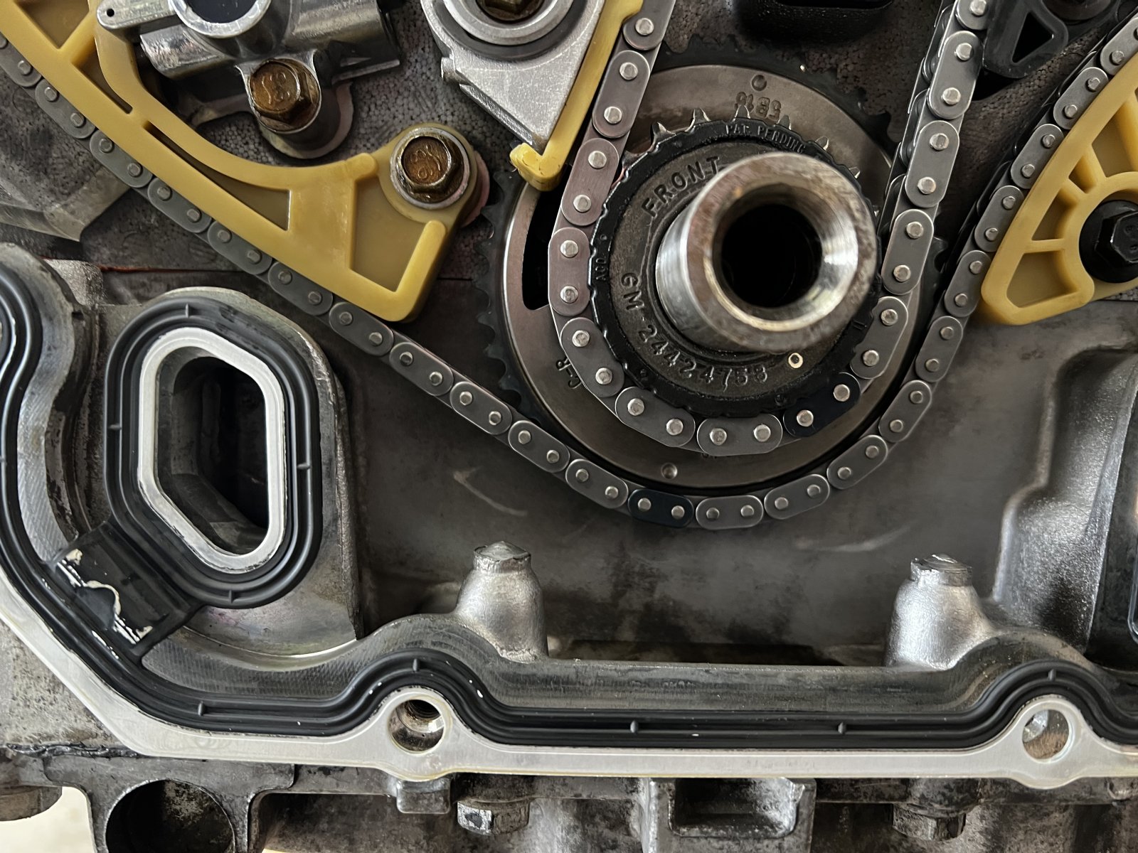

Can someone confirm the unique colored links and alignment marks do or do not line up on every rotation. In one of the previous post in this thread a member stated they do not line up the same on every rotation and only for initial alignment??
It does not seem logical if the do not line up on every rotation. At this time the chain is off the alignment marks by 2 teeth at EXH, IN and crankshaft. See current pic below. Also see original builder photo showing the unique link and alignment marks are lined up.
Regardless of the 2 teeth possible misalignment the 12 oclock and 5 oclock at the crank and the 10 and 2 positions on the camshaft sprockets do appear to be in the proper positions.
Conclusion regarding the timing is I feel the timing alignments at the 3 points (crank and 2 cams) is proper and correct.

I did feel around in the oil pan since the engine cover is off and did not find any bits and pieces resembling metal or plastic.

I've never seen my marks line up again after initial timing. I'm sure it does again eventually but I have no idea how many rotations it takes to get back to it.

Very Helpful,,,,,,I was getting a little OCD over it. I will start putting things back together and look at the cam position sensor next.

After doing a few of these kits for timing sets at this point, I can confirm the initial alignment is where you'll have everything line up perfectly. Unless of course you're lucky and happen to hit the magical revolution where they line up again (some amount of math can figure this out, but certainly not a number you would hand crank over to). If it did line up at first glance, I'd buy a lottery ticket. If you don't trust it, you can always go through the motions of taking it apart as if you had a new set, and re-installing it (also learned this a few times too).
