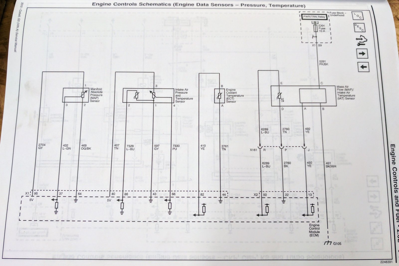

We found a broken wire going to the MAF sensor on our turbo car. It was broken right next to the MAF connector. Here's the schematic for the MAF wiring:

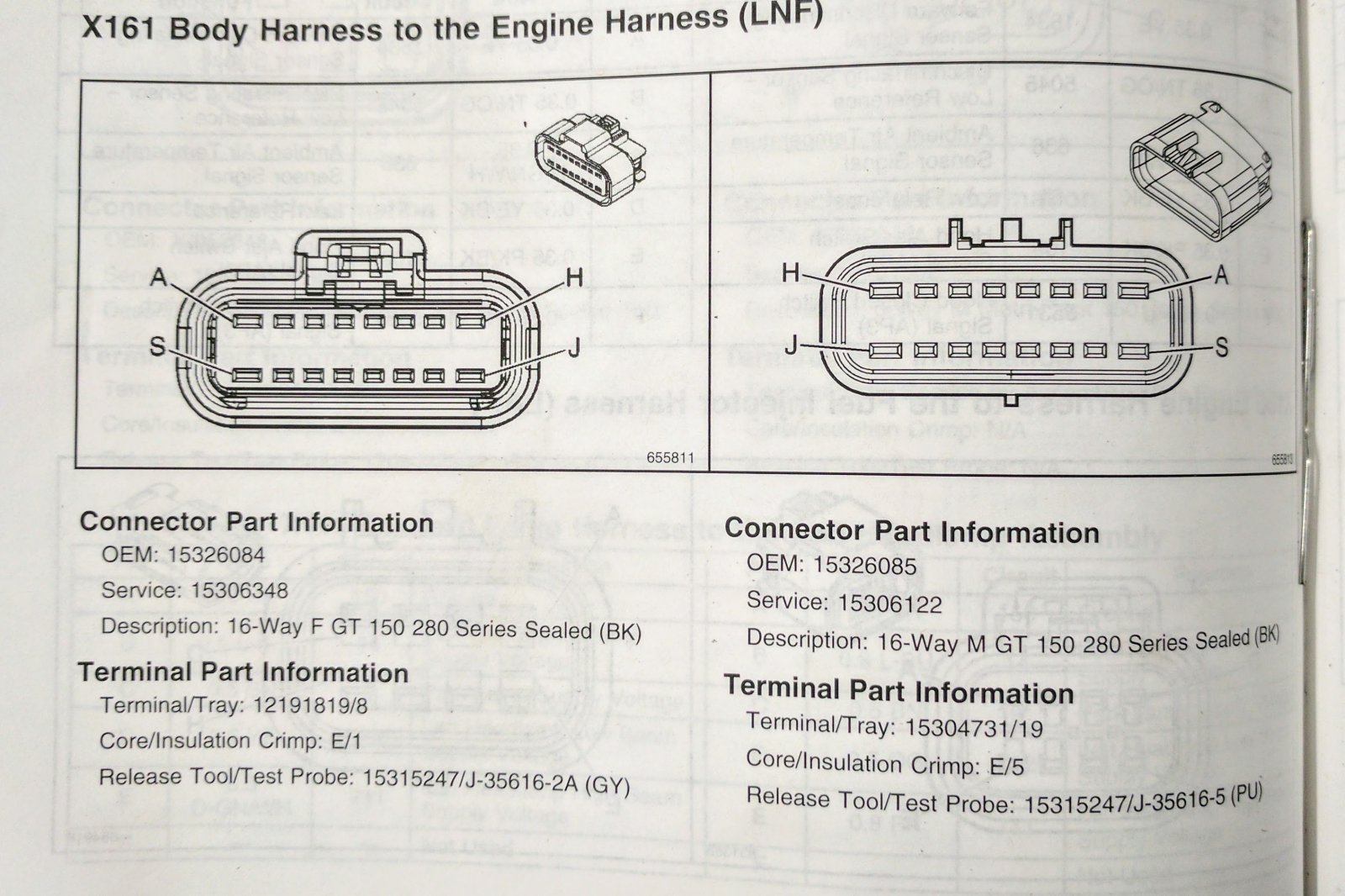

The black/white wire should go to ground. The pink/black wire should show 12 volts (only when the key is on I think). The other three wires will go to the X161 connector in the engine compartment. Here's what that connector looks like:

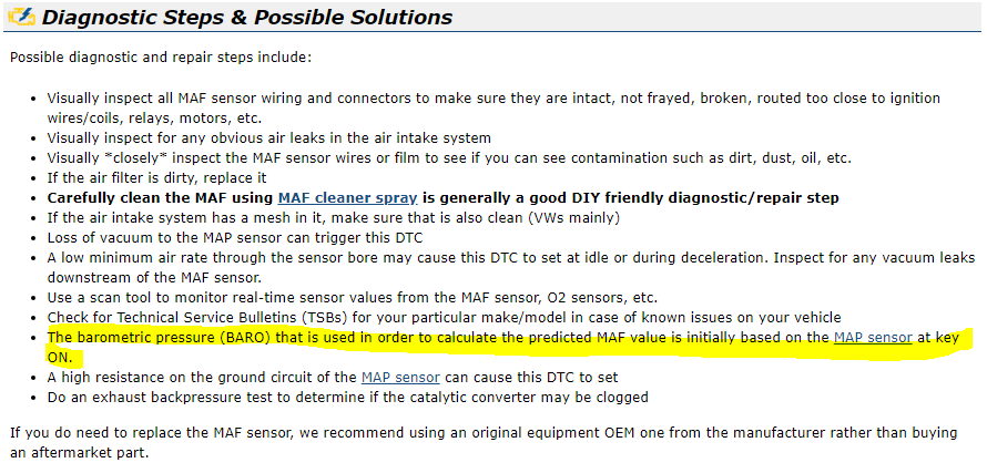

Just a thought here. Read this highlighted passage. Are you 100% sure you have the correct connections on the MAP and the BARO sensor? They are the same plug and can be swapped. At least this is the case on our SS/SC. I had to look up the wire color to make sure I was plugging the correct one in to each sensor. The only other thing would be a air leak in the intake track.
