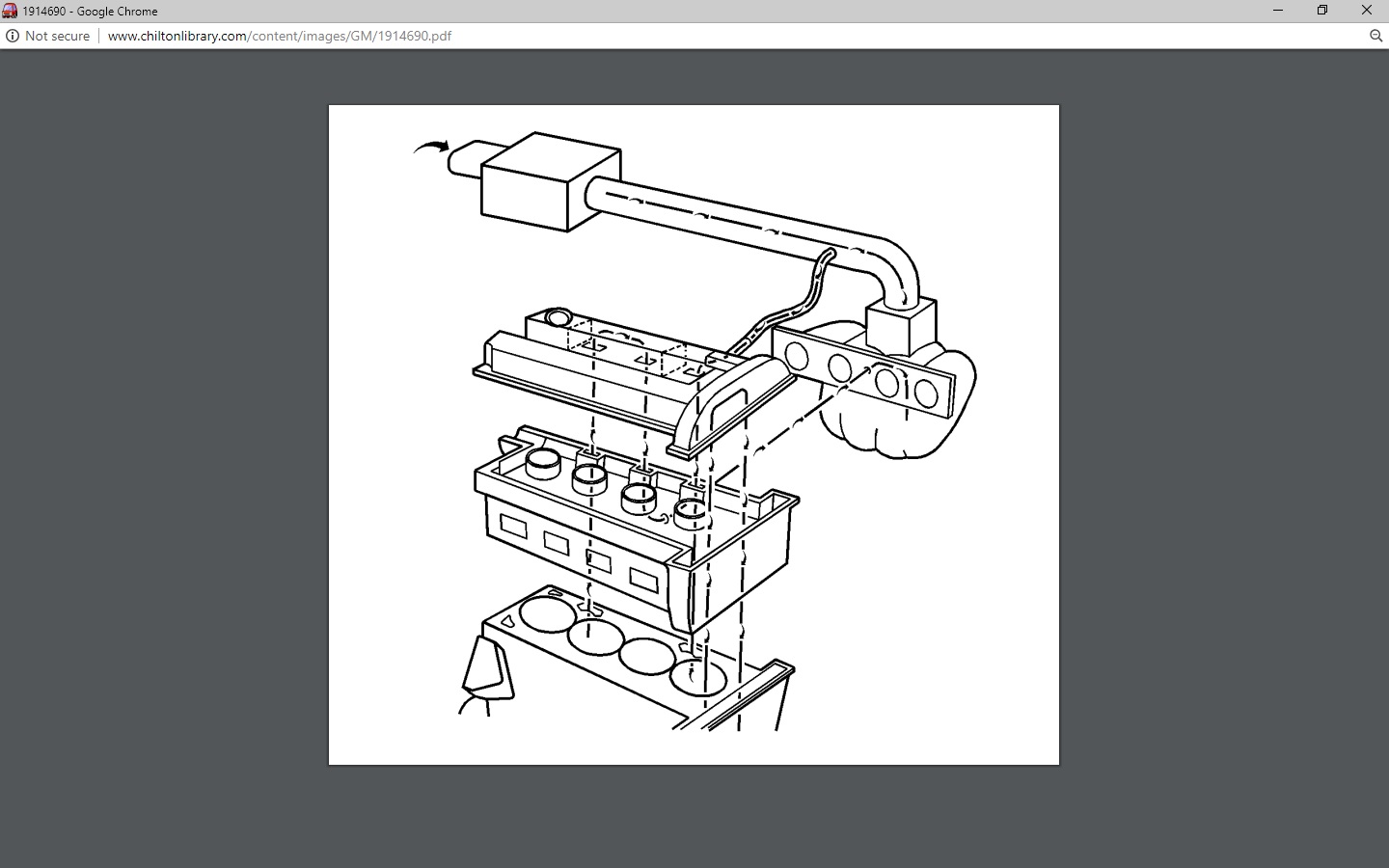

Here's a diagram that I found from the Chilton Library. It show the flow going from intake to valve cover. There also looks to be something cast into the mating surface of the intake manifold where the blow by gases go an enter the combustion chamber. This also explains why my intake manifold runners were coated in oil when I took it off to clean my valves.

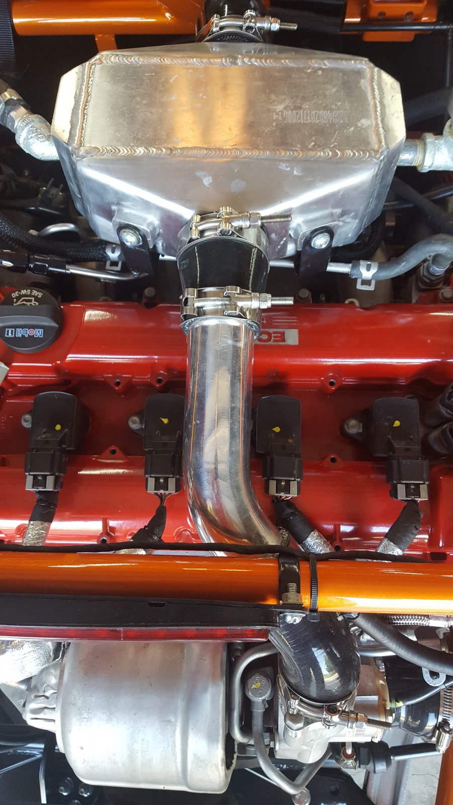

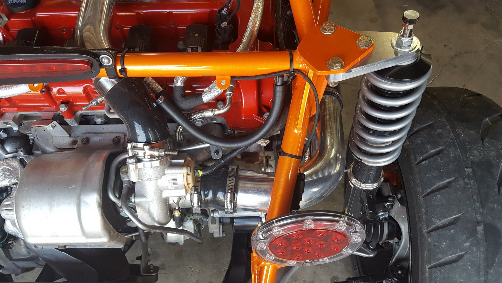

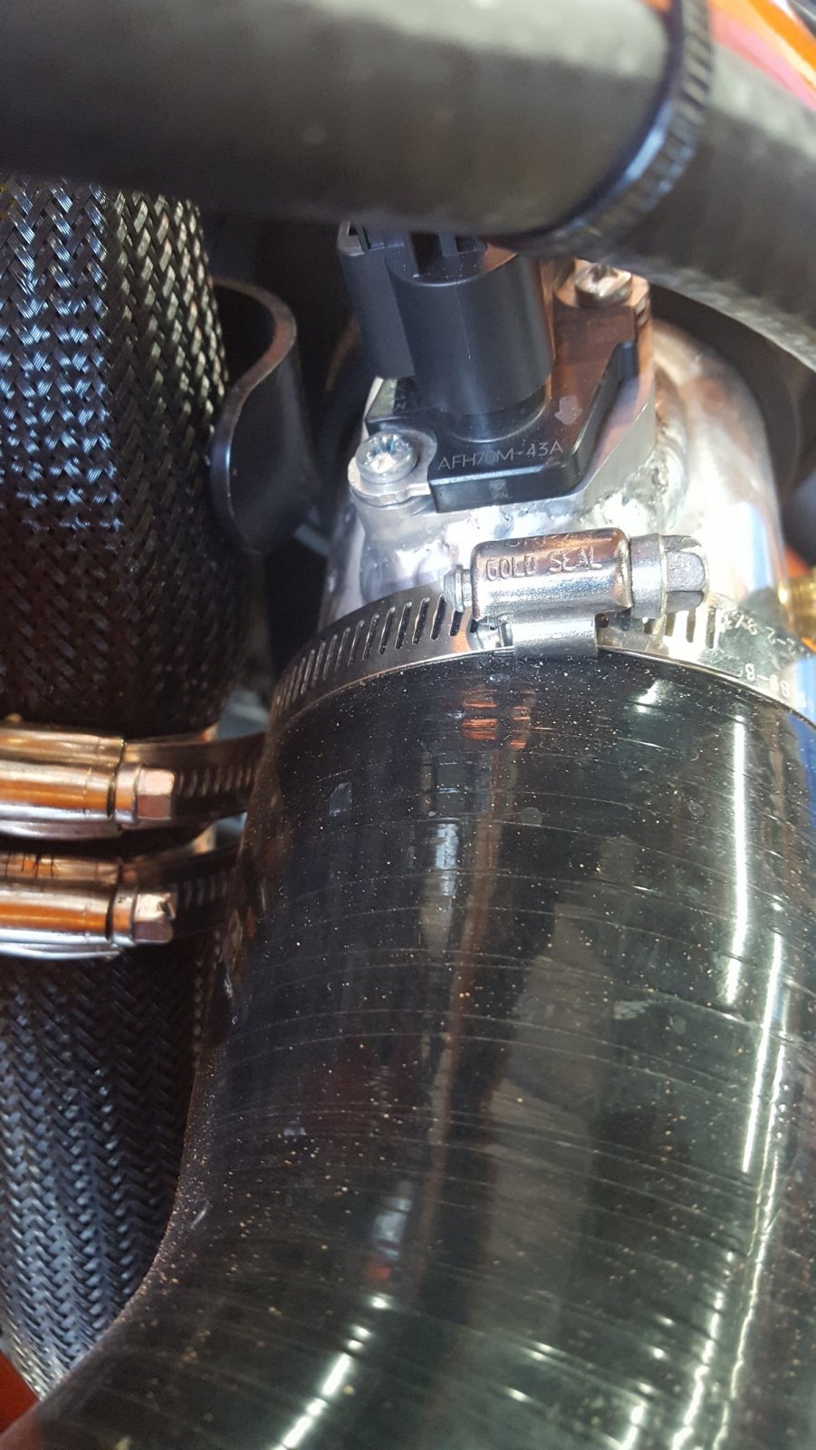

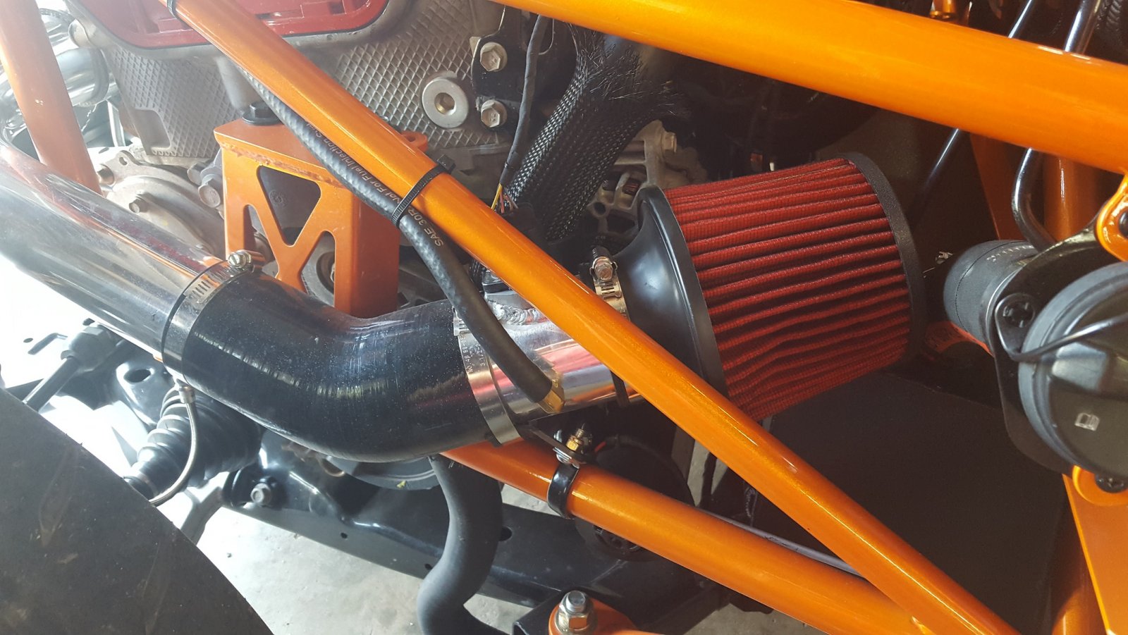

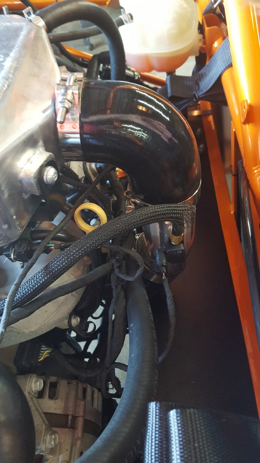

Can you take photos of the turbocharger, intake/charge pipes, vacuum hoses, intercooler, MAF tube and air filter so that we can see if anything looks out of place compared to the turbo car we have here?
Have you bolted your intercooler in place over the intake? I have no clue why, but the tapped holes in the air to water intercooler go all the way through and will leak if you do not install bolts (preferably with some thread locker). This could act similar to a crack in an air to air intercooler.

"Well guess what. I found that the silver cover on the MAF sensor is tied to the output pins on the MAF. If it touches anything metal on the cover it will see low resistance ground (if your tube is mounted to metal) on some of those pins and skew the MAF pitching out a P0101 and the fuel curves will be erratic as hell because the MAF frequency is all jacked" from cobalts forum.

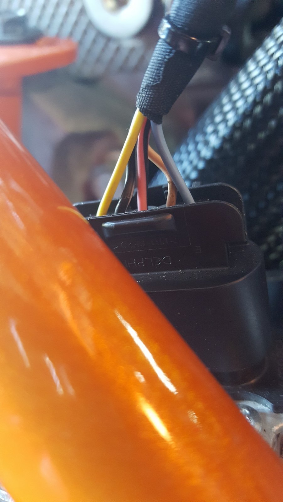

I'm going to see about picking up a new MAF sensor tomorrow. It's probably a waste of money, but I guess it's worth a shot. I don't remember if the dealer just cleaned it or actually replaced it when I took the donor in last year. I did have a big gaping crack in the original charge air cooler necks, but maybe it's possible the MAF sensor was the main issue all along and maybe they just blamed the code on the crack when they found it. I really don't know.
What's odd is I never had a problem driving the Goblin the very first 30-40 miles over several ignition cycles. Now when I clear the code I can barely go two miles before it comes back and the boost turns off.
Just checked the wiring, and it looks good. The sensor seems to be responding to air flow changes. When I monitor the air flow in Torque, the numbers seem to change accordingly with the throttle pedal. Blowing on it makes the numbers fluctuate too. On the surface of my testing, everything appears to be good with it. However, I really can't look much deeper because I don't have the tools.
I don't get it. Still waiting to hear Adam's thoughts after posting the pictures. I'll see what a new sensor will do, but I'm not holding my breath because the current one appears to be brand new. At least as far as I can tell by looking at it.
