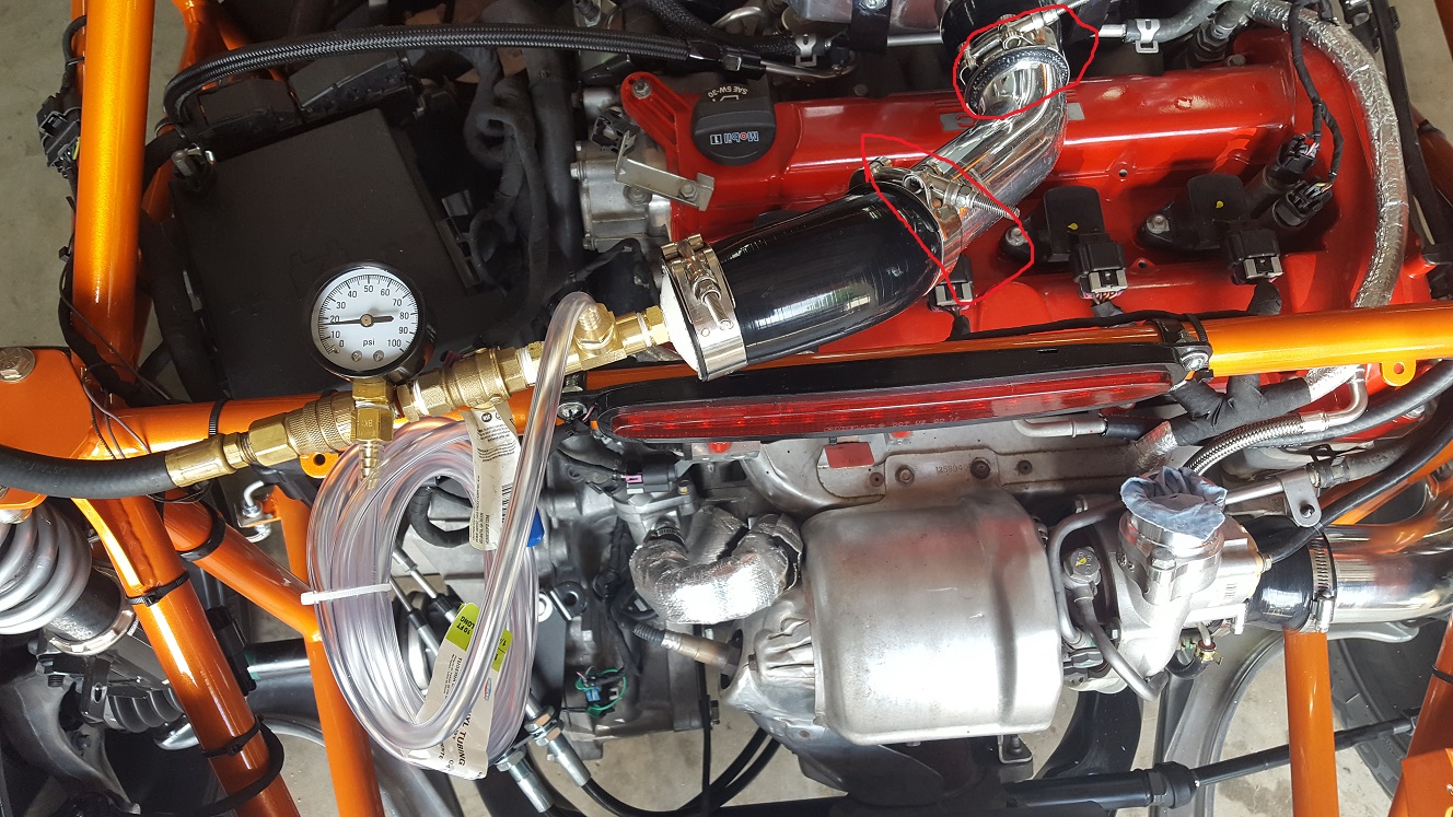

First off, thank you guys for all the advice and getting me thinking. I think I am getting somewhere, possibly. I decided to pressure test the turbo plumbing. After spending $60 on a variety of brass fittings and a PVC cap, I was able to get something going.
Unfortunately, it appears that you can't pressurize the turbo inlet because there is another PCV hose that runs to the valve cover. So I had to disconnect that portion, reconfigure, and pressure test from there. When I first hooked it up, the two silicone boots on the aluminum pipe portion had massive leaks. I really had to play with them to get them to finally stop leaking. Come to find out, they had to be tightened down by more than just hand. I checked all of my other connections on the TB side and they look good.
This section of pipe is a bear to hook up to the turbo. It's a very tight fit and a royal pain to get the pipes and the t-bolt clamps on straight. If I had to fiddle this much in a configuration that was easy to work with, I can't imagine how much they leaked when I first hooked them up.
