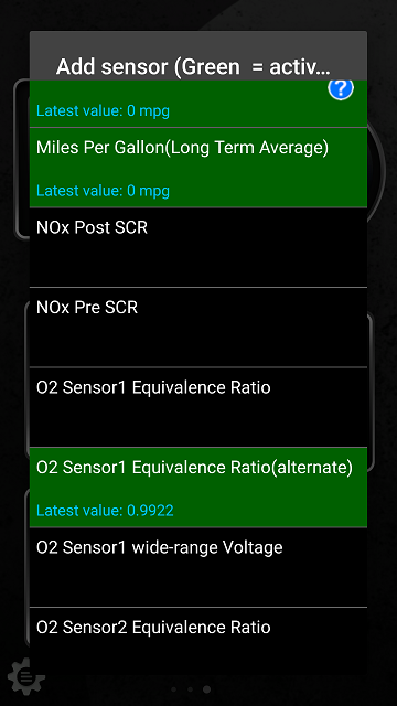

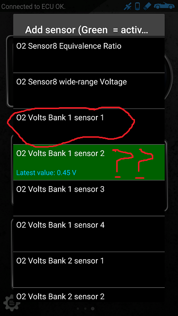

One thing I noticed in torque is that I'm not getting any readings for my O2 sensor. I'm not sure why. Can somebody confirm if they see something similar to these screenshots? These are the only O2 sensor related numbers I get.
Waterdriver
Form the Torque display. It looks like you might have the downstream O2 wiring connected to your sensor.
Located the other O2 wiring plug and try connecting to the O2 sensor. (Upstream O2 plug)
Looks like the ecm doesn't see any O2 readings from the upstream O2 sensor and is going to the default full rich mode to protect the engine.
The only LNF we have in our possession is a Solstice GXP. I logged it a couple of weeks ago with HP Tuners and noticed that the O2 Voltage B1S1 always shows 0.000 V.

I don't understand why torque isn't displaying the O2 sensor readings. I'm not sure if my current O2 sensor is acting up (no related codes unless I unplug it) or if there is something goofy inside Torque and the way it reads data from a Cobalt. I would think that the voltages should vary between 0V and 1V with .45 being the nominal value. Hoping someone can confirm that with their Torque.
