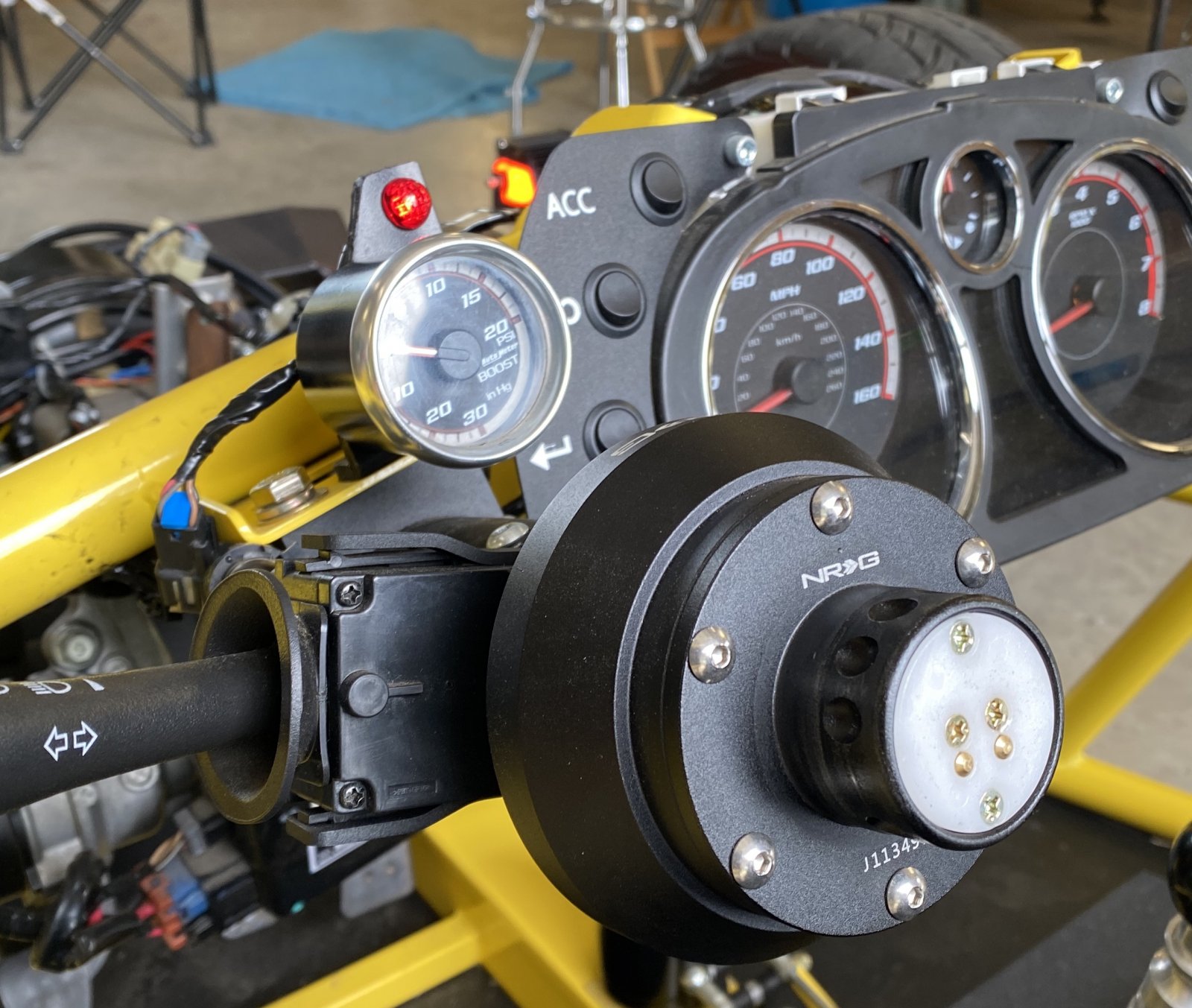

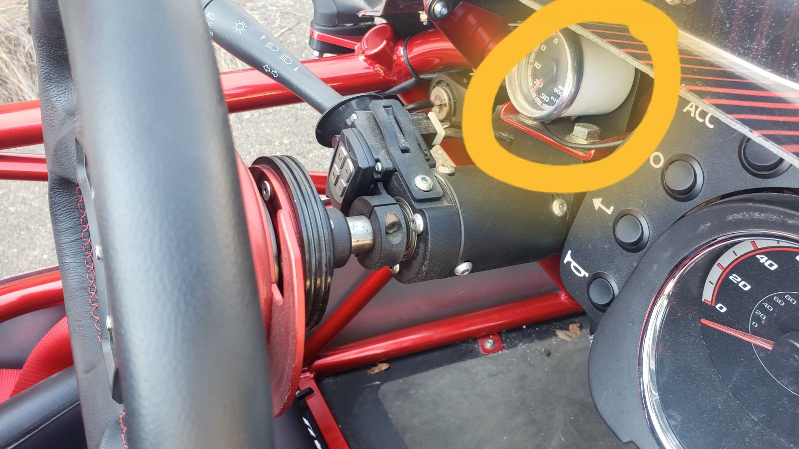

It’s an add on when you order your kit (or it was when I ordered mine). I made my own and incorporated a red light so I know when my parking brake is set

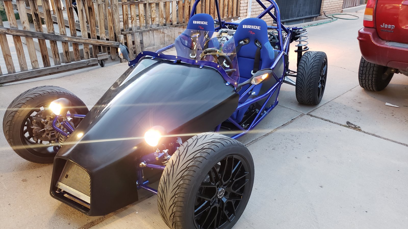

Aight... I need more light. I've tried adjusting the angle of my headlights and I came to the conclusion that I need something different. Should I swap the bulbs with leds or get different headlights that are already led? What are y'all running?
SmsDetroit
I had a bad bulb in Ming right out of the box so instead of replacing it with other stock one I got the led bulbs. Holy crap they make a big difference

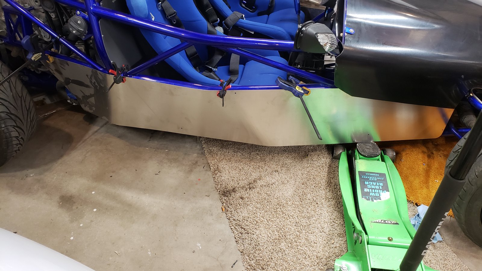

I started at the front. Lined the two holes up with the vertical tube of the chassis and made sure the top was even with the chassis. I used painters tape to hold the panels to the chassis while I adjusted them. It will take a little trial and error to get them positioned the way you want them.
There's a tab or two along the bottom tube that you can drill/tap but you'll want to use some adhesive tape along the rest of the bottom since you can't drill into the lower tube.
k.rollin
Get a set of cleco fasteners and pliers to hold everything in place - less than $30 off eBay. Helps to get all the panels aligned correctly and then install your rivets/screws one at a time.
The Clecos won't help with the initial alignment, as the chassis isn't pre-drilled for side panels (or at least mine wasn't) and the side grip ones don't have sufficient clamp capacity.
