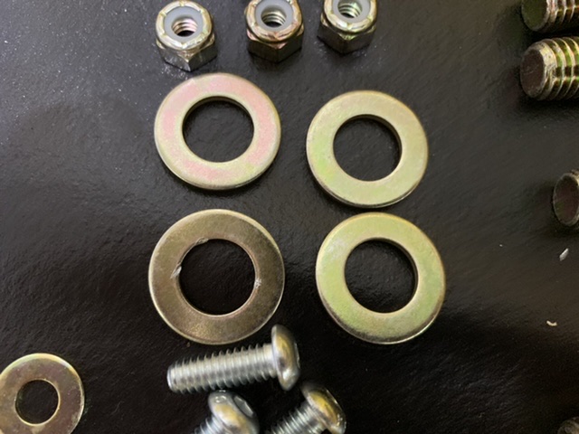

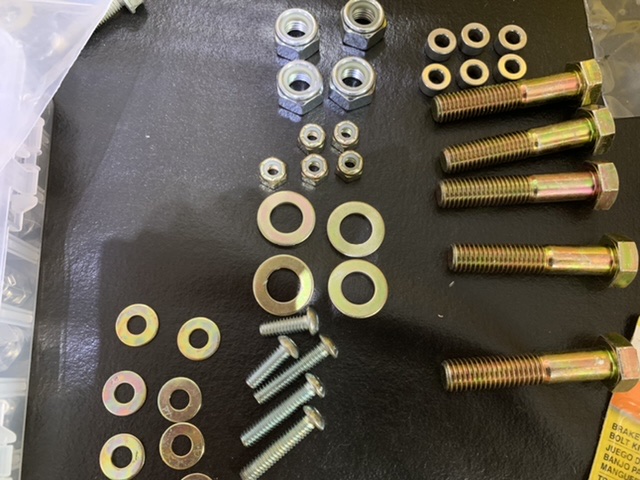

I’m looking at the hardware bag for the parking brake kit. Can anyone tell me the correct place to use these 4 large washers?

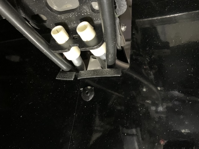

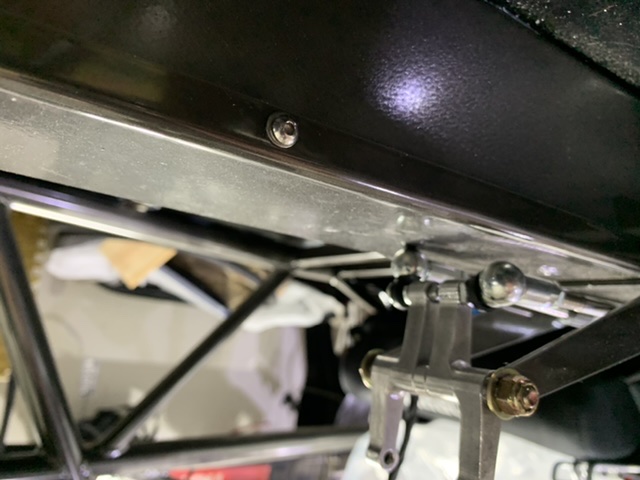

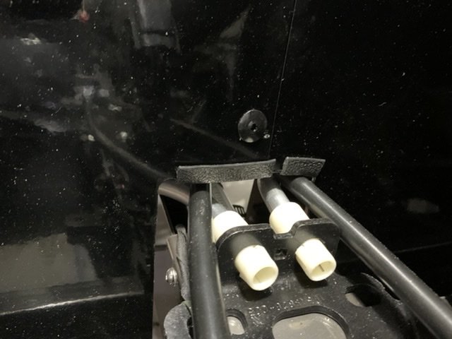

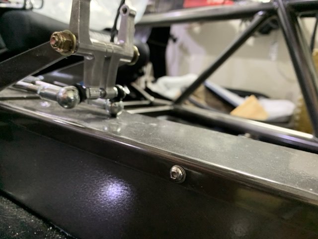

I did not cut my tunnel. I did have to trim the panels behind the seats to make enough room for the parking brake tubes to pass through. I didn't rivet my tunnel, I ended up threading the holes and putting screws in. I like the idea of being able to open that tunnel up again in the future.
15667
15668
Maybe those washers are to help even out the 2 brake cables?
