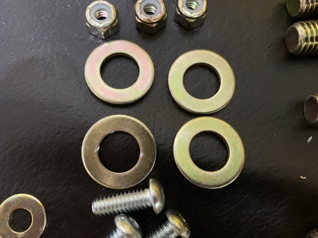

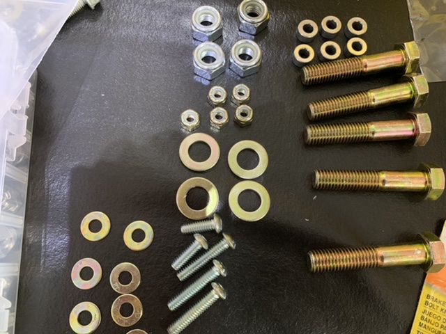

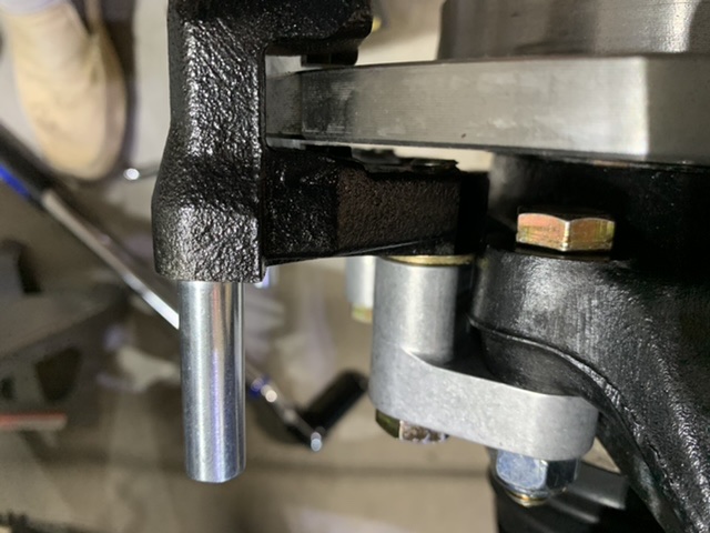

I’m looking at the hardware bag for the parking brake kit. Can anyone tell me the correct place to use these 4 large washers?
Just got my answer! Lonny replied to me email (on a saturday no less! Impressive)... Here's what he said:
"Some of the calipers what installed almost rub the brake rotors. One of our customers recommended sending some extra washers that could be used to move the caliper away from the rotor.
If everything clears you will not use those washers."
Thank you Lonny!

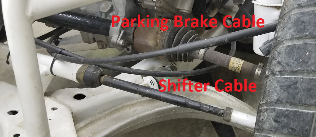

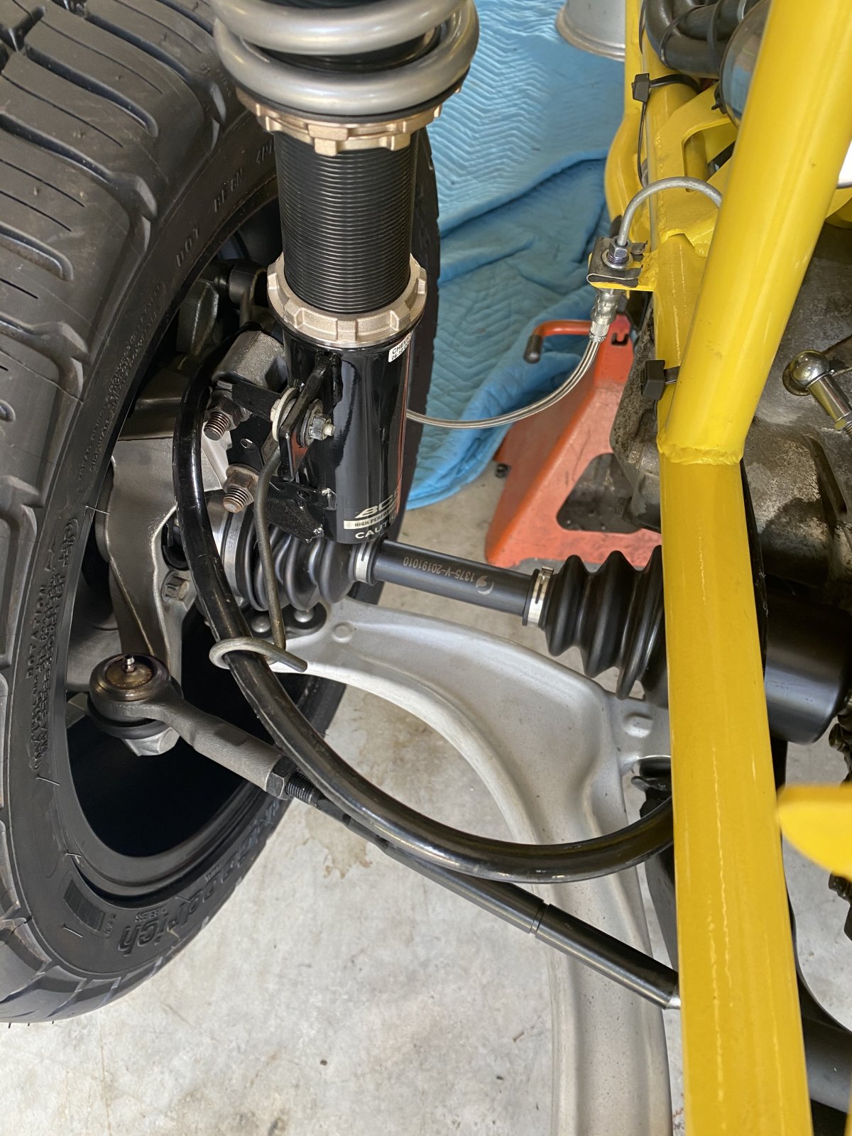

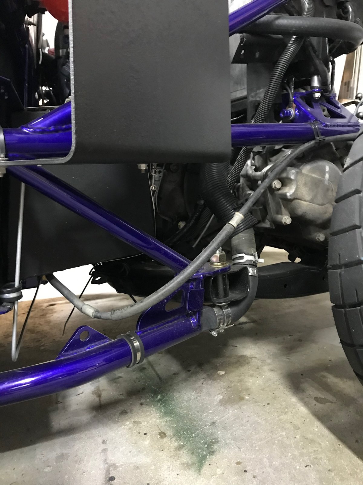

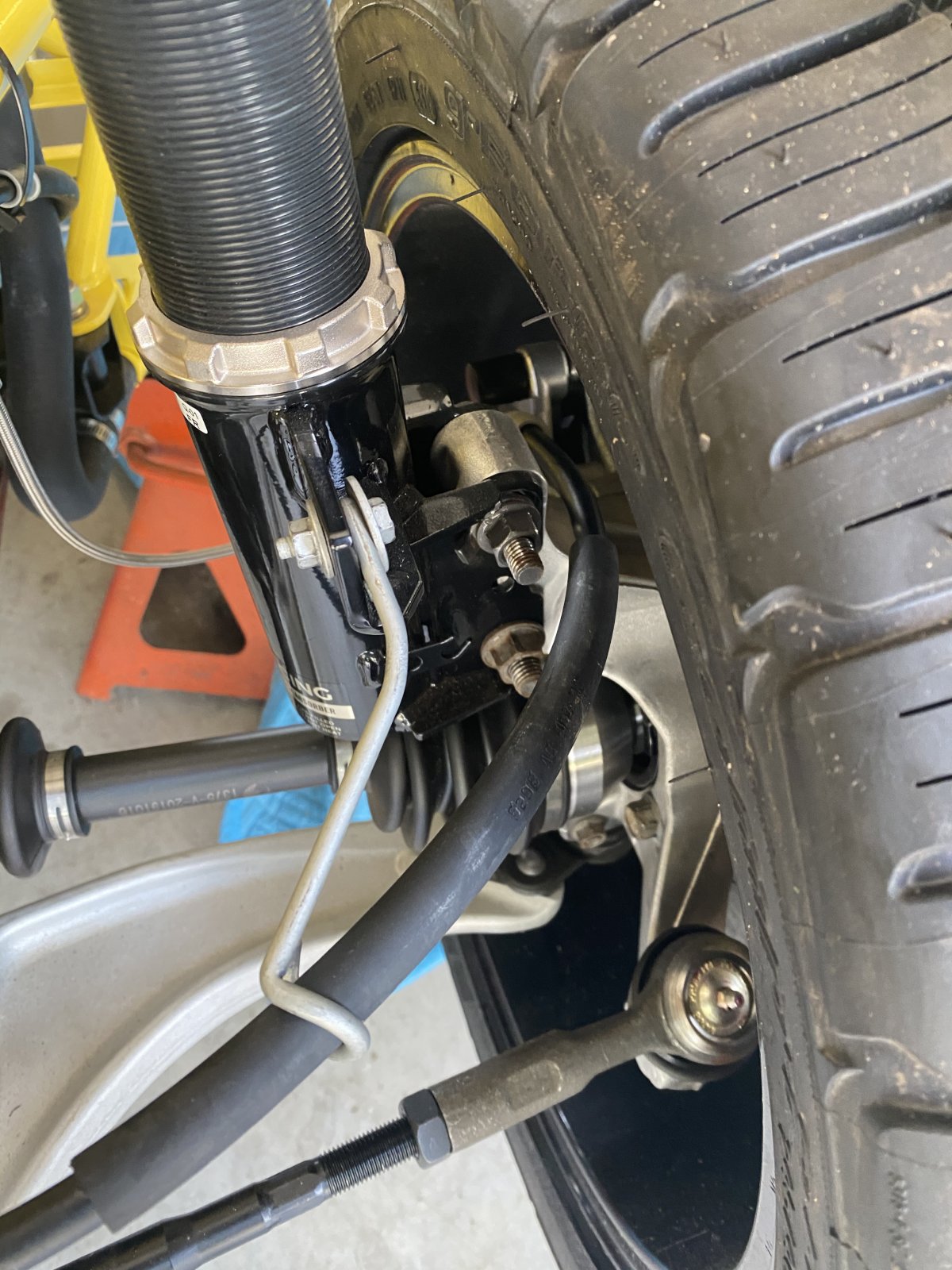

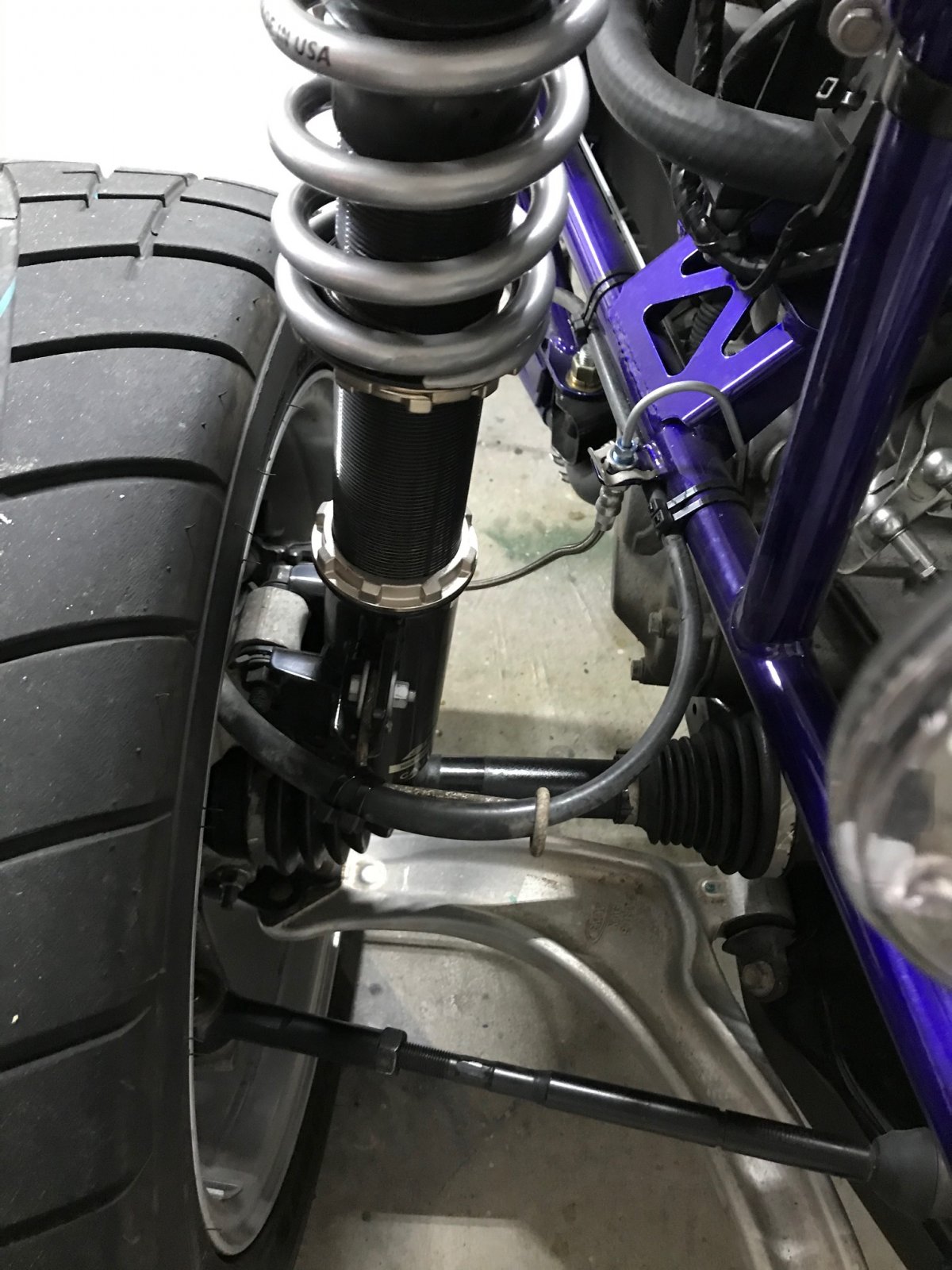

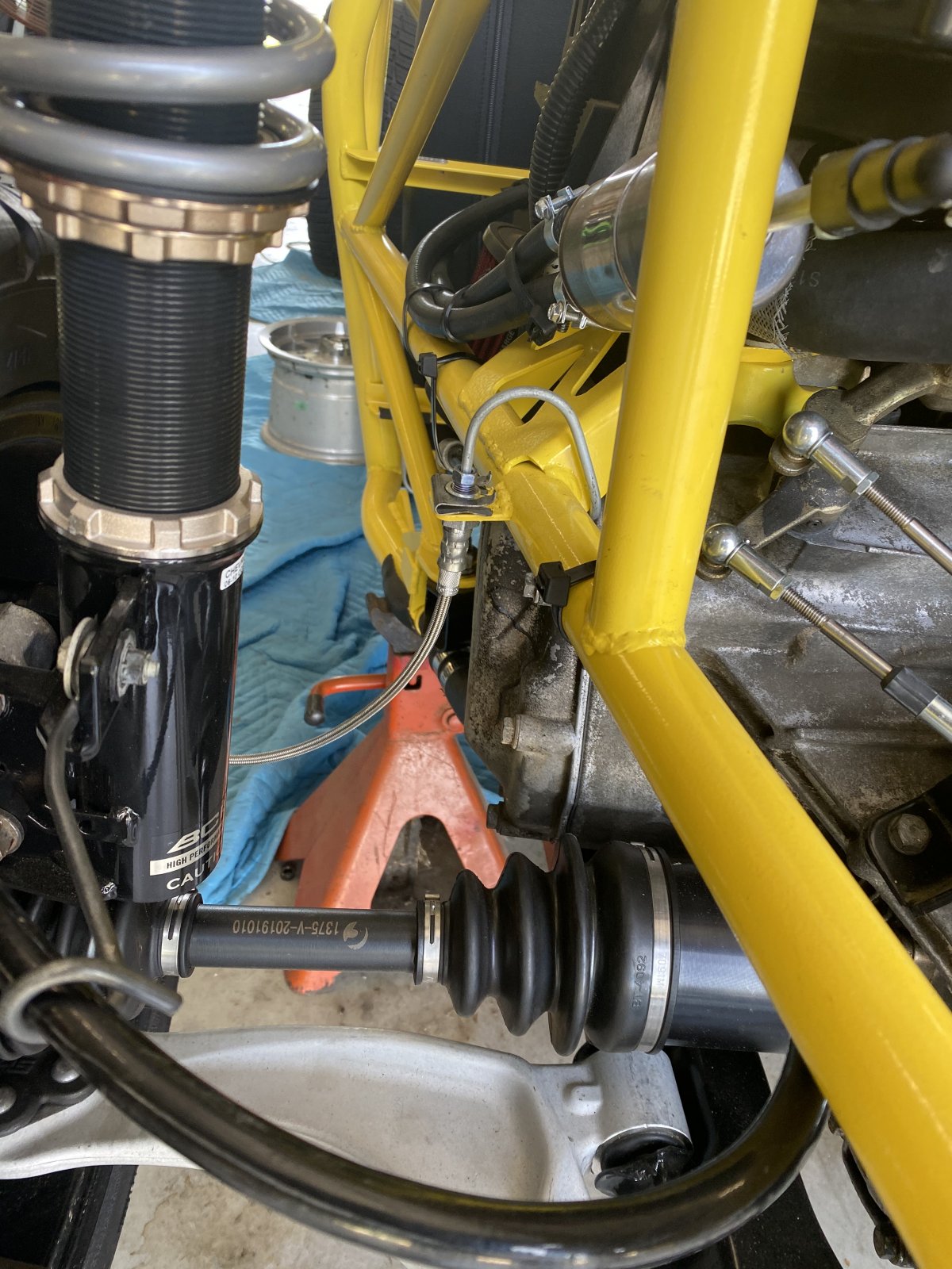

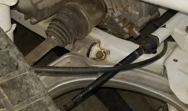

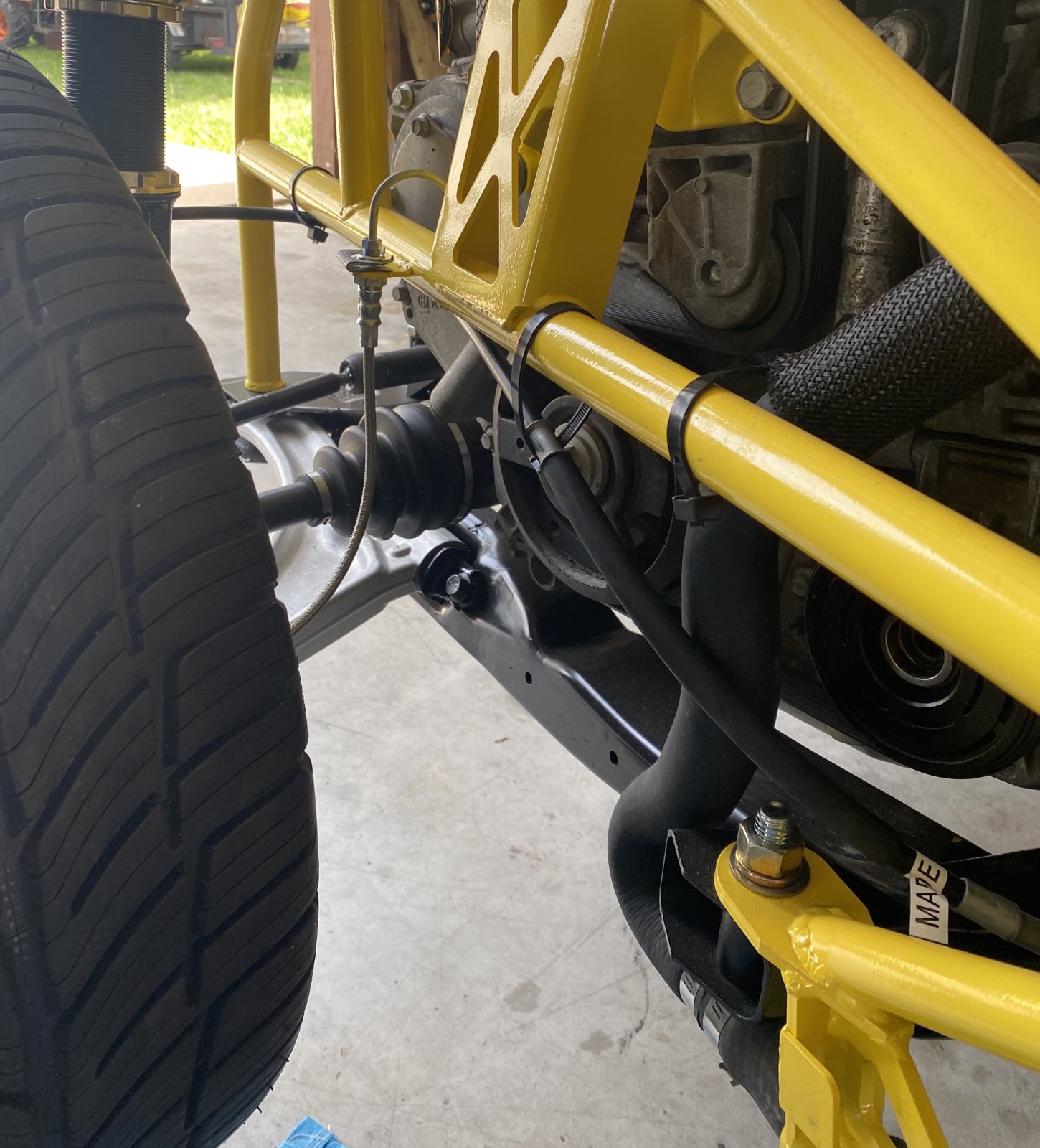

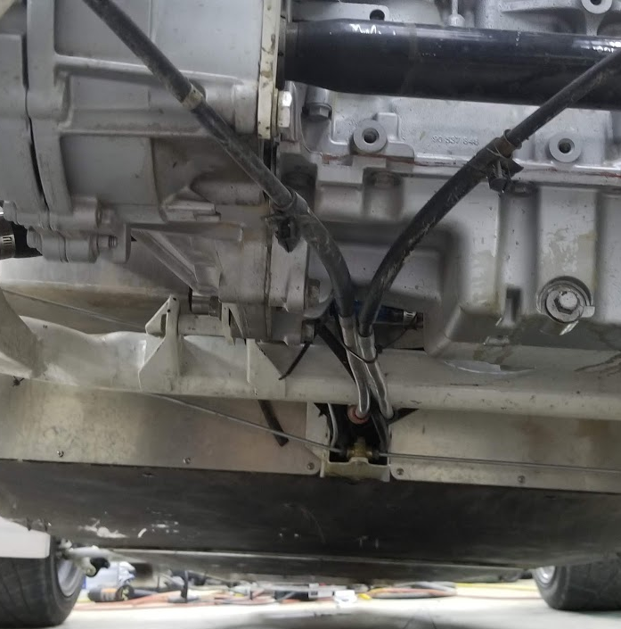

Could anyone send me a pic of how the parking brake cable runs? I've seen the posts from the helpful album... I'm just trying to figure out the best way to route it around the coolant hose. So if anyone has a pic showing the path of the cable from the caliper location to the aluminum tube it would be really helpful.
Lonny ran the cables along the frame. I straightened out the aluminum tubes, and found that the oil pan had this perfect spot to run the cables thru. I wanted to be able to move my parking brake handle further forward (towards the shifter) to make it more ergonomic for my arm length, plus it meant less turns for the cables.
15699
Just one big 180 loop at the end.
15700
15698
Believe it or not, it’s pretty much self explanatory, once you kind of lay it all together.
also, take the brackets on the cables and bend them out (see pic), then attach them to the struts to keep the cables stable.

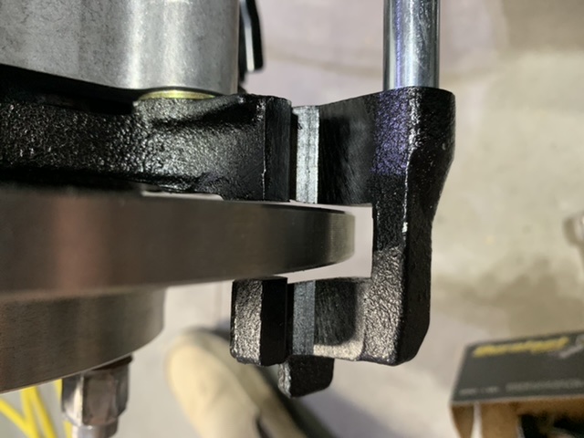

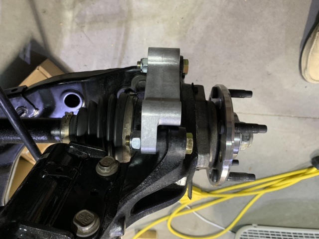

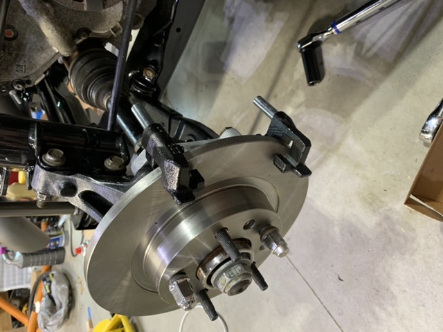

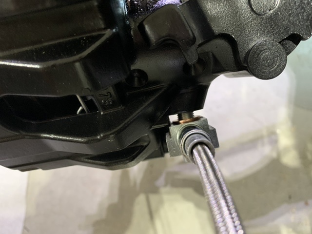

I put the first part of the caliper on. (85 ft lbs). I ended up using those washers I was asking about before for spacers. When I tried without them the outer part of the bracket looked like it was almost touching the disc and the inner had a much larger gap. With the washers in it about an even gap on both sides.

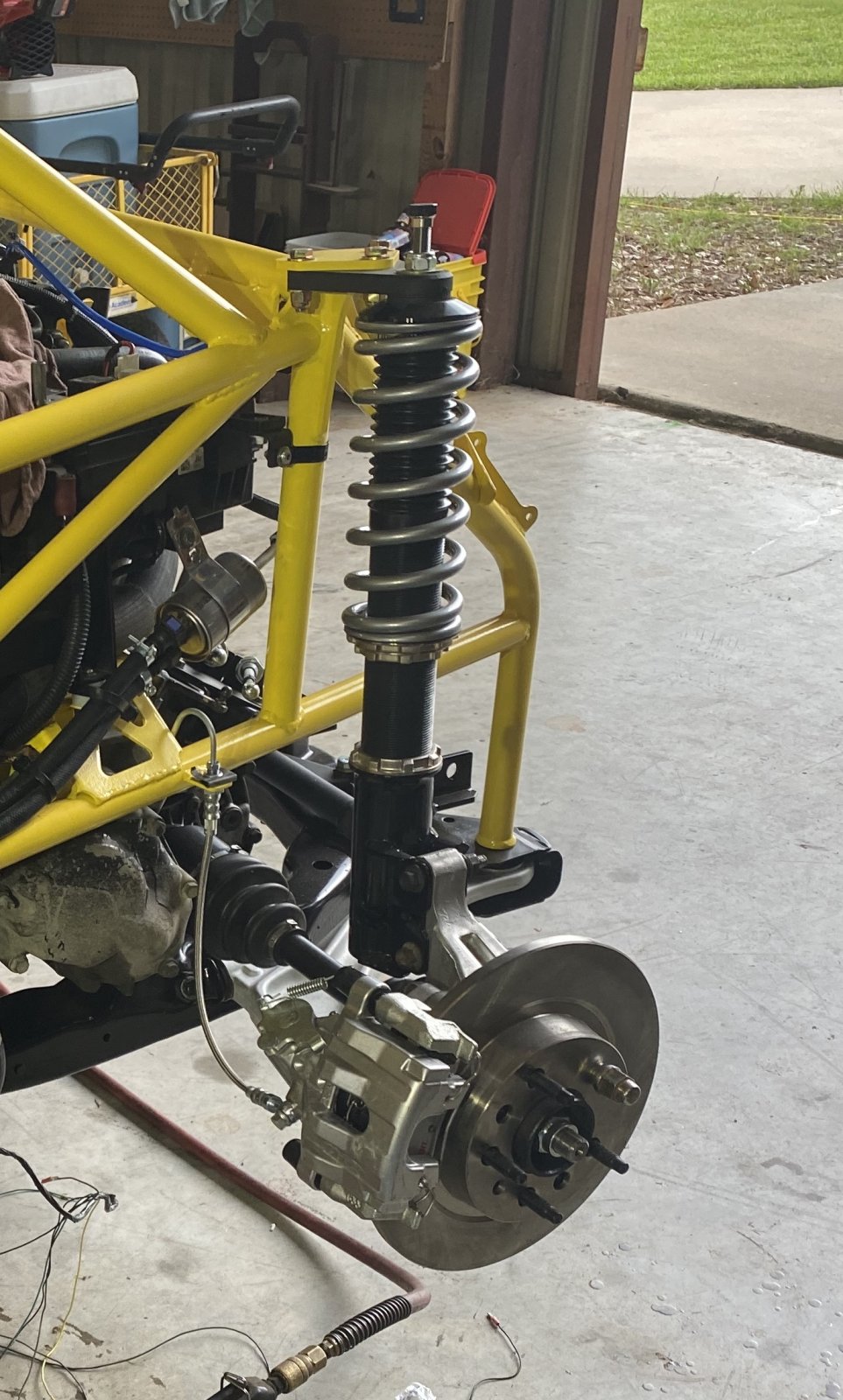

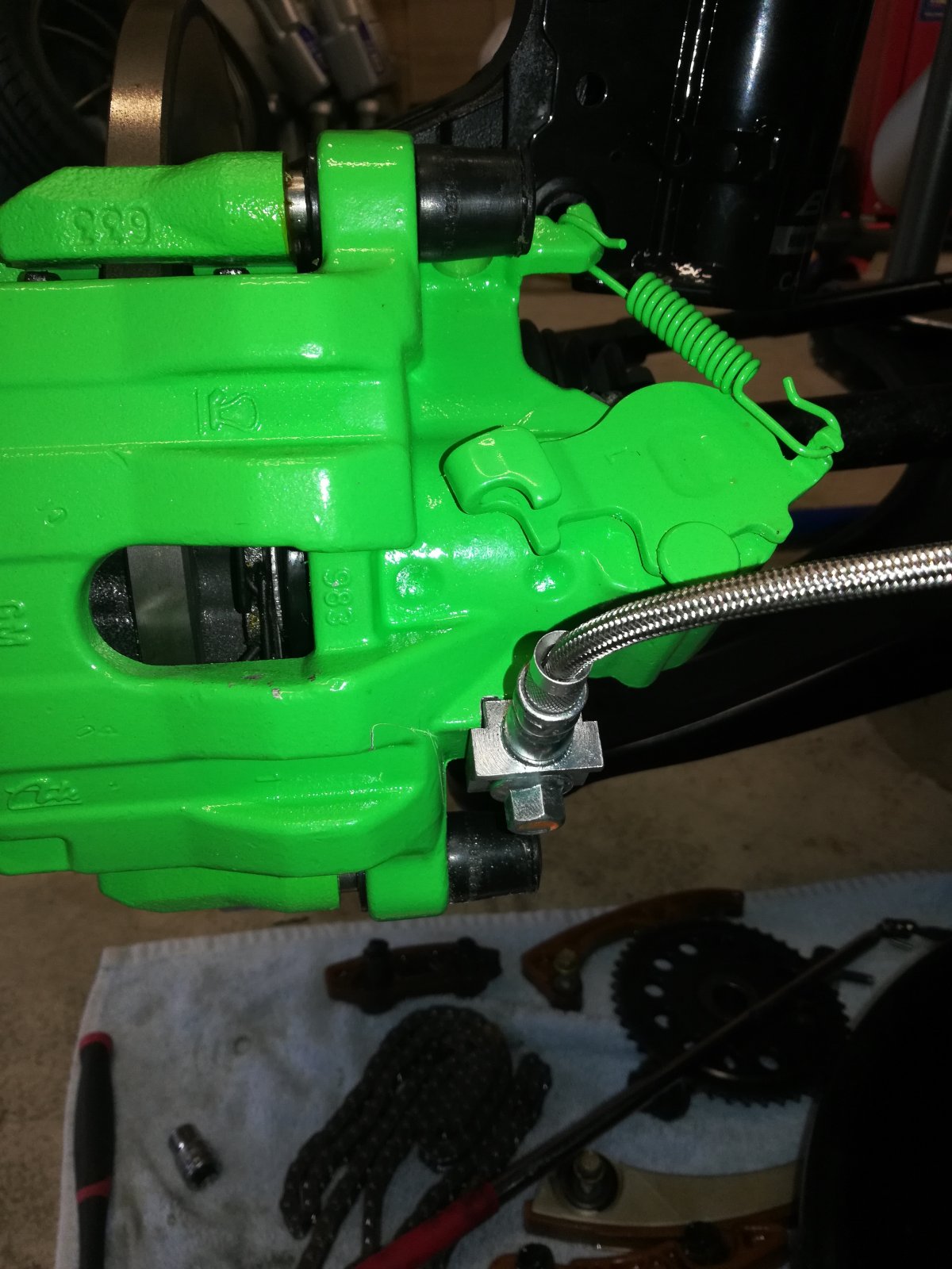

I finished installed all of the brake calipers and pads. My rear braided brake lines from DF don’t fit my rear calipers:
15783
This is the closest I could get it. I’ve seen some have chosen to grind the fitting to fit and I’ve noticed some have a round fitting that fits better. Still debating what to do with this.
Im really close to my first test drive. All I really need to do is get these brake hoses connected and bleed my brakes. Then it’s wheels and alignment.
Hmm. Mine are round.
I would file it down. Caliper and/or line.
