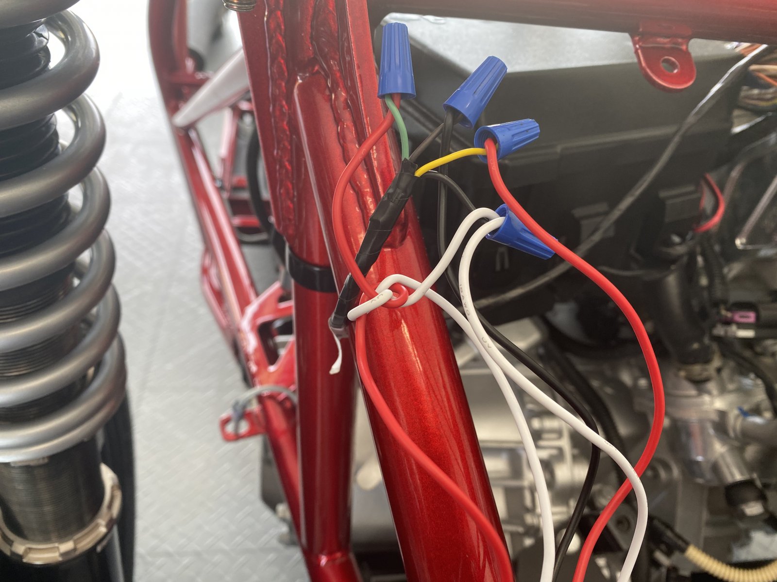

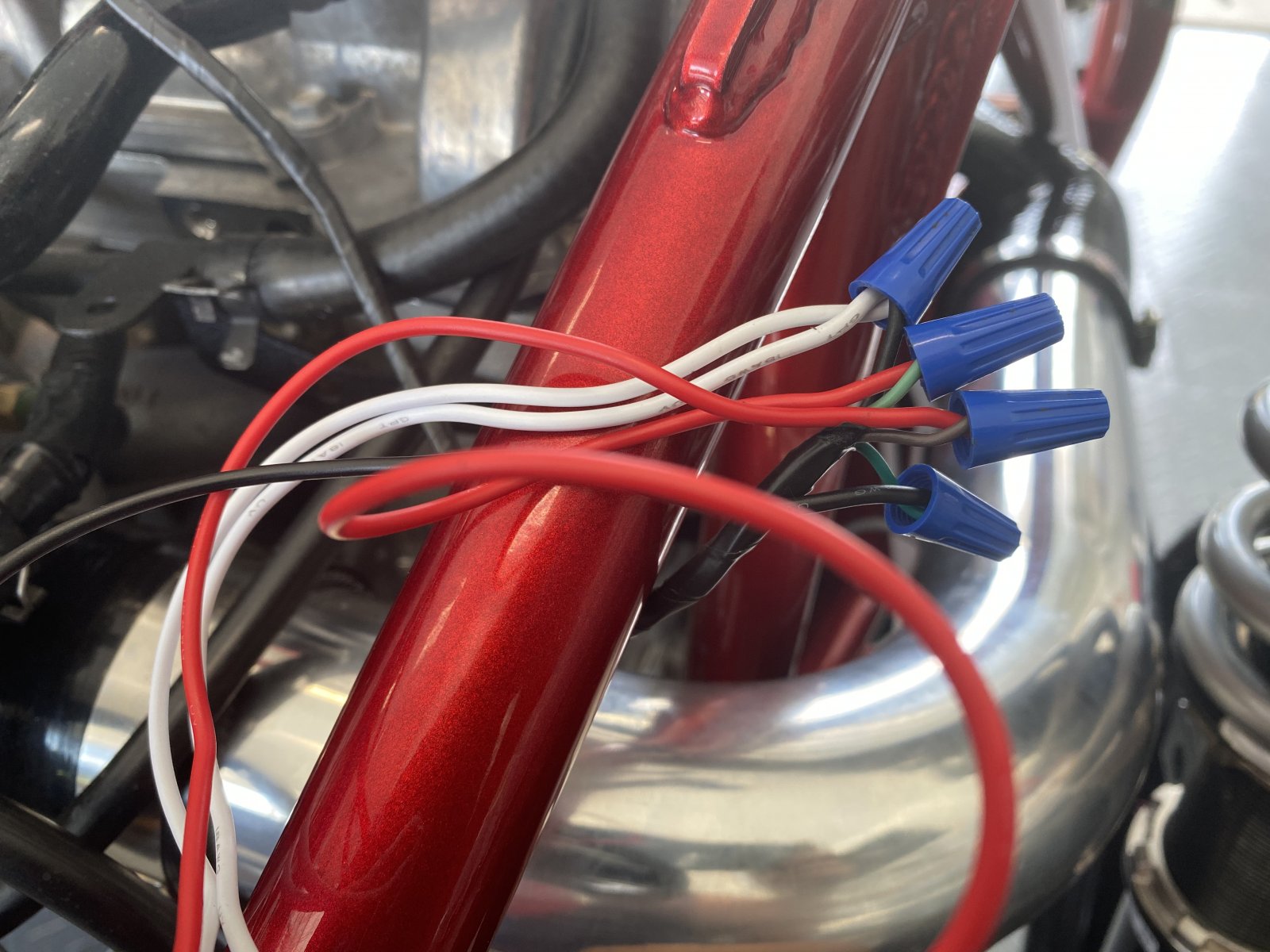

So if I'm gathering everything correctly, the Goblin side is:
Black-ground
Light green - reverse lights
brown - running lights
yellow(right side) dark Green(left side) - brake/blinker bright lights
Tail light I'm guessing is:
Red, white, and black - brake light, ground and running lights

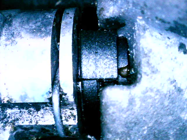

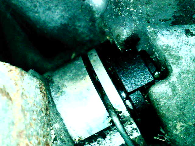

I just put some brake fluid in to prepare to bleed the brakes. I was looking around for leaks and found a drip(see video). I’m afraid my clutch line has a leak near where it connects to the transmission. Bummed because I’m probably going to have to take out the fuse box to figure out what’s going on. Any guesses? advice?
MisterDave
Could it be that maybe I just didn’t get it to seat fully? I tried to get a close up to see:
15883
15884
Hard to tell from the photos. Looks like you may have a gap, but there also looks like a small piece may be broken off the end of the fitting? I see something shiny in there that probably shouldn't be visible if the fitting is fully seated. Sorry to say but it should probably come apart to see what's going on. :confused:

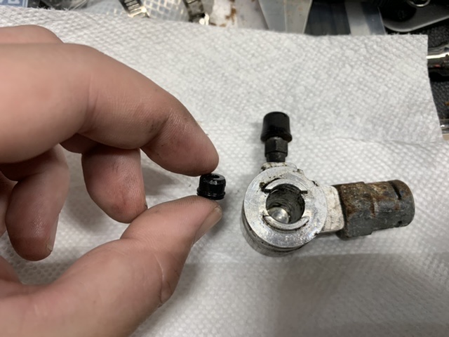

Alright... I got the elbow off. The seal was jammed up inside so I’m guess that means it wasn’t seated properly. I think everything else looks good. Should I try to get a new seal? Or do you think just seating it on the clutch pipe correctly should do it?
15889
Chevy sold me a new distribution block, I doubt you can buy just the seal.
Try it, test it, if it doesn't leak, run with it.
I think you can just buy one of these: https://zzperformance.com/products/hydraulic-clutch-elbow?_pos=6&_sid=45aec8abc&_ss=r
... along with one of these, but only use if for the seal on top and don't actually install the whole pipe: https://zzperformance.com/products/clutch-pipe?_pos=1&_sid=7e05fd005&_ss=r
The first item is the distribution block (Chevy term) and if it is leaking at the connection with
the second item, the bent pipe, then you need to install it inside the bell housing, which means pulling the engine, and splitting off the transmission.
(I just did that last winter)
If it (the elbow/distribution block) is leaking on the connection with the clutch line, then you should be able to fix it without pulling the engine.
The o ring/seal has to go on the trans side, then slide the elbow over it and make sure it seats properly. That seal is made of unobainium.

Thank you for the reply's...
Black-ground
Red, White - Reverse light, ground
Maybe this will help

I replaced the elbow and the seal for the clutch. I also tried to tie down the clutch line so it entered the elbow at a lower angle. I think it was pushing up on the elbow a bit. I don't think this had anything to do with the leak, but figured it couldn't hurt. So far no leaks! I bled the brakes and clutch this morning and check it every now and then for leaks... so far so good.

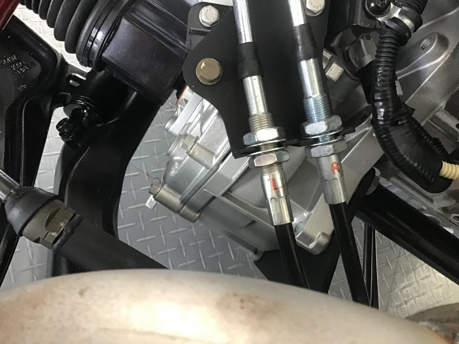

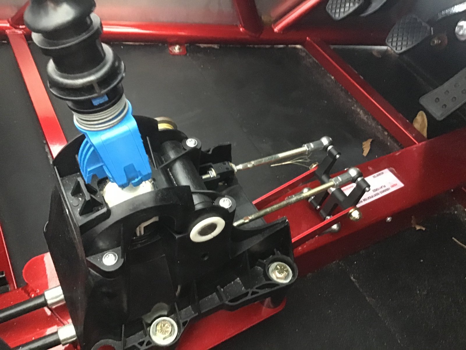

Now that I have the clutch I tried to go through my gears.... Can't seem to find 5th or reverse. Sounds like it's a common problem.... Any tips to dial it in?
OptimizePrime
I had a hell of a time getting the metal U shaped pin in on mine.... more or less jammed it in and hope he doesn't come out.
With the 5th and reverse, that's usually adjustment on the trans cables themselves. My shifter cable nuts are both situated in the middle of the threads and my trans cables are the ones I had to adjust to reach 5th and reverse... ended up being a trial and error which you can do with the car off. Once you're able to get into those gears then take it for a drive and fine tune.
Zoom Zoom
To get 5th and reverse , what I did was tighten bottom nut on left cable up about 3/4“ and if you still don’t have reverse shorten up drivers side shift rod a little at a time until you have reverse
