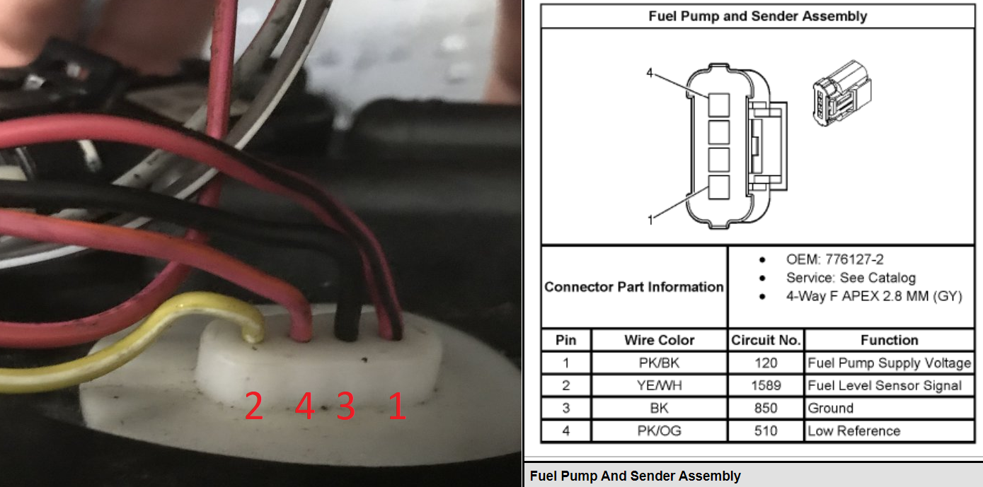

Your wires are not lining up with the diagram I provided... from my 2006 Cobalt SS and maybe your 2005 has a different fuel pump. I think my diagram is wrong for your car.

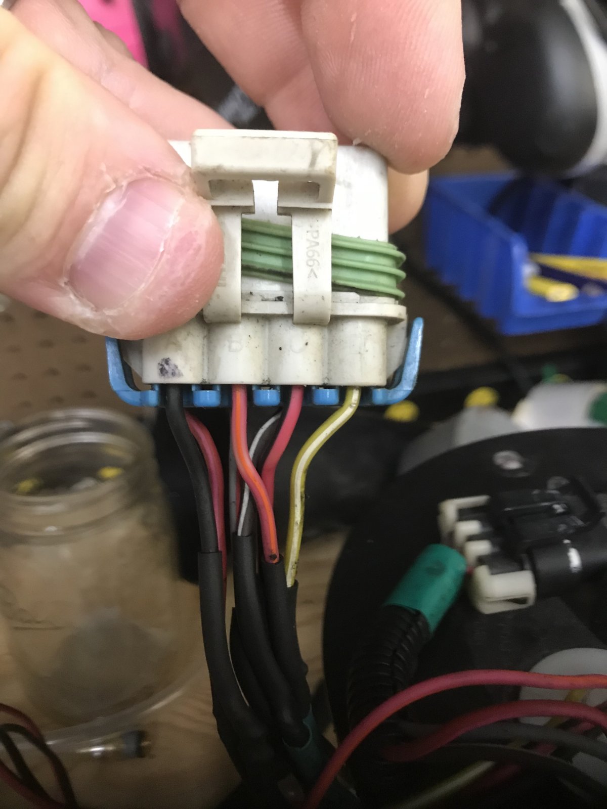

I have the older 05 SS fuel pump which has a different larger plug. What is your take on re-routing the low reference wire to the BCM plug pin 66 show above?
The low reference should be the same. I would pull out an electrical meter, and measure voltages at Empty, Full, current low reference, and at the other low reference before I started re-wiring. I wonder how it got mixed up from stock wiring.

Ron, is there a diagrams for the fuel sender and gauge?
The first diagram only shows low reference going to the fuel sender, the second diagram shows the fuel pump.

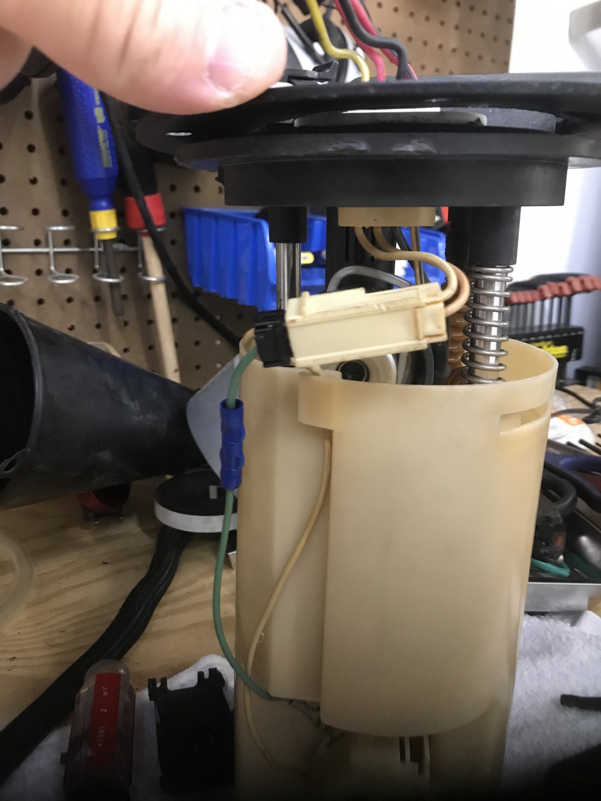

So...I was impatient and last evening swapped the wires before you gave me some great advice and...now when I plug in the float in it only reads full and does not adjust to motion. I pulled the float apart and seems very simplistic with a contact but I assume its defective. I did measure the fuel level sensor signal (ye/wh) at .014 and .005v at the Low Reference (pnk/red).

Thanks Ross I found the short it was on circuit 2759 to pin 29 on C1 plug. Now the sender adjusts when I lift the arm it goes to empty and when all the way down its full so its backwards correct? This is the wiring layout through the entire circuit to C1 PCM plug.

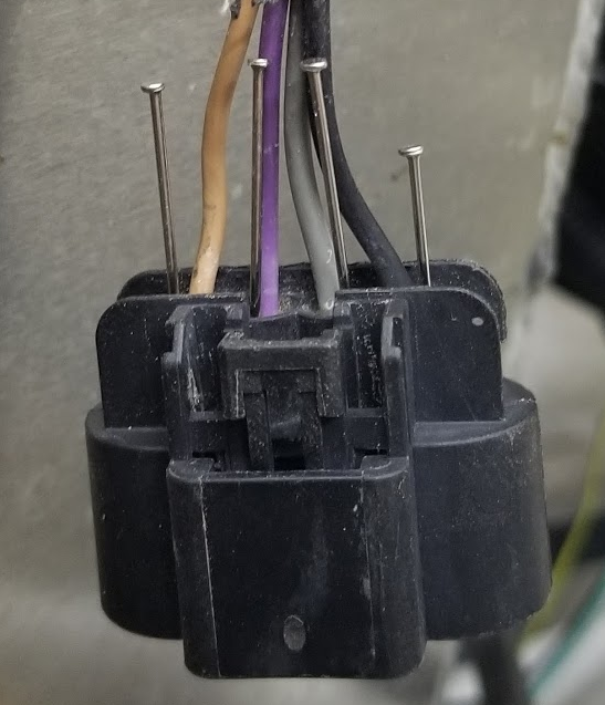

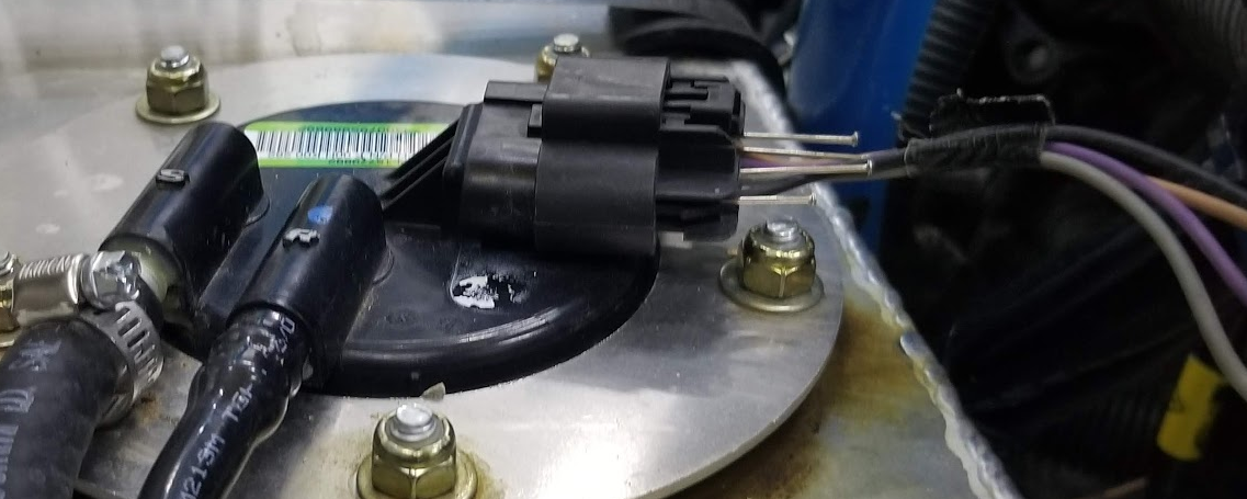

So I pinned the back of my 2006 Cobalt's fuel connector, then plugged it in to the fuel pump so I can measure voltages.
The black and grey are both 0 volts = ground.
The purple was 0.711 volts when the tank is full,
0.810 volts when I "removed fuel" by tilting the car with the jack.
5.050 volts when not plugged into the fuel pump (reads empty on the fuel gauge)
The pinkish wire is .004 volts.
View attachment 11324View attachment 11325
My purple is .7 empty and 1.5 full so opposite

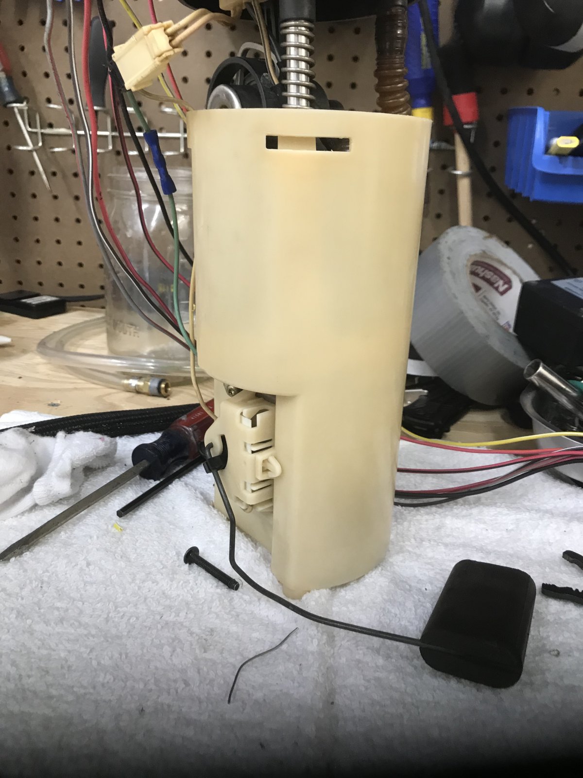

Have you bent your float wire in a different direction?
Here is the float. I will say this issue came up after I got my car tuned. The PCM was flashed with another customers Goblin code I wouldn’t think this would be programmed in the PCM but maybe?
