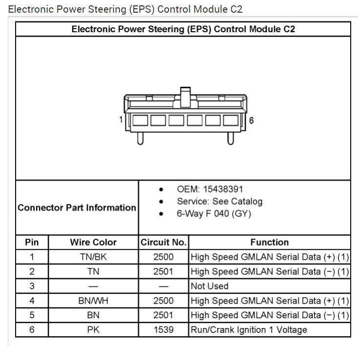

I get 61.5 ohms at the OBDii port on my LSJ, with the key off.
At least I do when the power steering data connector is pushed in. I see it changes if I pull on that connector... so I need to fix that.
If you turn the key on, of course data starts flowing on the GMLAN, and the meter goes all over the place.
