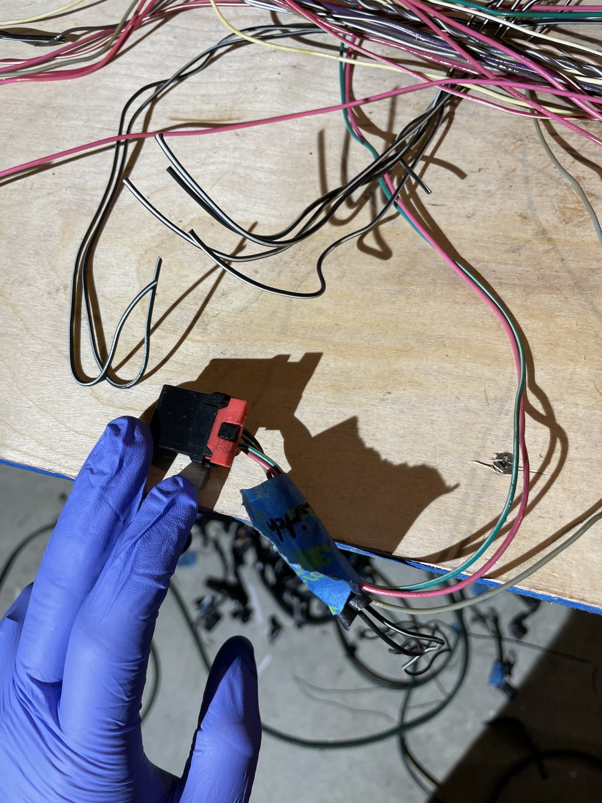

Hey @Lonny, I didn’t cut out my info/return connector. You’re right, there is a gr/wh and pink cable going from it to the cluster connector. Should I cut off the connector and tie these 2 cables?

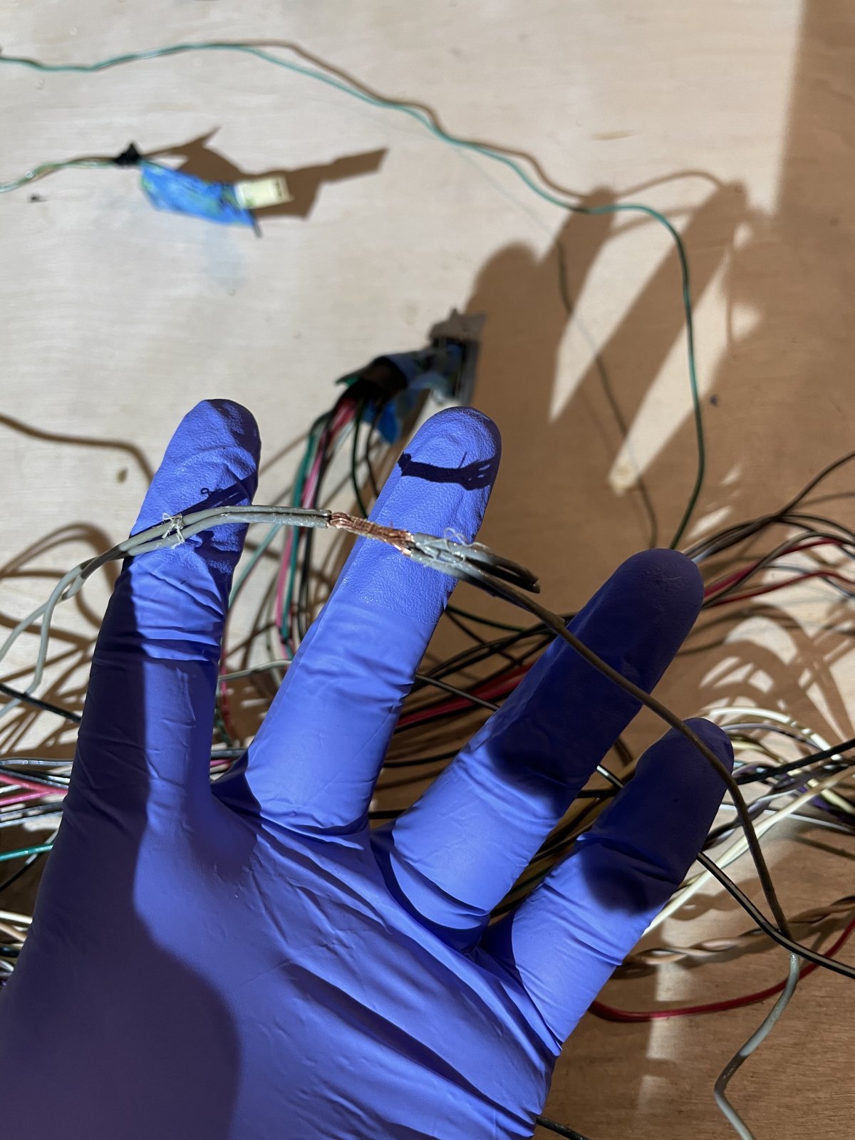

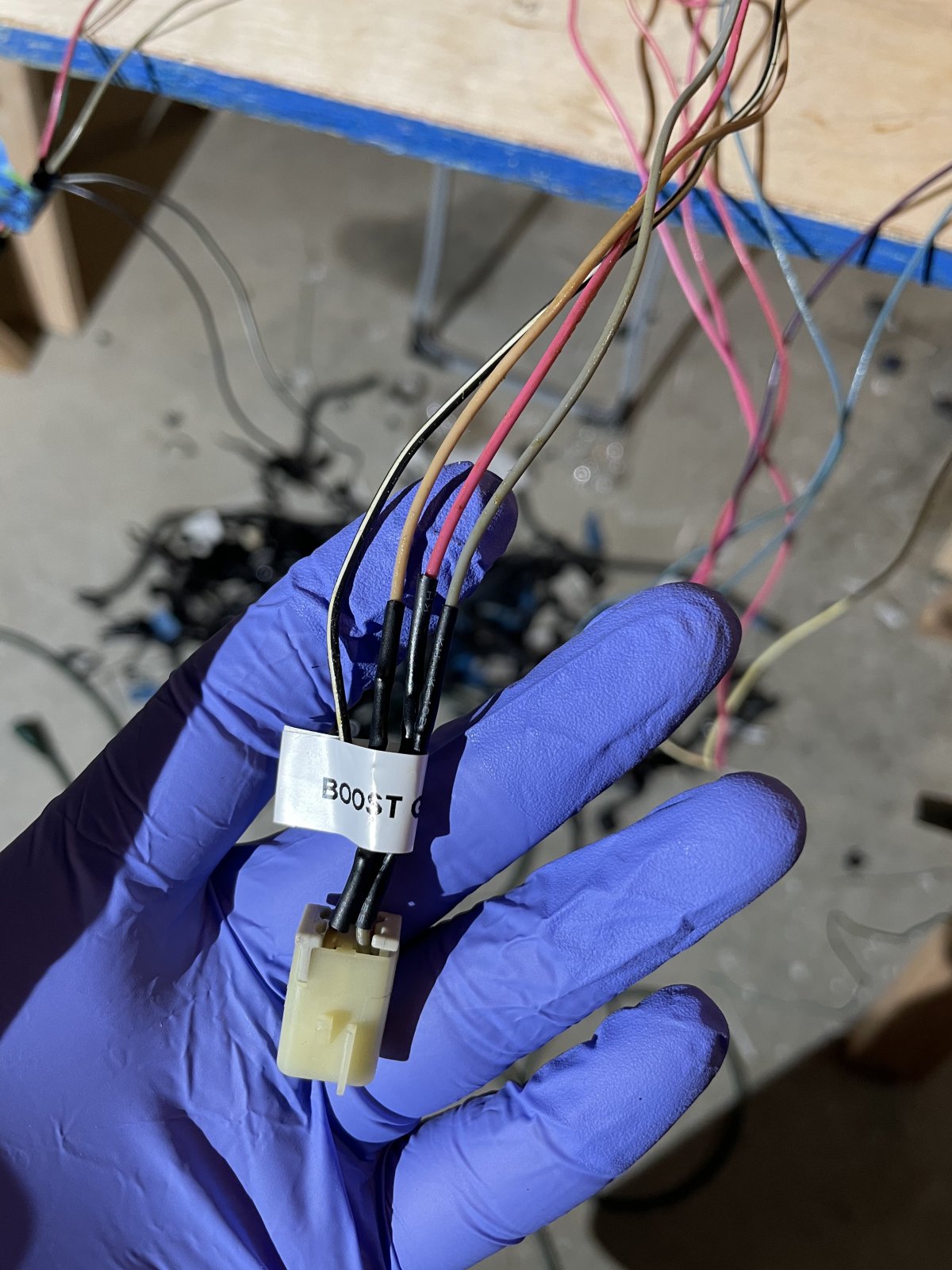

what about the wire going to the taped junction? Does this get removed? In the video it looks like the junction gets cut out entirely back to the grey multi plug, but my boost gauge connector is still connected to this junction so I didn’t cut it out.
I didn’t have it labeled initially and started to thin out the wires and realized what it was thanks to your label sheet and the body to dash connector reference.
The info and return connector can be removed. Tie the GN/WH and PK together. When you eventually gather all of the wires for your buttons there are going to be two pink wires. One is for the Info or return (can't remember which) and the other is key on positive power for your cruise control. Don't mix them up.
The grounds can be removed and the gray can be cut up to the taped junction.

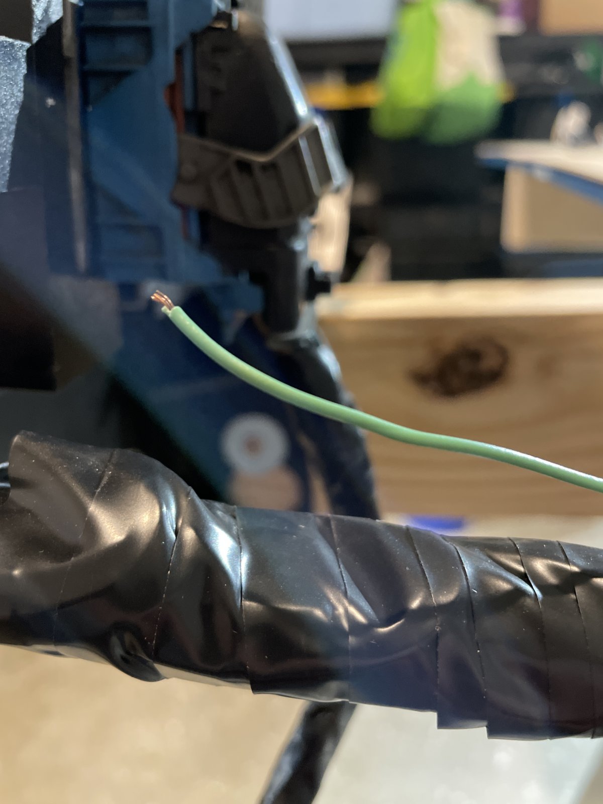

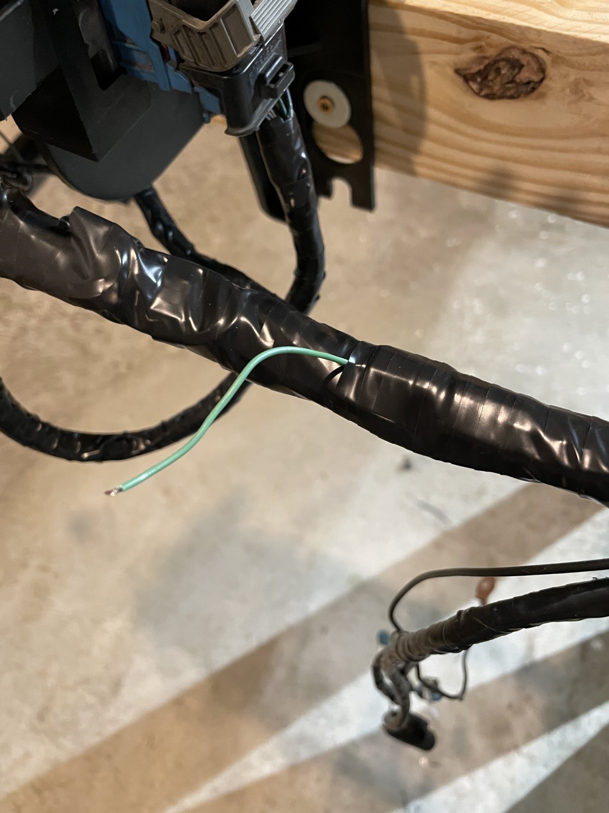

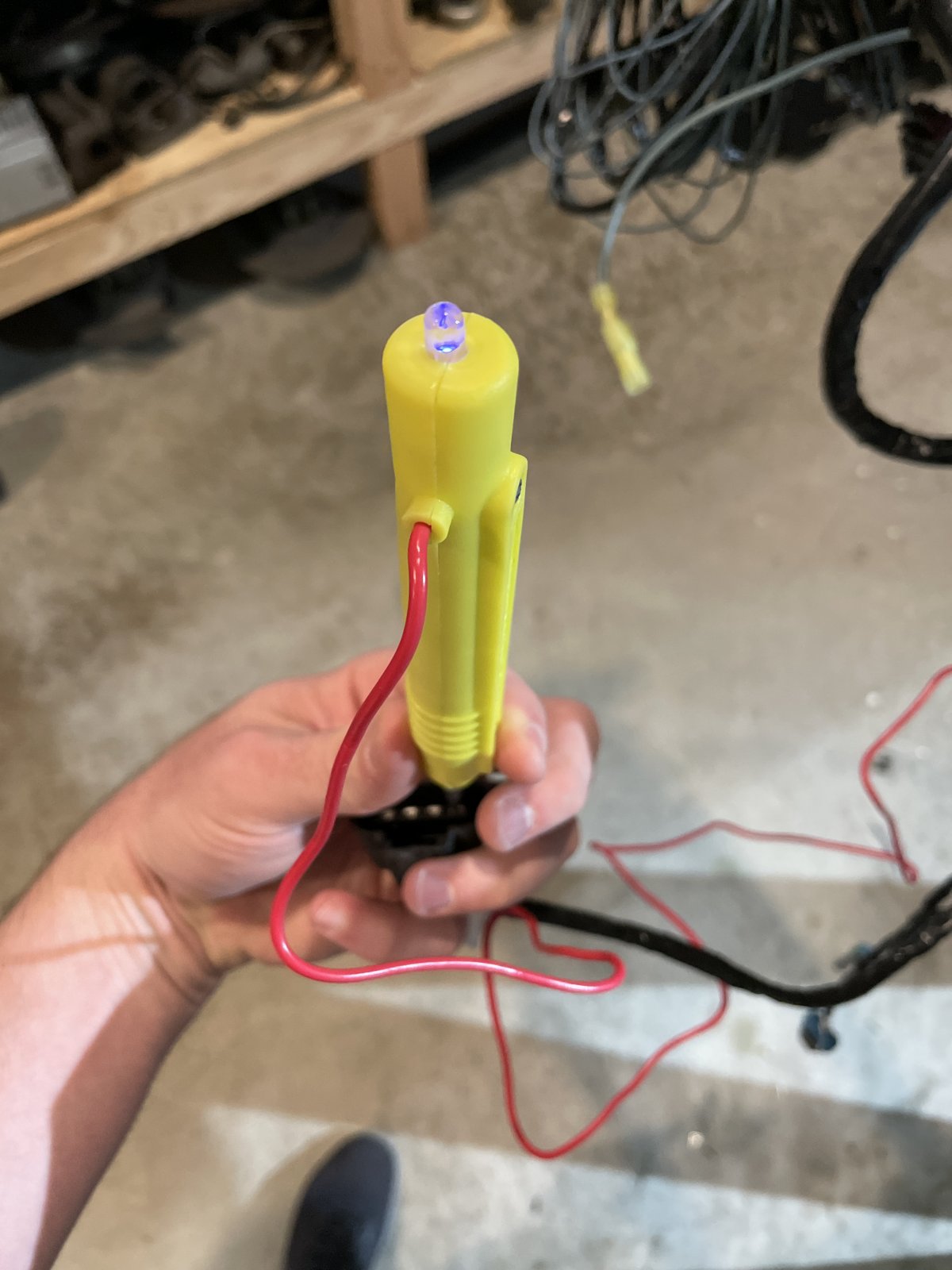

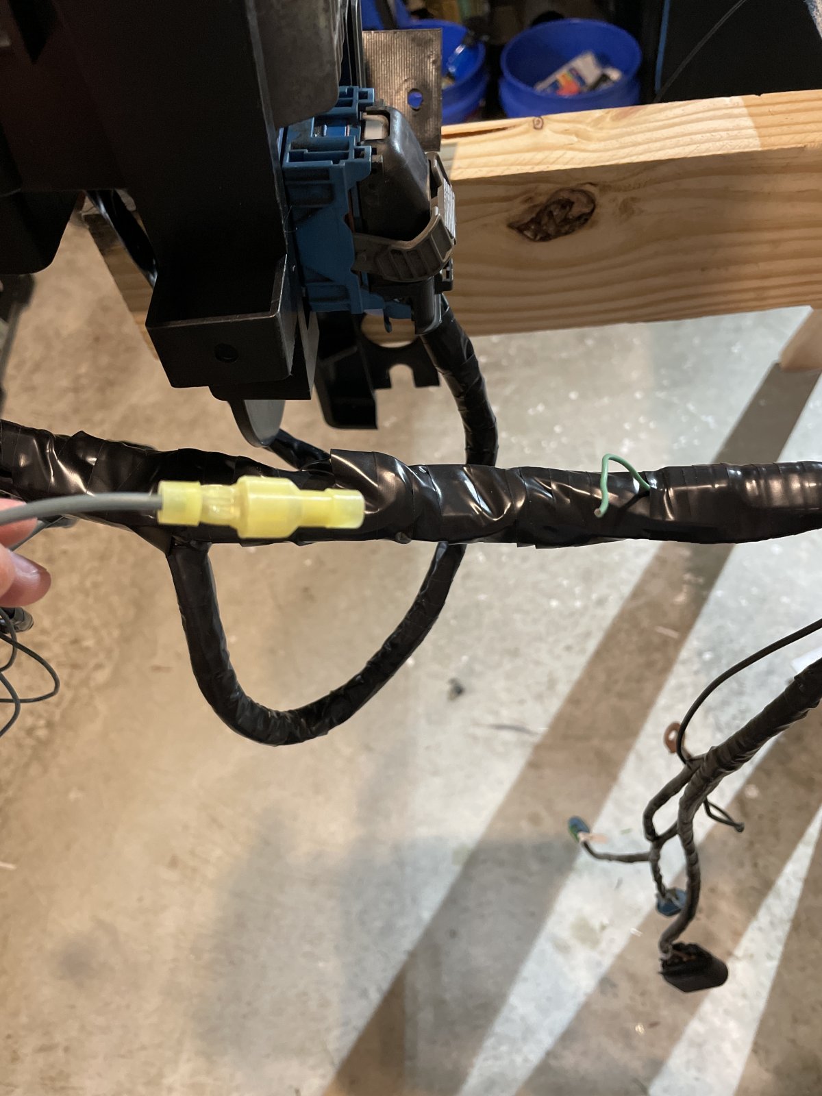

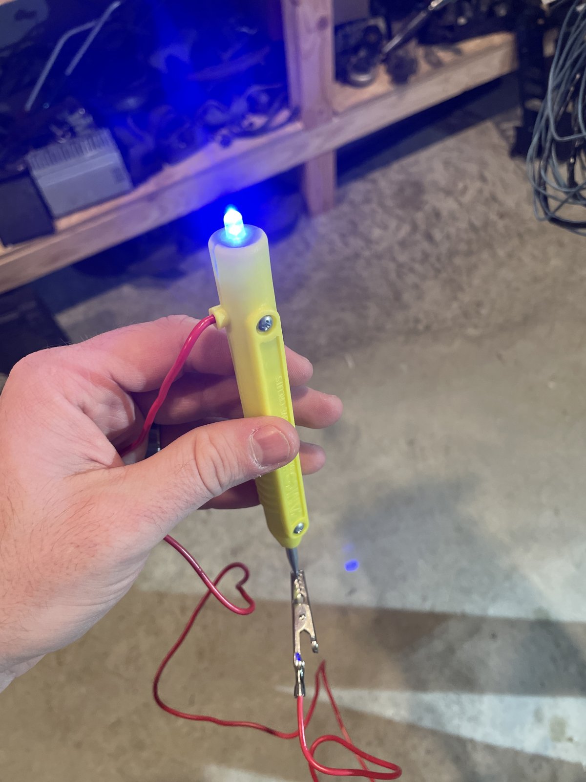

Was about to start video 10 and 11 of the wire harness and watched them ahead of time (about 4-5 times) to make sure I didn’t miss anything. Well I didn’t see this wire mentioned at all that’s sticking out of my harness. Don’t want to rip off the tape to trace it, but I will if no one knows what it’s for. I re watched some of the earlier videos and didn’t see it mentioned so now I’m curious why I did what I did. I connected a continuity tester to it and I get a dim light on several connections either at the fuse box, ecu multiplug or the fuel pump/ coolant tank plugs hanging off the side. It’s not brightly lit like when I touch the tip to the alligator clip so I’m thinking I may have a short somewhere, or there’s a chain of connections throughout the harness that it’s following.
The first pic is at the fuse box end of the harness, right? The wire looks like light green but maybe it's light blue. If it's light blue, it's to power your main radiator fan.
