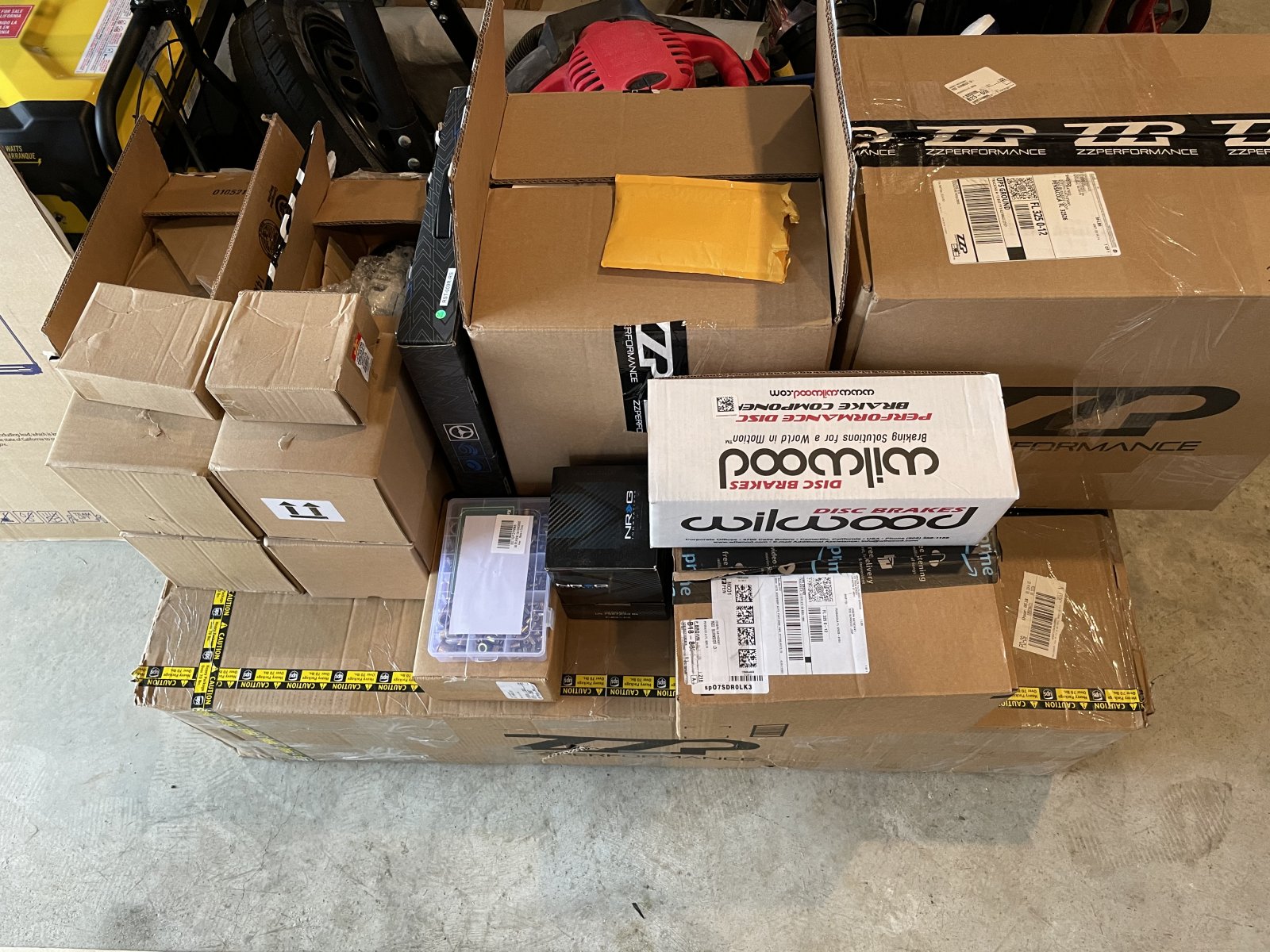

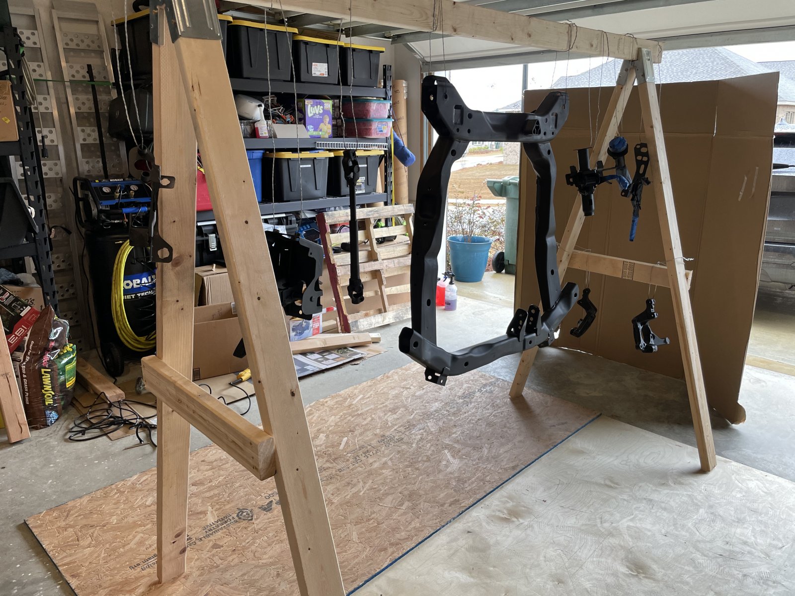

ZZP shipped the order and said to email the file when I can. Everything arrived today. Also got my new front and rear hubs from Autoshack and new tie rod ends. Got all of the donor parts I will be using cleaned up, hung up and painted today. Made a lot of progress today and feeling ready, once again, for the kit to get here. Still waiting on my seats and harnesses to arrive, as well as my GT Wing which should be here end of March. Put everything into a nice pile in the garage. Had to pull out the Z57 and admire it

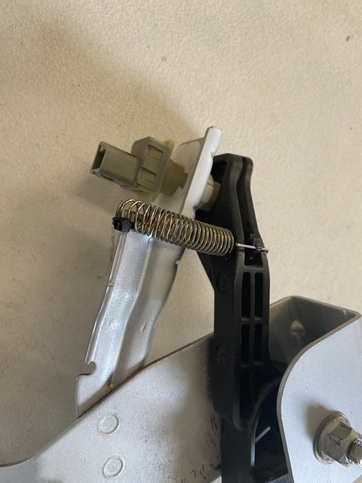

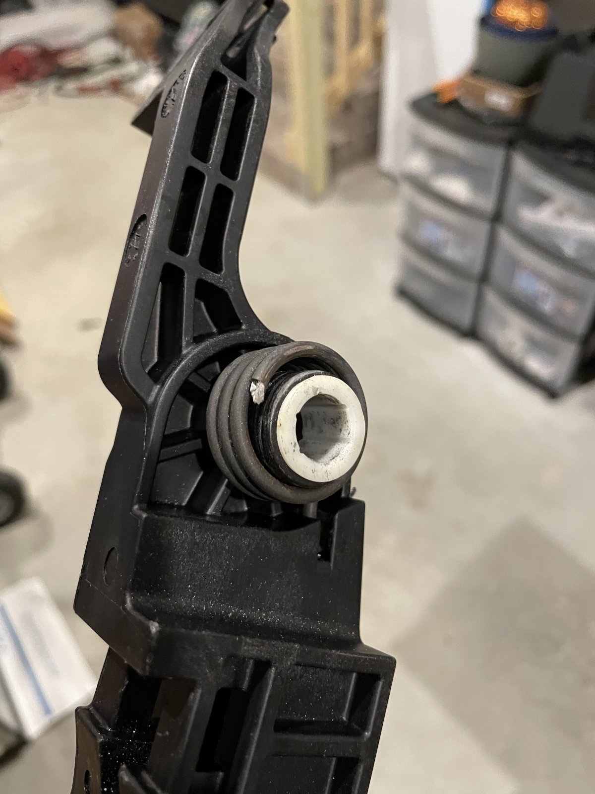

Was reassembling my clutch pedal assembly and thought that the pedal was loose as it didn’t stay depressed on the upper switch. Looked at the spring that’s on the pedal and it looks like the spring is broke. I don’t remember it having the loop to the front to keep the pedal forward, but that’s what I’m seeing when looking at pictures of the ion clutch pedal from ZZP. Can anyone confirm if their spring looks like mine? If it is broke, anyone know where to get just the spring instead of a $100 new pedal assembly?

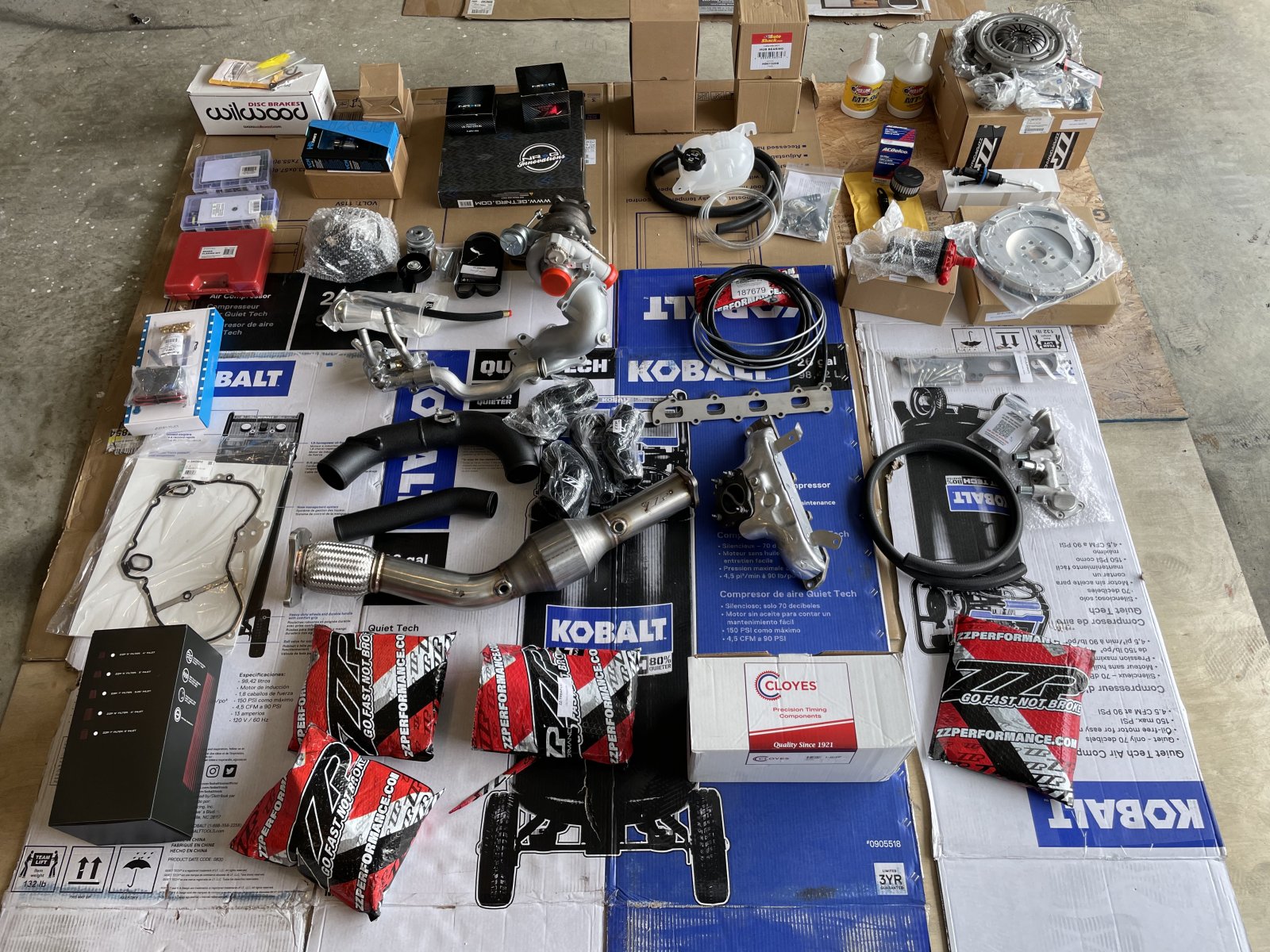

Decided to layout all of the parts I’ve purchased for the goblin thus far and to inventory the packages I’ve got from ZZP. Good thing I did because ZZP forgot to send the injectors and injector harness with the turbo kit, but thought I’d share the picture of the parts. It impressed even me seeing it all laid out.

That spring is made of unobtainium. The same happened to mine. I drilled a few holes and added an old carburetor throttle return spring. Works like a charm.
That is an impressive pile of shiny new parts! Now you just have to get to work and put them all together. :D
I’m finding this statement to be 100% true. Clutch pedal part number is 15274044 but has been discontinued (obviously) so literally NO ONE has one anymore. HOWEVER!!! 15274047 is the clutch pedal assembly for the 03-07 ion redline and looks the exact same... but everyone that stocks it wants $175+ for the assembly. I think I’m going to follow suite and find a strong return spring for something and make it work.
Although, I have been tossing the idea of a second LSJ motor to build with the new parts so the goblin isn’t down while I slowly build the motor. If I go this route, I will have a replacement pedal assembly.
I wonder if something like this torsion spring could be used?
R
I’m sure it could be made to work if it had an inner diameter large enough to go around the plastic where the bolt goes through.
Watch ebay for used clutch pedals. They do pop up from time to time.
I have a clutch pedal and bracket from an 08SS that I'm not going to use. Not sure if its the same one as yours though...
Also, there dozens of these things getting parted out in the Facebook groups. Could probably find what you need there.
