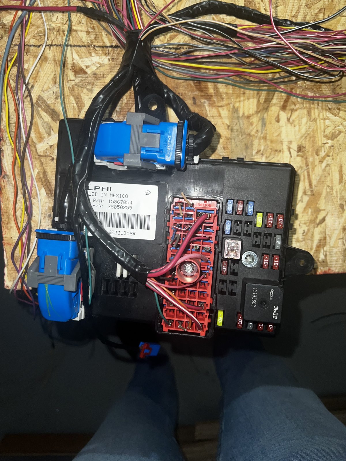

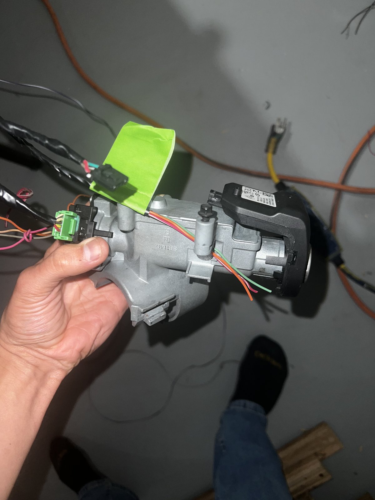

Soldering green low speed data wires together, the video shows 5 and I only have 4. I’m finding post that 1 isn’t used in the LSJ and other posts saying there’s one to NOT cut. I found a post showing P16 on the PCM but I have that wire attached and believe it’s going to the BCM somewhere.
I have my loose green from the cluster, a loose green from the OBD, a loose green from the ignition anti theft and a loose green from the BCM but that is it.
what am I missing?

If I remember correctly I had one less than the videos. Looked everything over a few times and decided to move on. Everything ended up working correctly.

P16 on the PCM goes to my OBDII (C7 on dash to body harness labels). I think that is where my confusion lied while reading through posts of people having issues.
From @Ross post
On my early model Cobalt it has these 4 wires:
- OBD-II port Pin 1
- Instrument cluster Pin 9
- BCM C2 pin 38
- PCM C1 pin 16
This doesn’t show the theft deterrent but I believe I have this.

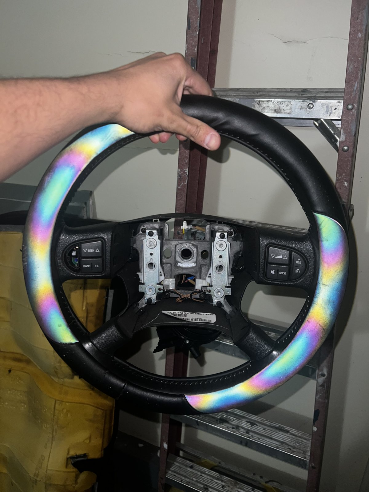

I have 4 remaining. My steering wheel is an early model but I have the theft deterrent so the wiring diagrams are confusing me.
1. Theft deterrent
2. Cluster
3. Remaining wire on OBD
4. Back to too blue connector on BCM (in photo)
Im leaving the harness unwrapped until the car is running but am moving on now to try to finish the rest of the harness.

That makes me feel better. I just went for it, I untaped a decent amount, rewatched videos and stared at the wiring diagrams and I couldn’t find anything I missed or cut off that was needed. I guess we will see later on.
