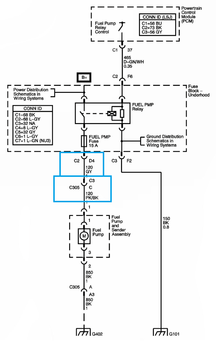

The pink/black one is your fuel pump power, so if you want that "feature" then yes, you need to find it. The other yellow white one is the fuel level sensor, up to you if you want it to work. AllDataDIY will have it.
Traé
Do I even need the purple and tan wires? I’m sorry, electrical is new to me and I’m trying to understand these diagrams. I’ll try to find the others you mentioned and figure out where I cut them off of.
The purple wire for the fog lamps? Not necessary,.. but up to you if you want an accessory wire.
The tan wire? Do you have a link to the video and timestamp that talks about the tan wire?
I found the fuel pump wiring here.
The pink/black wire switches to a grey wire when it gets to the C2 connector on the Fuse Block. It is in D4 on the C2 connector.

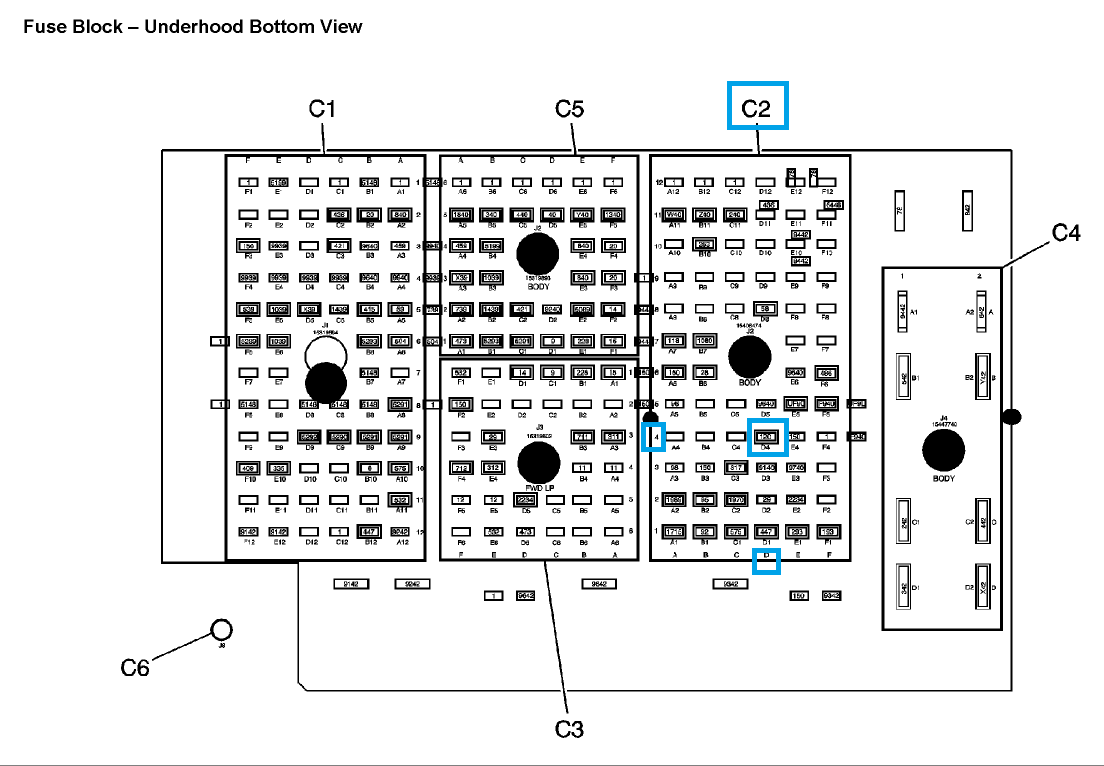

I found C2, D4 here. This should be a grey wire.

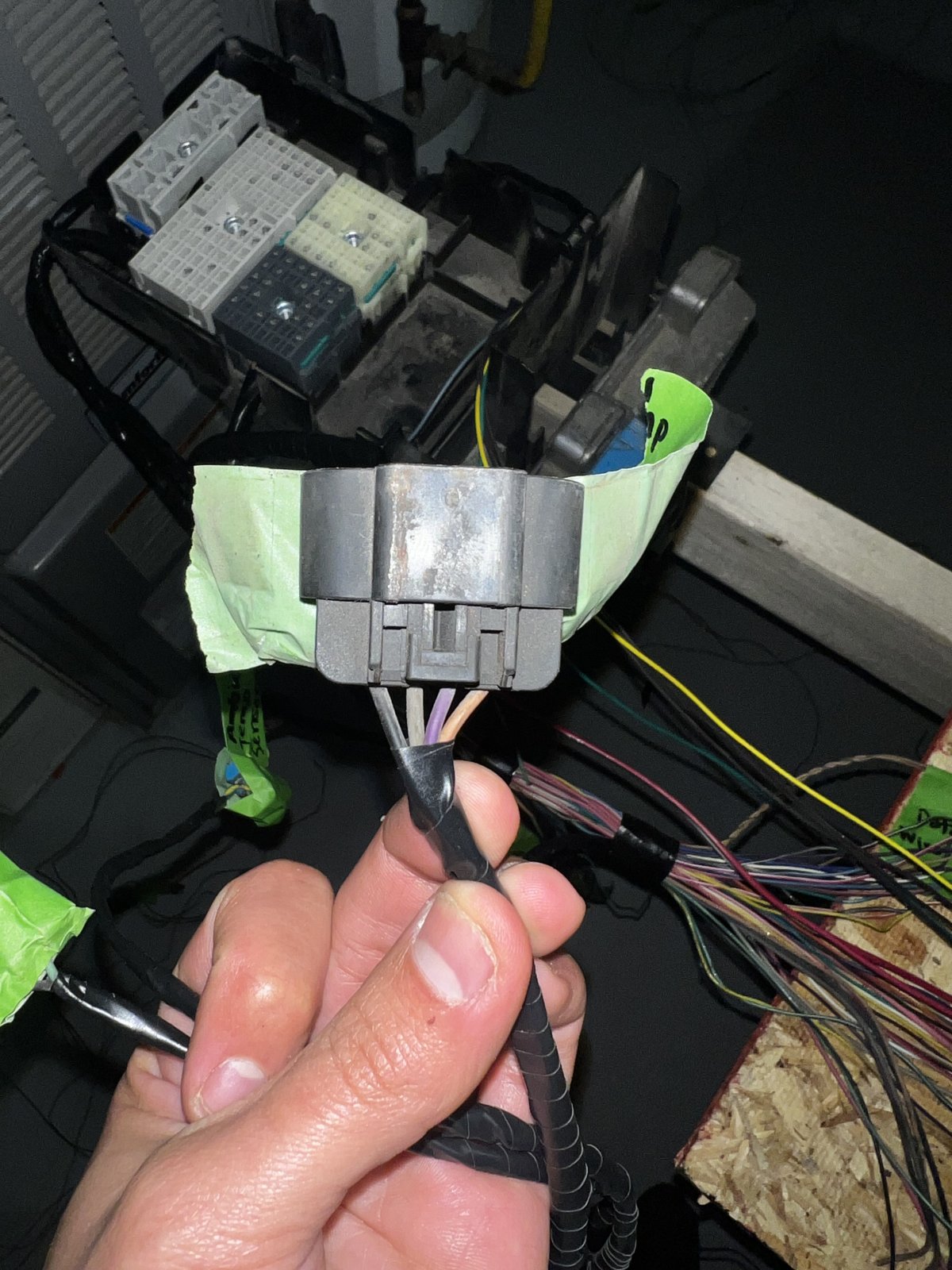

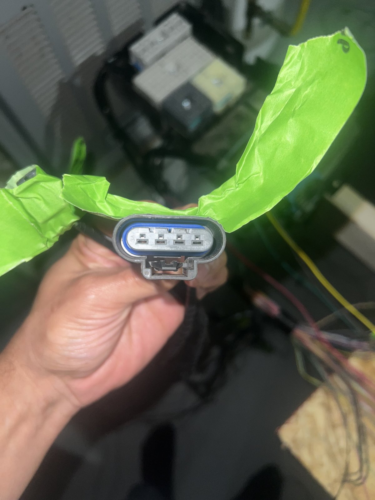

@Ross, working through the videos I got to the section where I prep the fuel pump harness and tape it with the coolant and ambient temp plug. The fuel pump wires are grey, tan and purple like the wires in question. I feel more confident in the wires I have saved from the fuel junction that I questioned.
Thank you for the help and I apologize for any confusion. I will make an Alldatadiy account to view schematics for future use.
I'm not sure what donor car Lonny is working on, but it doesn't have the same wire colors on the fuel pump as my car.
The connector plug doesn't even look the same as my fuel pump.
Does it match your donor?
Maybe Chevy changed some wire colors, or the fuel pump supplier changed the colors. It makes me wonder why my fuel pump wire changes from pink/black to grey. Lonny cut out a grey wire. Maybe my car use to be grey all the way to the fuel pump. I do know the 2005 donors had different fuel pumps, as did the LNF cars.
I had grey w/black stripe, purple, orange (faded to almost pink) and a black wire for my pump. Can you snap a photo of your FP plug? Mine was a 4-plug connector.
Have you setup the fuse box and BCM locations on the wiring table? I can’t remember at what step that happens in the videos. Shortly after you do that, you drape the purple, grey and orange wire by the fuse box.
I did my wiring harness 4 years ago... yes I mounted the fuse box on the wiring table. Can't remember if the BCM got mounted.
So your wires match Lonny's wires. Good.

Picture of Fuel pump connector and wires attached, the plug has grey, tan, purple matching the 3 wires I removed from the junction per the video.

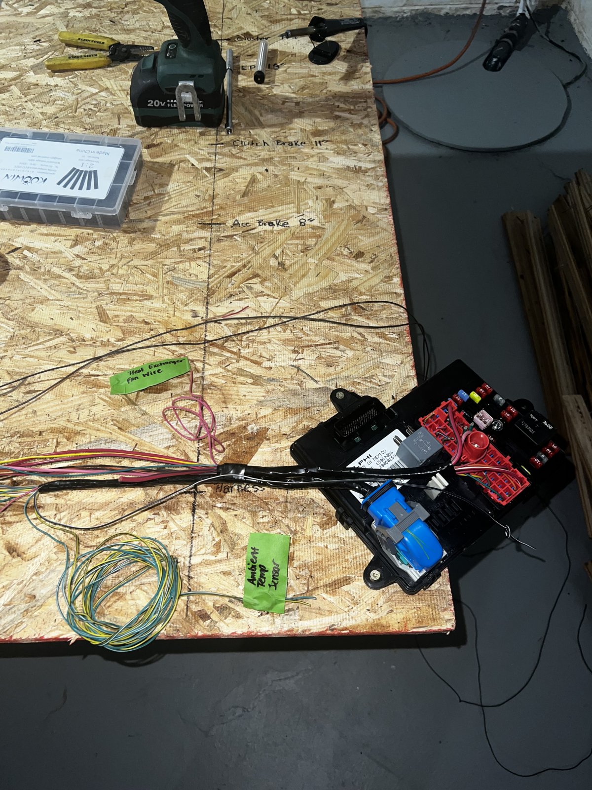

I finished video 5 part 2 this evening. I have the BCM at the harness split point and getting the fuse box put together step by step. Right now the fuel pump wires are just coiled up.

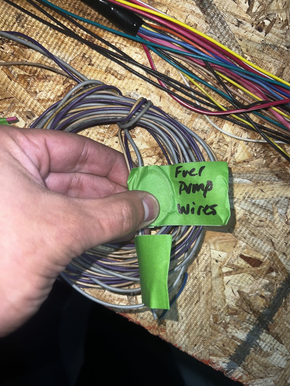

Yeah, keep going. You mate all those back up later on. To be clear, you have a tan, purple and grey wire all coiled together? Or labelled that they go to the pump? The ground gets dealt with when you start making grounding lugs.
Traé
They’re labeled for the fuel pump, it’s the ones pictured. I have them pulled to the fuse box just didn’t drape them like the video. Trying to keep my bearings so I don’t get lost or confused haha

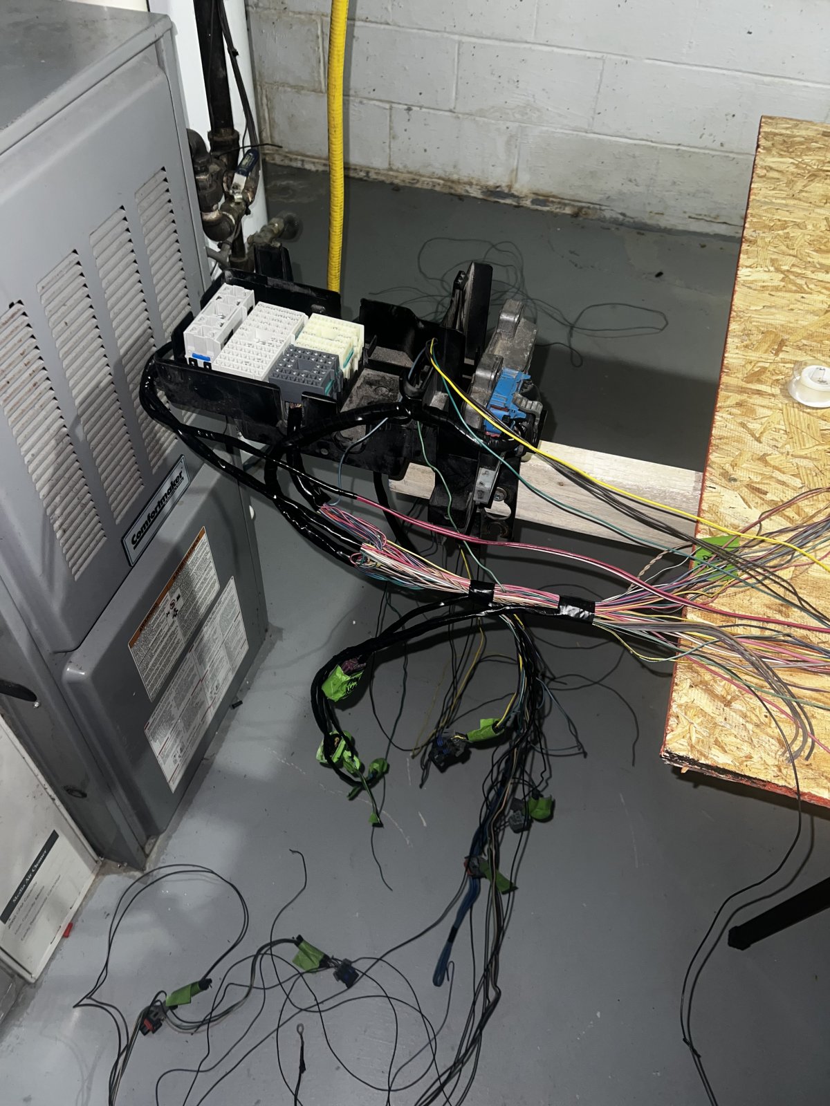

Finished part 8 of the wire harness videos. Dash harness is thinned and ready to incorporate into the main harness. I see the light!! Speaking of light, I noticed my light sensor is MIA, wires are pulled out plug is missing….must be in the trash somewhere. I’m assuming this will not allow my auto lights to function but I’m not terribly concerned. I will have to source a sensor and connector somewhere to get it reattached. Other than that I think it’s going pretty smooth minus the hiccup with the fuel pump wires last weekend. Thank you @Ross & @Robinjo for the info and patience.
