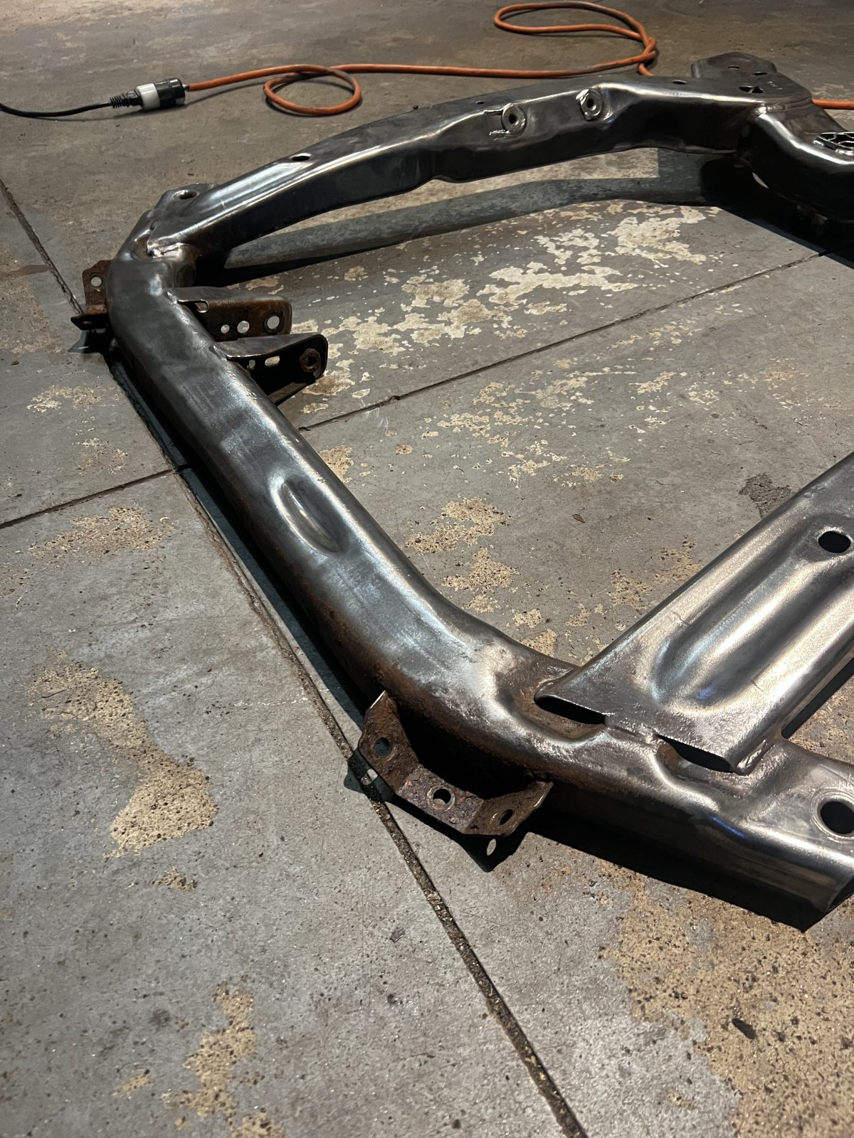

Getting the subframe cleaned off for paint, are the radiator mounts repurposed in the goblin? or can they be removed?

Lonny put the ambient temperature sensor on it... but you could mount it anywhere, so you could just cut them off the subframe, as they aren't used.
Traé
Ahh, perfect. I will look at some pictures and see what side he used. I need to order one as my donor didn’t have it.
ooo thats a great idea, I'm glad I put my grinder away before some of these responses.
You can always lop them off later, or cut them down.

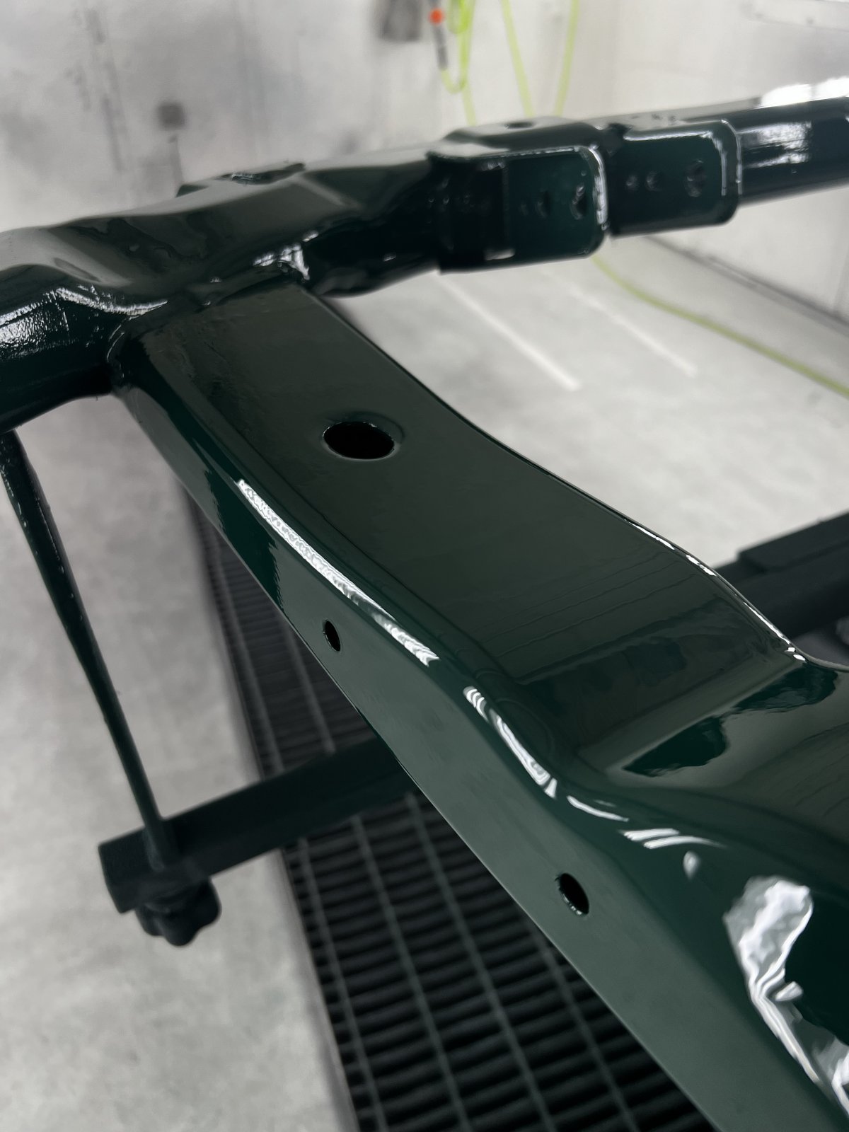

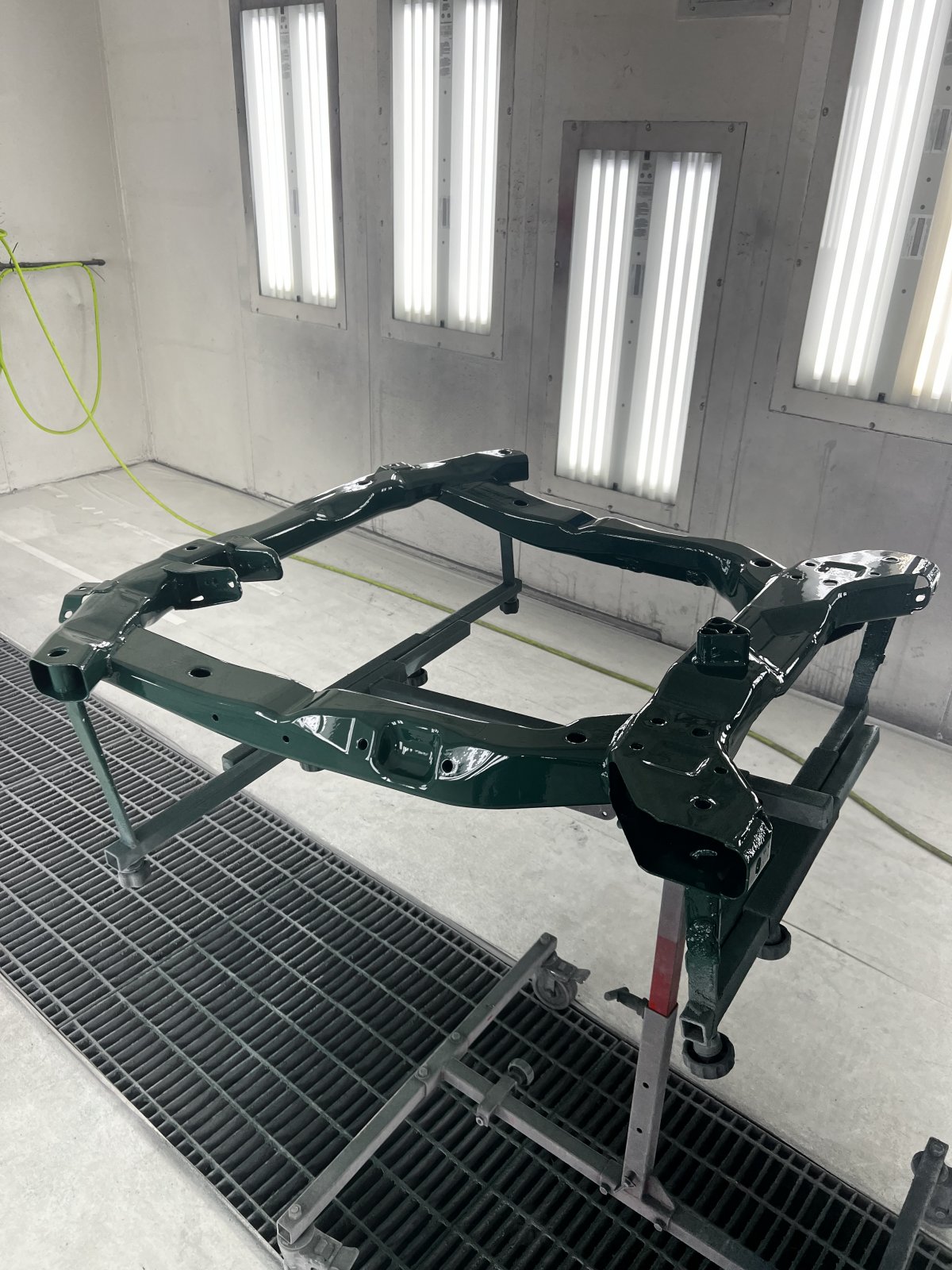

After deciding on a few colors for my frame and body panels, I’ve come to the realization that automotive paint is **** expensive! With wanting to keep budget in mind and not go overboard, I’ve been looking into spray painting the frame or using rustoleum in a spray gun. Using a widely available brand and color would let me touch up as needed and repair spots if i weld on it later.
Color scheme I was going for was a dark green frame, similar color to British racing green, and dark gray body panels. These would of course be topped off with bronze wheels…my favorite:)
I have finished painting some donor parts with rustoleum gloss enamel and I’m very happy with how they turned out.
Any feedback from those who have painted their frame? I’ve seen a few on here that have gone that route.
I know powder coating is the fan favorite and I understand 100%. It may not be as durable but I do not want to pay that much to get the same color I can get for a fraction of the cost. Plus I can do it myself, eliminating someone from helping to shoot for the goal of doing this build on my own (and all of the forums guidance of course haha).

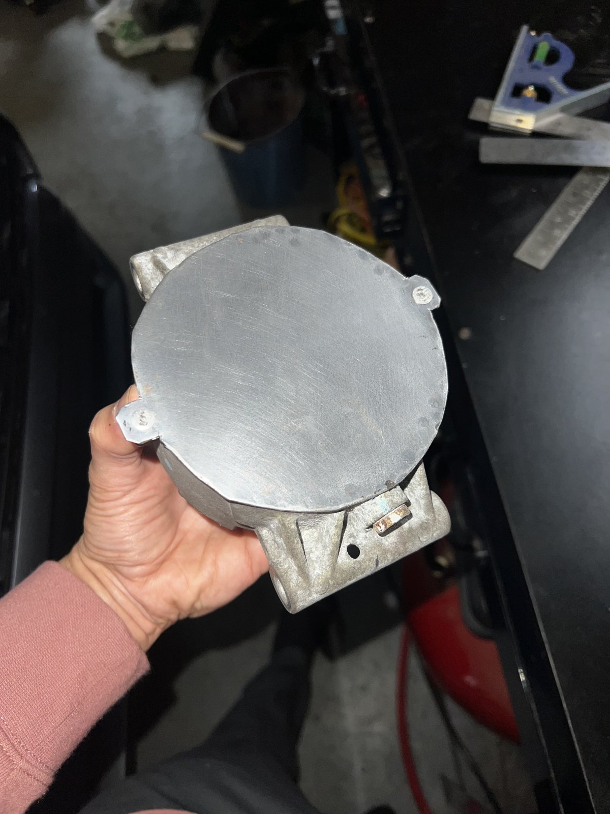

Stayed busy in the garage for almost 12 hours yesterday. Mostly stripping the engine of parts I am going to clean and paint with some kind of aluminum paint (thinking Seymour or Eastwood).

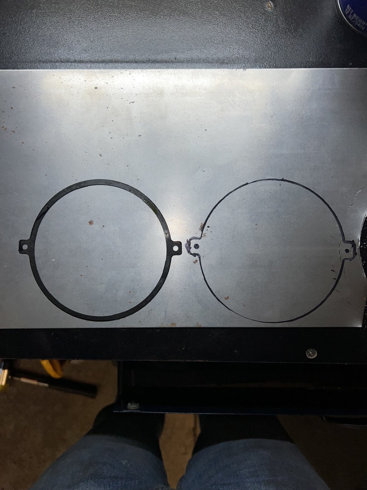

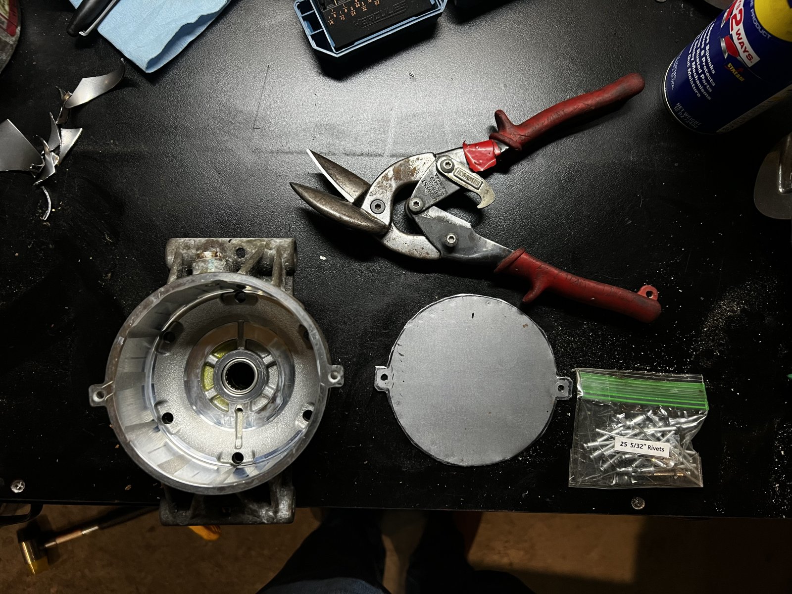

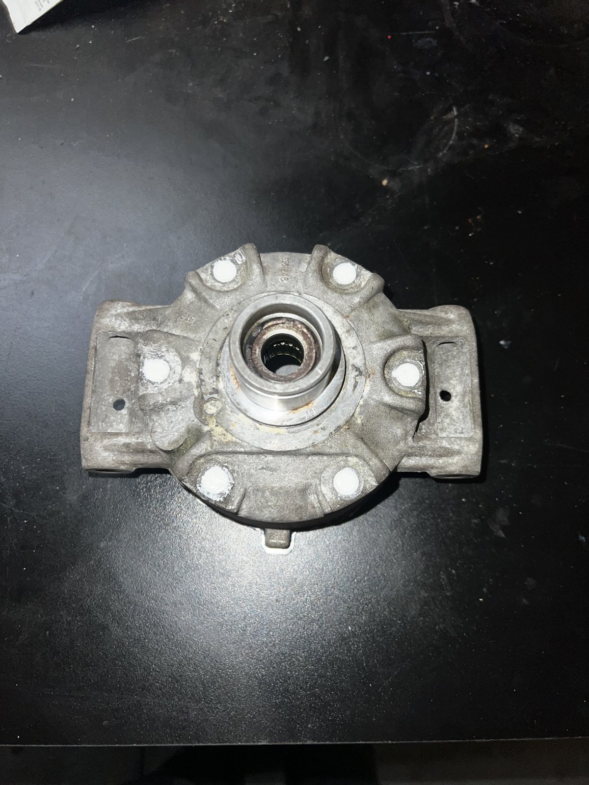

Got the AC compressor broken down and ready. I traced out the thin metal gasket onto a piece of stock metal and used that as a template. Riveted it in place with some gasket maker I had.
I have most of the parts prepped and painted ready to install. Still need to order some things that I will utilize in stage 1.
